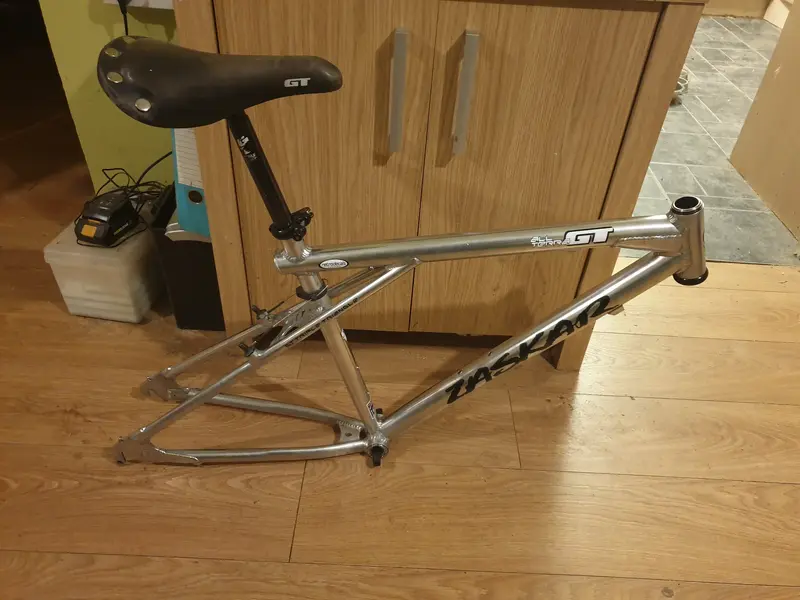

A quick preview of what's to come....1991 GT Zaskar project.

Spent a little time today applying the decals to the frame, With thanks to @Gil for supplying the decals! 😁
Looking a lot better now.
Still waiting for an opportunity to repaint the forks...
The first two attempts weren't great, so hopefully the third time will be better.
