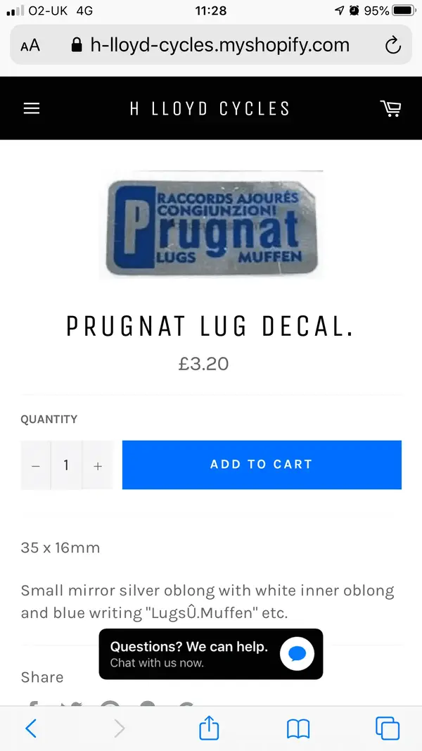

I might be wrong here, but I thought the frame sets used 73degree parallel Prugnat lugs? Have a quick check of the seat/top tube.... if it’s 73, I’d put my shirt on that head tube needing to be 73 as well.
Then you could add the 70’s/80’s Prugnat sticker to your Lloyds basket ;)
