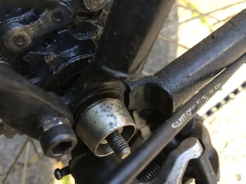

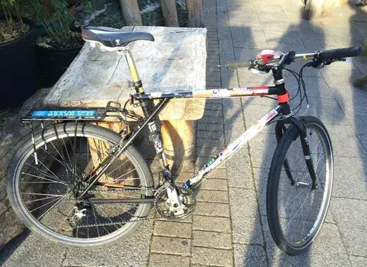

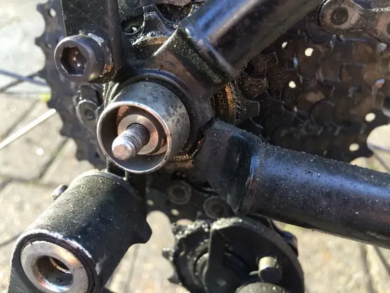

My beloved 98 GT Karakoram is broken!
Today the drive-side chainstay broke at the derailleur end - see photos.
I'm wondering what my options are.

Oh dear :( I'd imagine that being cro-moly steel at the rear it could be repaired, but if it were me, I'd take the money I would have spent repairing it and get something else, something S-Works sounds good :) or whatever takes your fancy.
I worked in a GT dealer at the time these were new.
We had several do this.
The chainstays were under a lot of tension and snapped at the dropouts.
I think they were slightly out of line when welded,which led to the breakages.
Shame as they were a great riding frame.
Should be an easy enough repair though.
