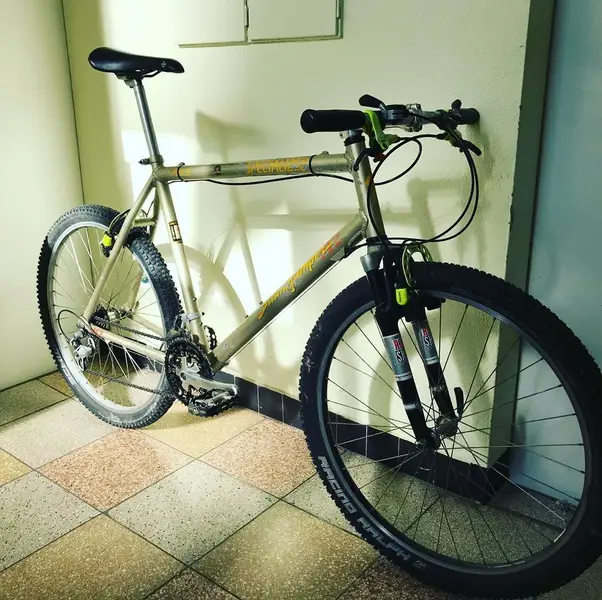

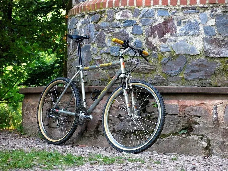

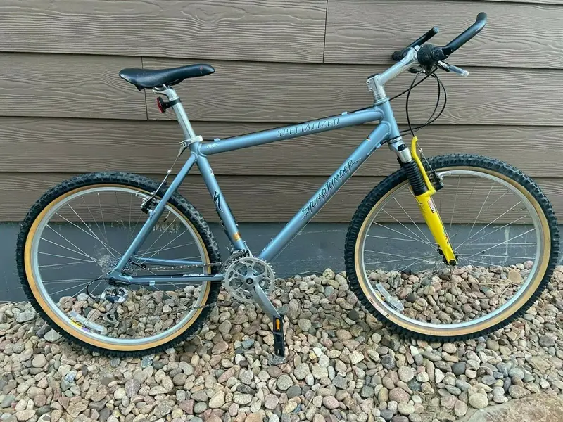

Some cool pics.
Sorry I don’t remember who took most of them, if a pic is yours, let me know in this thread and I’ll edit the post to give credit.
That SS frame was for sale on RB a while ago. Would kill to own it. Maybe the current owner could chime in?

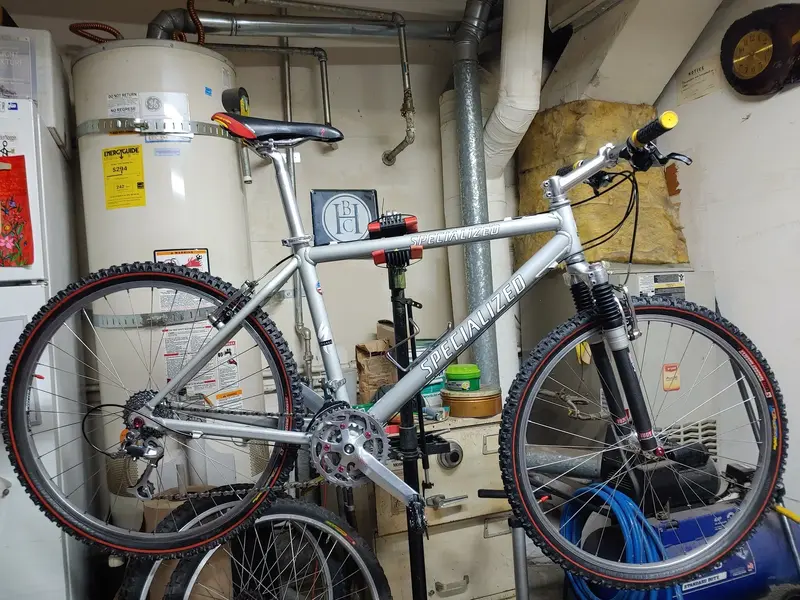

Sorry for the hijack - dunno where to put this ID info… if anyone has a place for it or can show me where/how to share it, I’d appreciate it. This could technically be renamed the M2 Master Thread…
Post some pics up Proto…

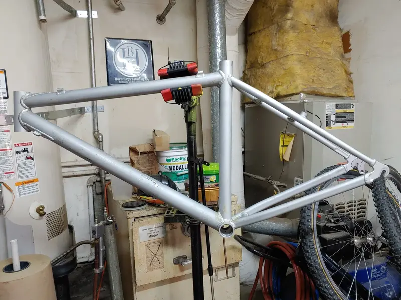

He got the gold stuff (UV exposed top coat likely) off the frame… looks stunning. He’s gonna do a gloss clear coat rather than the original matte, to make the silver anodizing stand out more. Drool-worthy - but without any bright colored goodies, making the most out of plain old silver. Will likely be an unassuming build - grayscale doesn’t grab attention like 3DV or turquoise, but the color is what makes the bike so unique. And I bet it’ll be under 25lbs complete… (Sorry, all measurements in Freedom Units.)
Love this project so much. I had barely any resources to get it built myself, but now that it’s with someone who can get it done and has me as the ultimate consultant, my vision for the bike will finally become a reality!
- Cat-who-breaks-anything-he-gets-his-dirty-paws-on
Ok, first go at removal of top coat. Went really well and the "environmentally safe" stripper ( I love those ones) took off the stickers too. Had to reapply stripper many times. Pic is first try. I do have the frame down to bare anodize now and it is glimmering. Post some pics of complete strip tomorrow when I recoup.

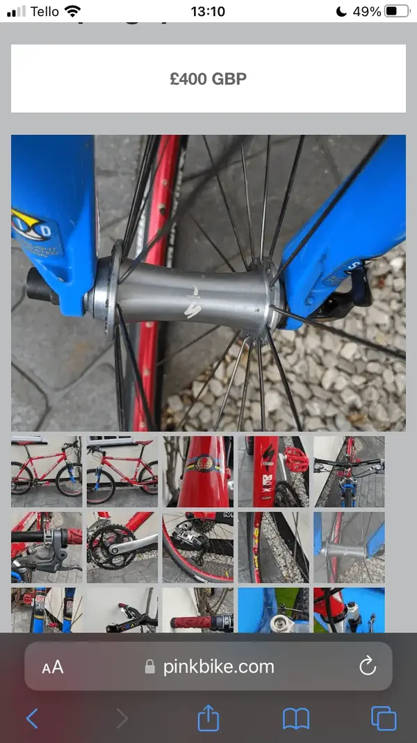

Now for the real question— Does anyone have a front??? Do they even exist in that color? Never seen one, but they have to exist, right?
Nvm. they do…
Someone was selling a wheelset here in 2014 ish where the front had it but it cracked at the flange and was replaced with a regular Stout Skraxle hub by Spec. Won’t send those pics. Search and ye shall find it.
I will, however, send one pic from an old PB listing from the UK. If this was your bike, reply to me and I’ll give credit if needed. This one doesn’t have the original Skraxle.
If anyone has this exact hub or a front wheel with it and is willing to part with it, PM the OP. Looks like they came laced to red Mavics on 1999-00 S-Works bikes. F8565481-8BA2-41B6-ACA4-5AC50F68B981.png
