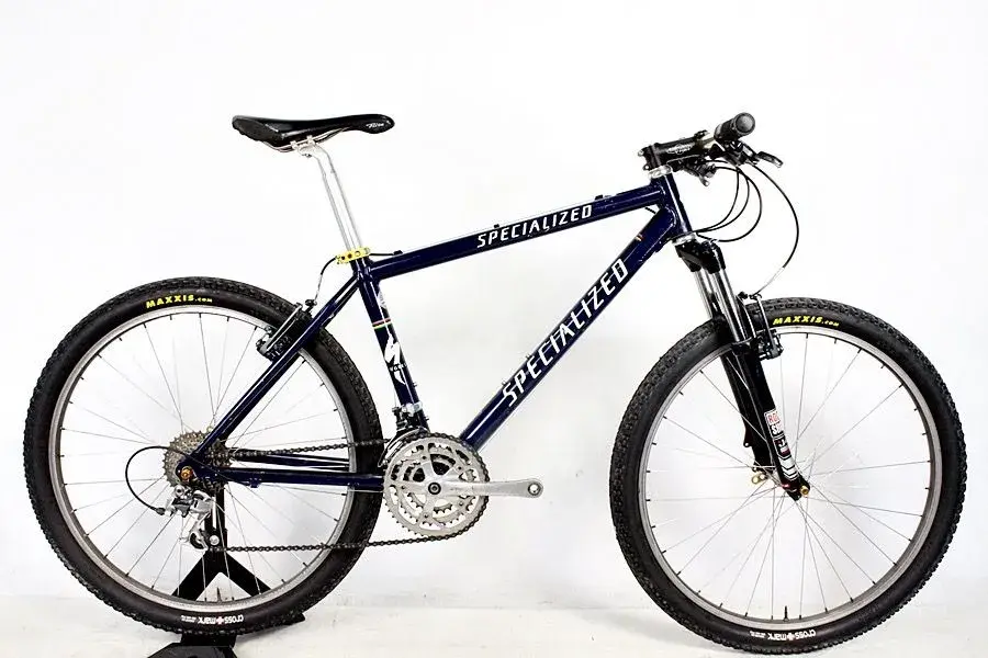

I was the owner of this rare beast before the OP and I firmly believe it is a late 1996 and not a 1997. I’m a big M2 nerd, so here’s how I tell them apart:
95-mid 96, late 96 and 97-98 all have unique dropouts.
95-mid 96 had flat dropouts with sharp edges, and no fancy bi-conical bridge. Therefore it’s not a 95 or 96 Team, nor the white 96 Ned Olympic bike.
By early 97, the new colors were out, and the dropouts changed, now featuring an S engraving and threaded holes for rack mounts. Late 96 dropouts were rounded around the edges like the 97 ones but had no hole or S logo. Mid-year in 97 they added side plates to the lower head tube gusset. Brake boss fixture shape also matches a late 96, in 97 it got thinner and more square shaped.
What closest matches this bike is the pic I have attached, shamelessly saved from some for sale site a while ago. My educated and best guess is that it is a crossover year, late 1996 S-Works M2 that is NOT a Team, with custom silver anodizing (likely a one-off) and the latest frame reworks. SN starts with a 96 S. Haven’t seen any 97 M2 frames with a 96 SN before, although my 91 M2 does have a 90 SN. This specific frame had no Olympic branding from the factory unlike the attached pic. Decals are otherwise identical. Frame also came with the original silver Nitto seatpost and bulky laser-etched S logo silver seat collar, that was found on some Team frames. Further justifying this as a 1996. Frame weight was 3.3lb from a rough weight check, that’s crazy light.. Got it as part of a trade, got rid of it as part of a trade. Can’t wait to see it restored.
