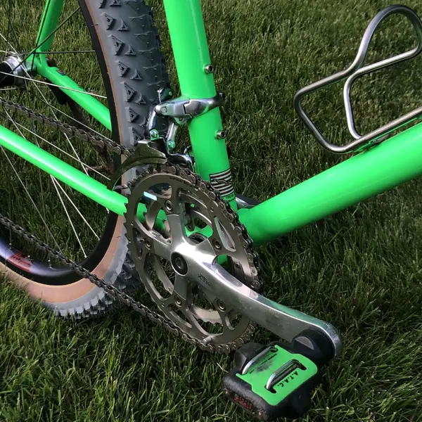

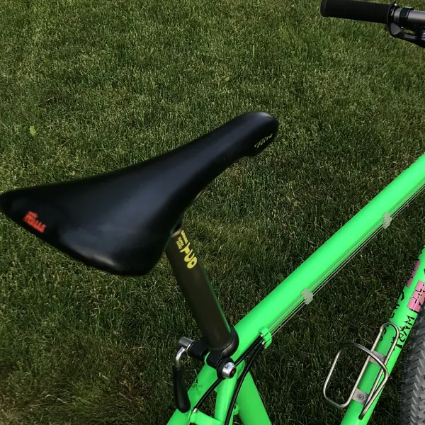

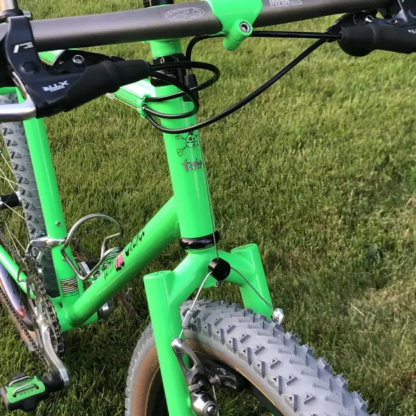

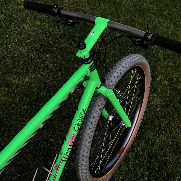

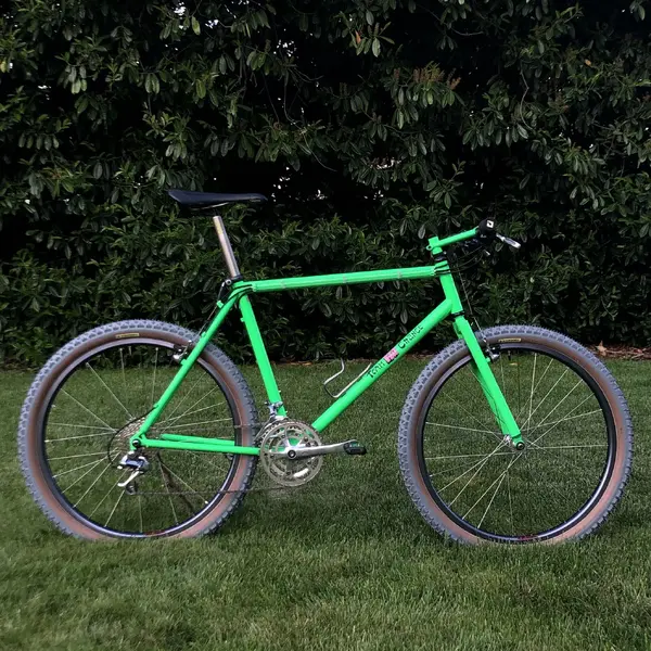

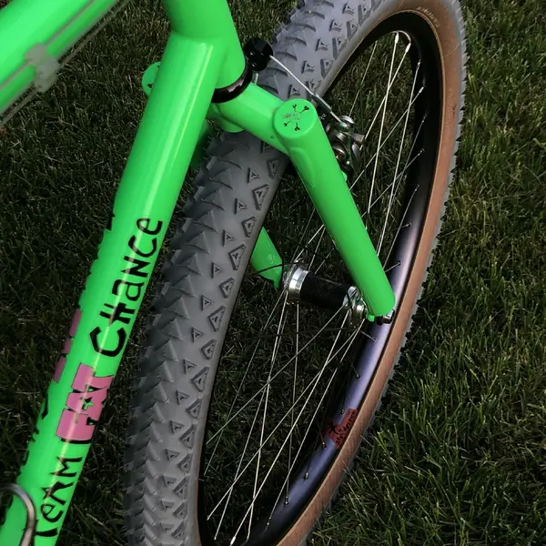

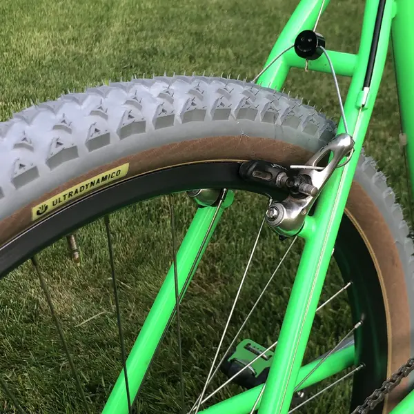

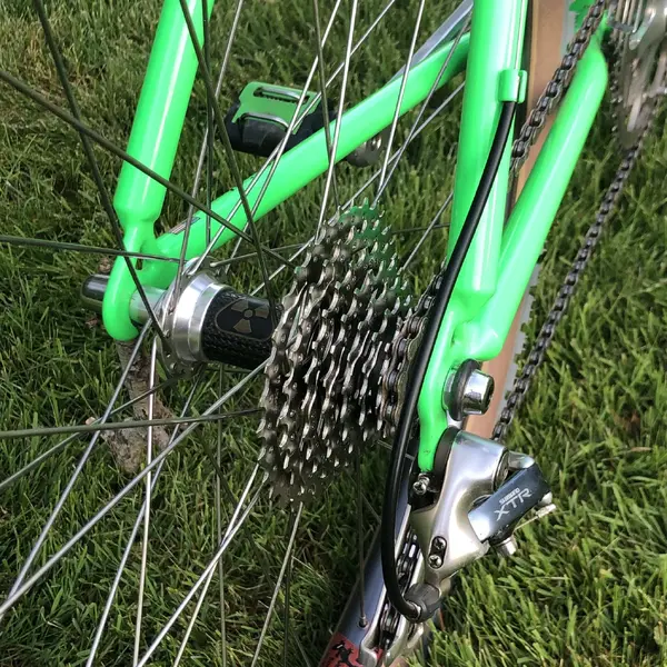

Just finished the build of my yo Eddy. Been riding it for a few weeks but finally got the wheels back from being laced up. Tried to keep it visually correct but with some modern tubeless rims and tires for durability and ease. I'm not sure of year since the serial number can't really be read. Has 1" steerer and painted to match stem of which brand I cannot figure out. I absolutely love the way this thing rides!
- Shimano M900 XTR cranks, shifters, derailleurs, bottom bracket and brakes
- Answer Hyperlite Bars
- Chris King 1” headset
- Ultra Dynamico Mars Race tires on Sim Works Standalone rims laced to Nuke Proof carbon body hubs
- Flite Titanium Saddle
- Sakae TCO Seat Post
- Time Atac Pedals
- Magic Components Dango Bros cable straddles

It´s earlier than a 93: it has the older yo eddy fork. A 93 would be susp corrected w/ the BOI fork.
Very interesting stem you ve got there. The TCO post was the choice in 1990/91 Yo Eddys.
I also ride tubeless on my fat wicked since it´s cactus everywhere here. Would love to try a Yo.
Btw: nice to see a Fat Chance built to ride.
Thanks for the info! I'll update to a 92 for now and maybe one day figure out what year it is haha. I got the frame/fork/stem/seatpost together and saw the TCO on a lot of builds as well as being one of the few 29.4mm seat posts around so went with it! Good to know more of the timeframe from that post. I guess the XTR group is a little later but this wasn't built to be period correct as much as to be what I wanted to ride.

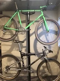

Next up is sorting out the 95 Fat Chance Shock-A-Billy. Going to go for lots of polished bits on this one, including polishing the Amp B2 rear end.
