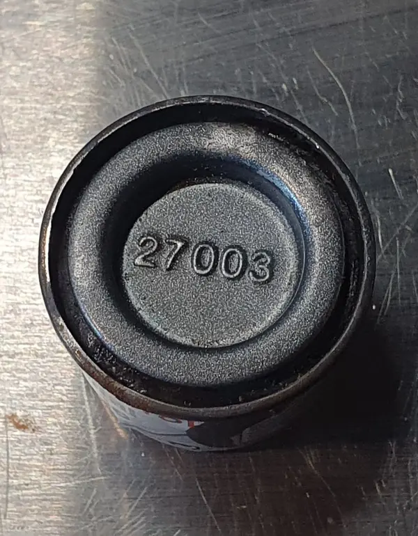

With regard to the seatpost, I just disassembled it, cleaned each component. Replaced the very rusty machine head bolt with a stainless replacement touched up the scratches with the Humbrol below which is the closest colour match I can find...it's not perfect but a damn site better than before. 20230326_210633.webp
