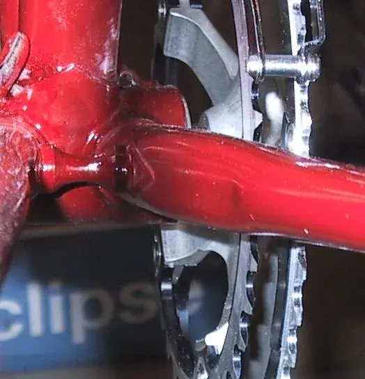

Uh oh, 531 SL chainstays have a poor track record for durability even when not cold-set wider.
The first batch of 531SL stays were particularly bad, those are the ones where the tire clearance is a sort of flattened area on each stay, the ends at a sharp-ish transition. A lot of those broke, right at that sharp transition.
Later 531 SL c-stays came with the more copacetic Round-Oval-Round shape, and were more reliable.
Tha bad shape is hard to show in pictures, but here are a few I've found:
Not all of them broke! I wish a long life of many happy miles for you and your bike.🤞 fingers crossed
Is the same true of 531 Professional tubing or had problem been solved by then?
I think it's a risk with a high quality tube, the stress-riser at the Chainstay bridge, coupled with a little too much heat when the joint is brazed.
Maybe later they left a little more wall thickness at this point?
I've seen quite a few quality steel frames snap clean through at the butt🙄
