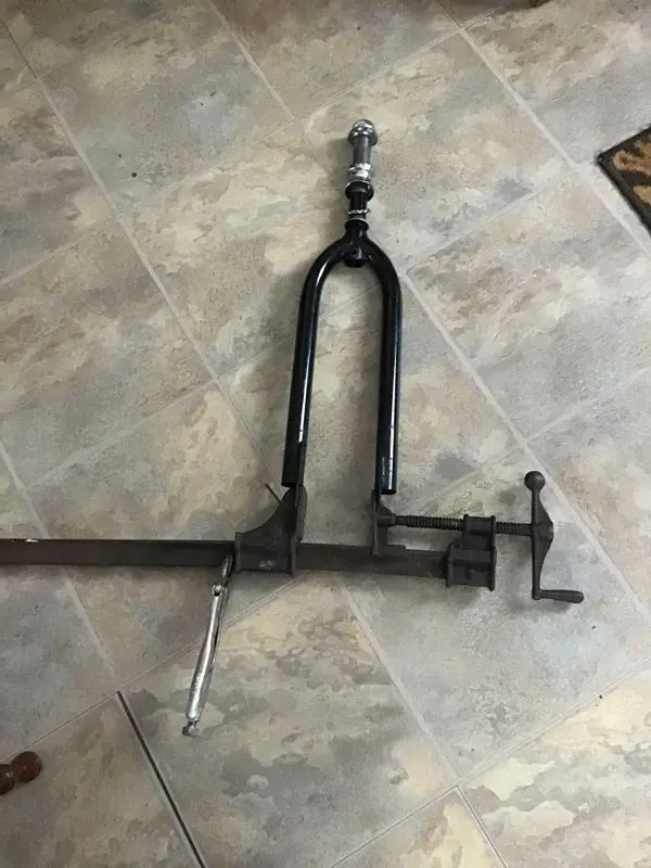

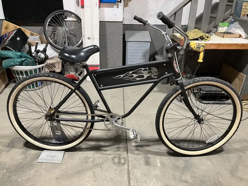

That front fork is a solid stamped steel unit and it wont track well on tight trails. It’s also got 96mm spacing. I sometimes replace these forks with cruiser forks. They have held up so far, though I’m still a little wary of them. I don’t jump them but I slowly ride rock gardens with them. They track much better and if you buy a new one with one inch steerer you won’t have to spread it like I’ve done here. IMG_2935.jpeg

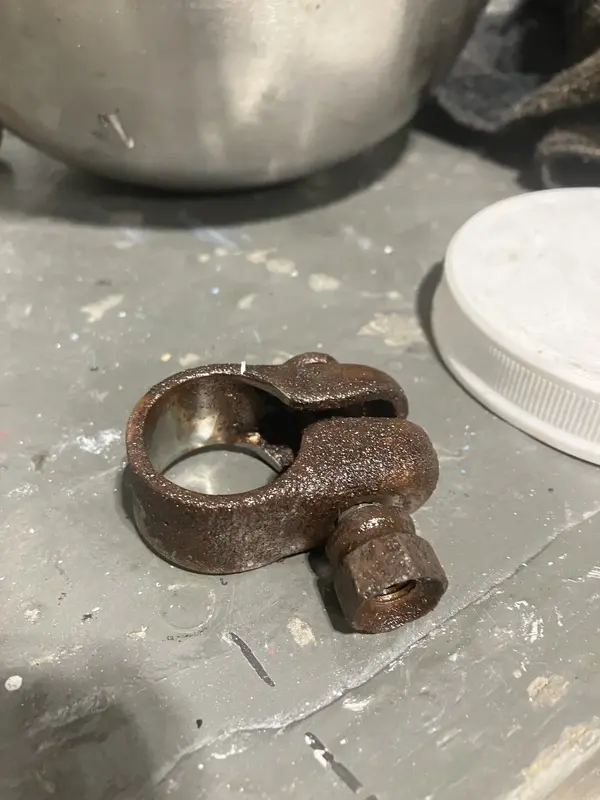

Lot of pitting on the seat clamp. 60% perfect but the other 40 not so much. Always amazed at how these old parts covered in rust can be brought back to life with a good scrub.

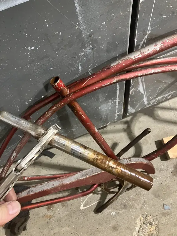

Not sure what direction I’ll gonna but this def gonna be black and chrome. The kick stand was cut and I’m not sure how I’ll get the stump out of the holder. Maybe I can drill the retaining pin out? Any advice would be appreciated.

Those pins can be tough to get out. Use liberal amounts of penetrating oil to loosen up the rusty spring and pin. Sometimes you can’t grab the pin as all that remains is a rusted nub. Tapping with a hammer can help the penetrant work. Use the video Matti posted along with what I do. I once cut the tube and kick stand off from the frame and welded on a cross brace cut off of another frame.
