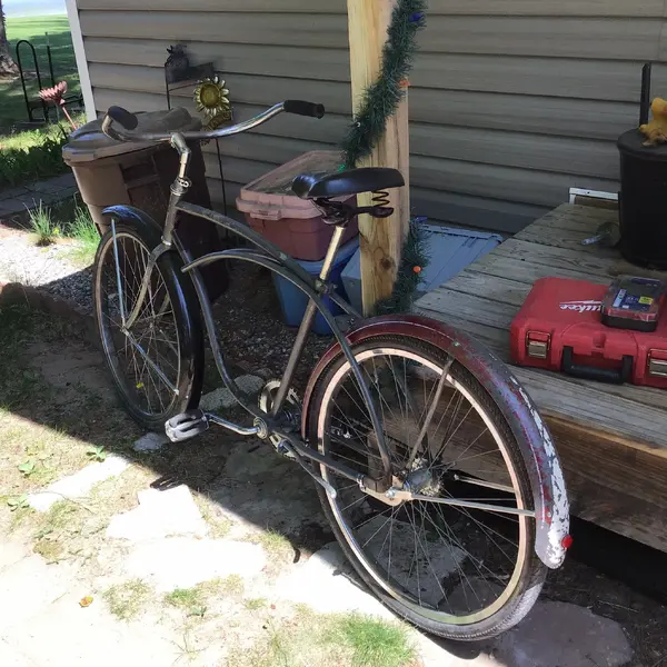

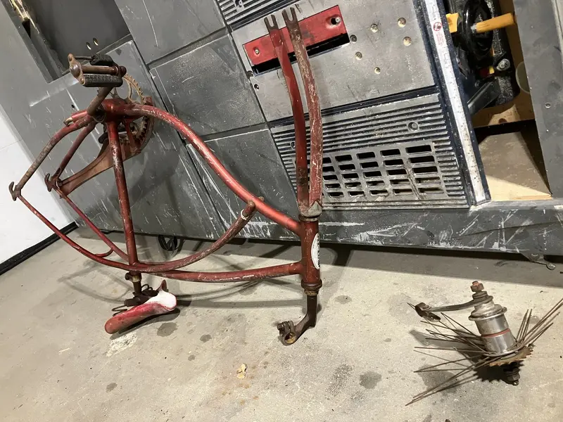

So it’s been a while with me kinda waiting for a deal to come through. Today was the day. The 24” frame is gone to a new home and in return I took possession of this 1965? Scwinn. Little bit of a start over but nonetheless here we go again.

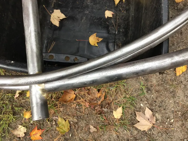

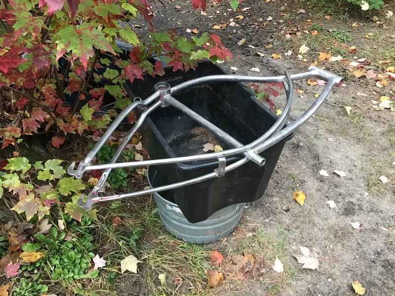

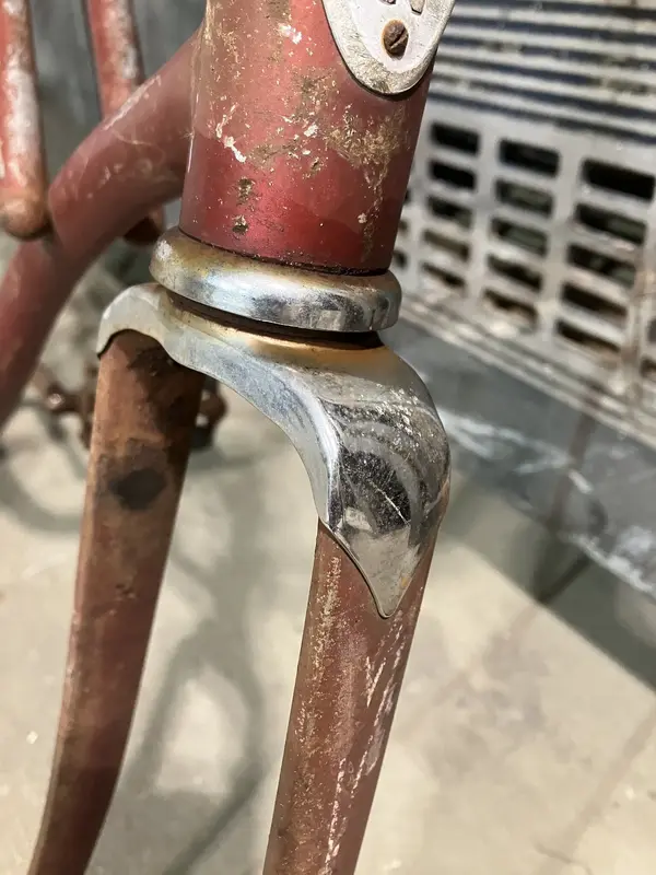

I’m working on its brother. I got most of the paint off today. Yours is after 1960 because of the chrome trim on the fork crown. Mine is a 1955, but the frames are the same.

Mine was in about the same condition as yours. It’s amazing how much shallow pitting there is, even under where there was still paint. IMG_4218.jpeg

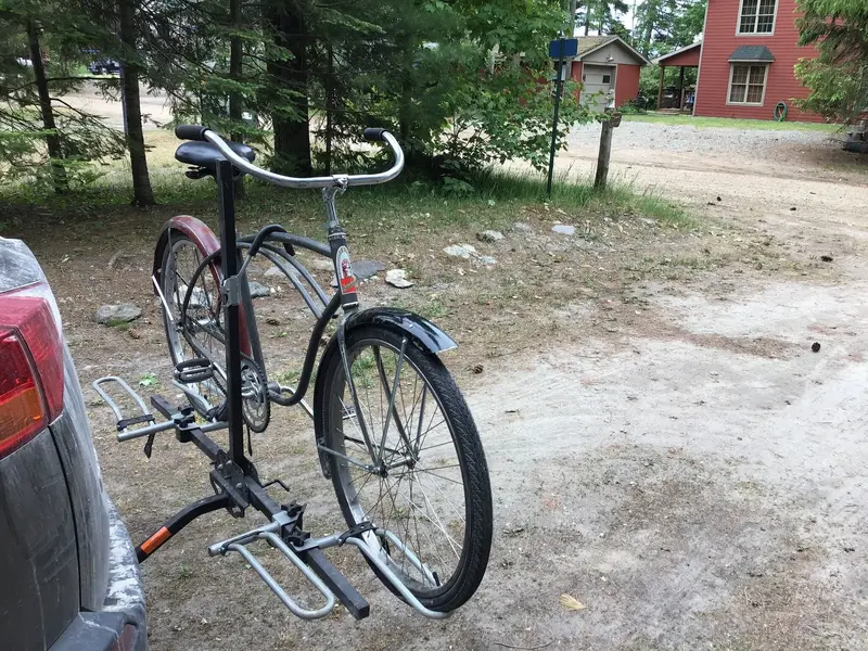

I’m giving it to Imlach on this forum. I had an identical one and I also gave that away. I have 34 bikes and parts to make another 10 or so. No storage for mor so if I find a frame or junker for $25-30 i buy it and fix it up and give it away.These are too new for my taste, but they are fun. I also gave this one away this summer. I can recall 9 similar ones that I also gave away after rebuilding them. IMG_3870.jpeg 70715651173__7B065972-C994-4FC7-A20F-53EBCC82E2F2.jpeg

Wheelset was shot. The Bendix rear hub will be saved and rebuilt. Not much time to get at this one yet as I’ve got 3 other builds on the go🤷‍♂️. Can someone tell me if the chrome shoulder cap on the is removable?

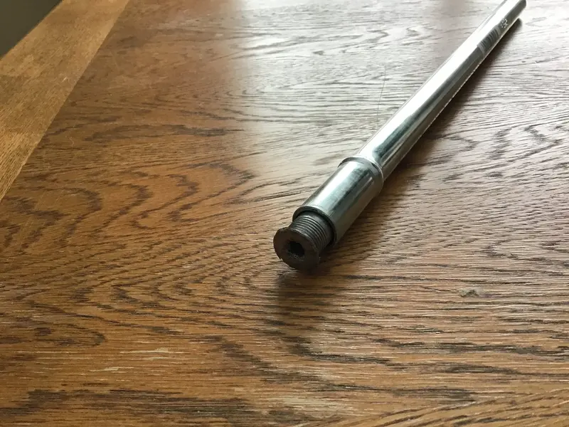

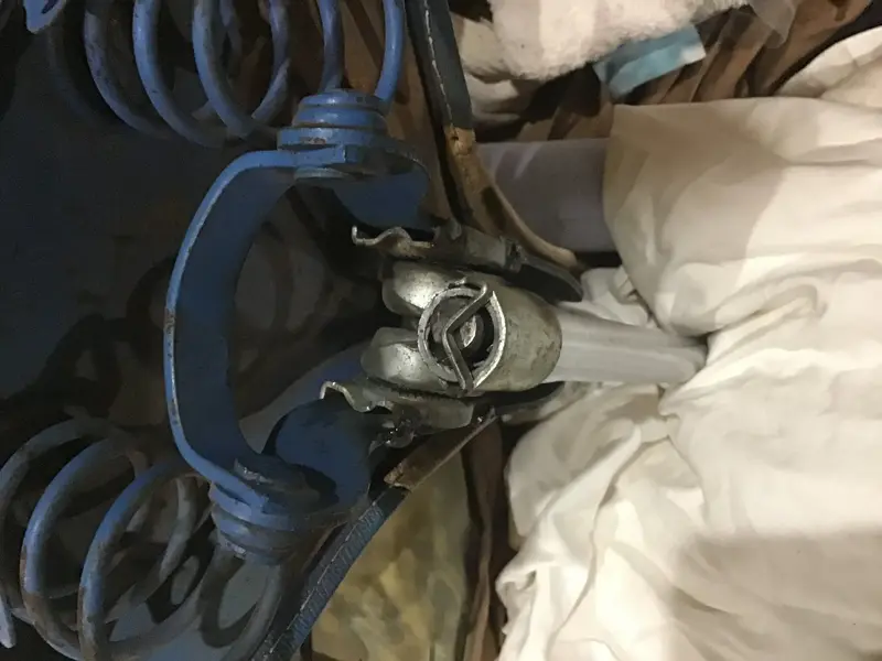

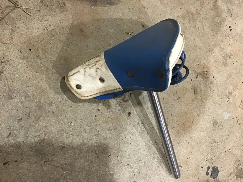

If you need a longer seat post most of the ones that are available are thin walled and easily bend. There is one type that is thicker but I don’t trust that one either. I file a gas pipe smooth, slather it with a lubricant of JB Weld and hammer it inside the post. It won’t bend. IMG_3875.jpeg IMG_3876.jpeg
For the thicker one I insert a section of cut off stay, glue that in and while the glue is still not hardened I hammer in a piece of re rod that has been covered with glue. IMG_4219.jpeg IMG_4225.jpeg IMG_4226.jpeg
These posts will hold up to heavy klunking.
