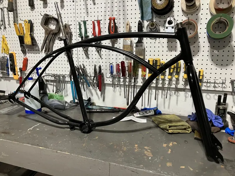

Well a rough weekend for this guy. Dealing with mouse situation in my garage and I hit the frame with 2X clear coat and the paint crackle up. After several sanding and respraying attempts I decided to strip the frame back to bare and start over![]()

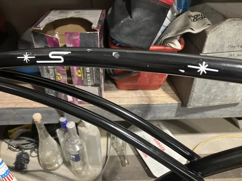

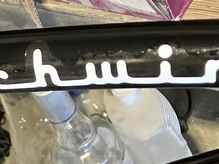

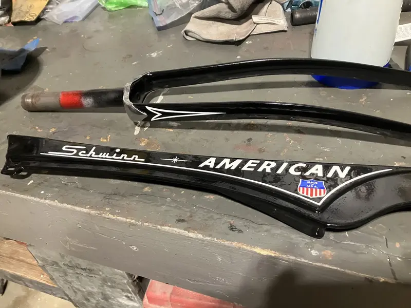

If you didn’t use 1500 wet paper or rubbing compound to sand the paint under the decals absolutely flat, water slide decals will lift at the edge. Any orange peel or slight splatter in the paint and they will lift. I once forgot to sand and had to wet sand and repaint and do more sanding before the decals would stick. I prefer vinyl stickers that I’ve covered with a thin laver of quick set clear epoxy. These never lift, peel or crack. Downside is once you place them it’s best not to move them. I usually place them, lift half, put on epoxy, let it dry and repeat on the other side.View attachment 803256
View attachment 803257View attachment 803258

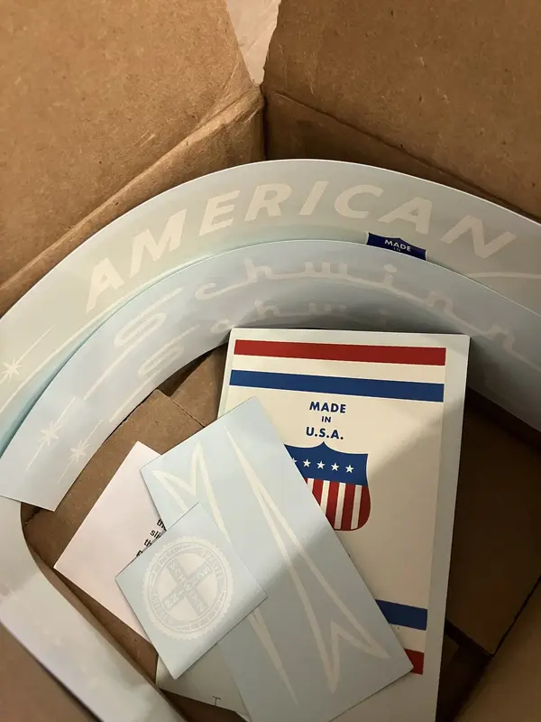

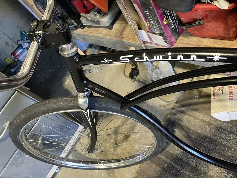

Had a gut feeling the Schwinn decals didn’t adhere properly when i zoomed in on a picture I took. Little rub with microfibre cloth and off it came. I reached out to the vendor on Ebay(BicycleBones) and they’re throwing a new set in the mail dor me. Great service![]()
