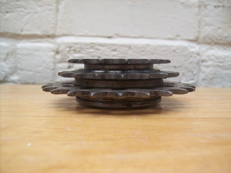

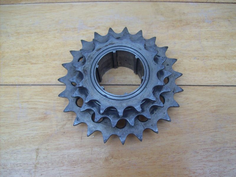

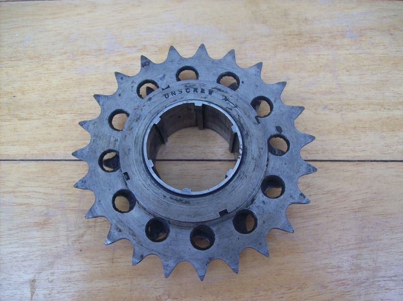

Can anyone help to identify what this freewheel is and who it was made by? Information on it is thin on the ground. I can tell you it is for an 1/8" inch chain, it appears to fit onto a simple splined hub. The only marking I can find is 'unscrew' on the back.
The tooth count is as follows: 23-18-15

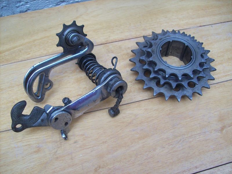

I bought this as part of a job lot many years ago, the box of jumble also contained a cyclo rear derailleur (pictured). It might be related?
It looks like one of those things to fit a Sturmey 3 speed hub and allow derailleur years. I have never seen one off a hub before.
The cogs look like Trivelox to me, generally used on tandems pre-war. The cogs slide on the hub to change gear, so keep the chain in line.
The Cyclo Benelux is one of the later ones perhaps 1960s
