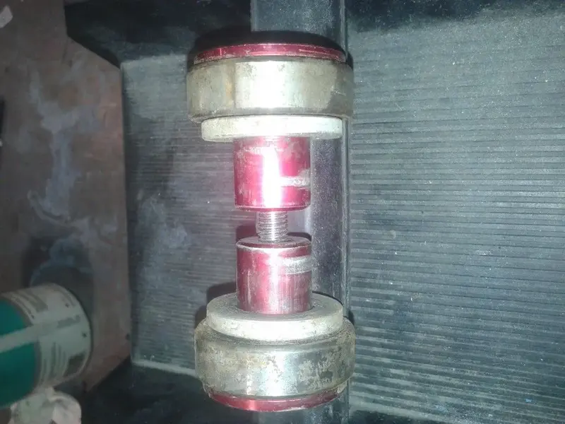

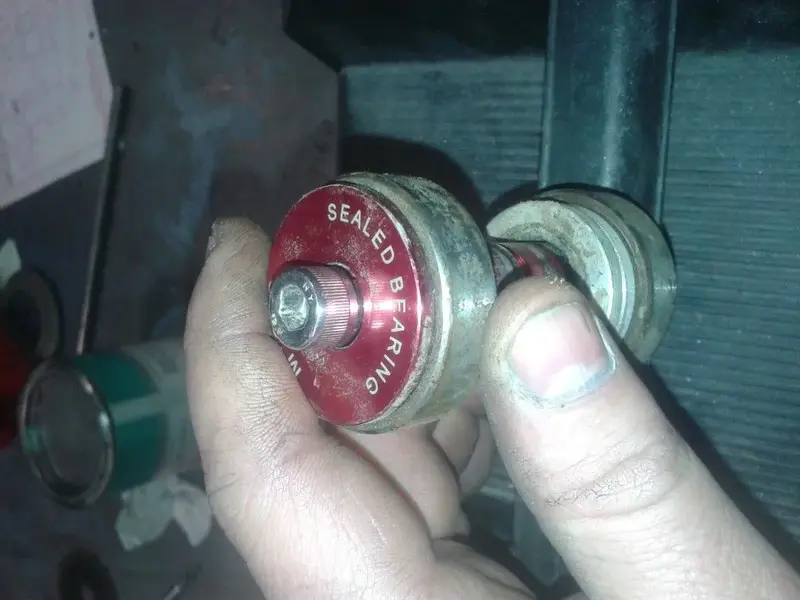

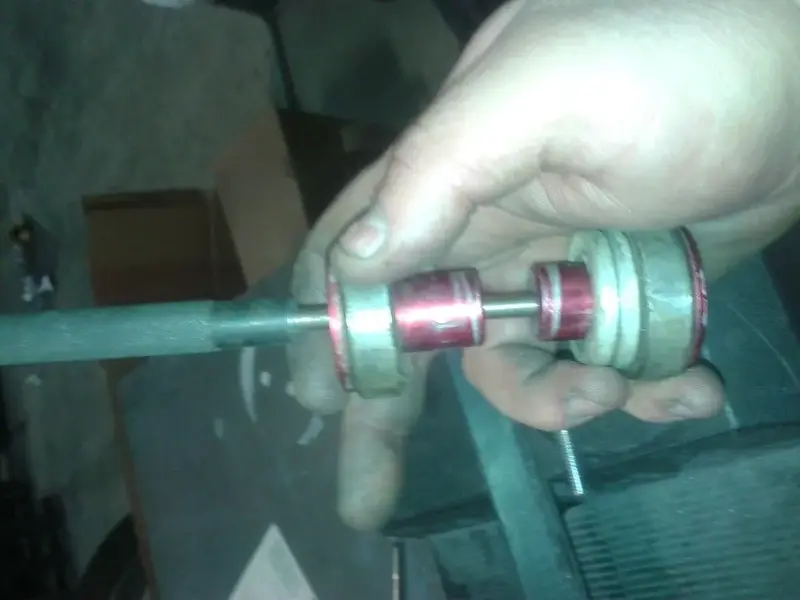

Taken some pics of my pivot and swing arm showing what I did but saying there to big to post so need to get them converted smaller so I will do that when I get in and get them posted between 7 and 8 tonight for you
Re: 2011 msc f5 unsuccessful repair (update)
these are the pics hope these help it didnt take alot of praying open just be gentle it could be your bearings are corroded to the alloy soak the bearings first overnight maybe
hi mate, just had my frame welded (eventually) still a couple of things wrong, the bearings are rusted solid onto those red pin things. tried welding a tube on to expand them and everything haha.
