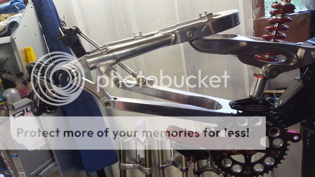

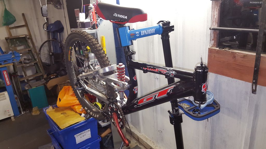

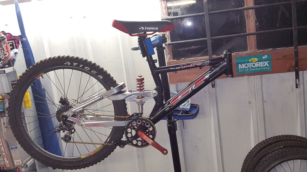

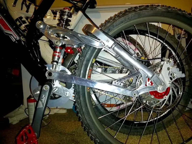

Pic of the frame with my chanset, chain device and mech added quickly.

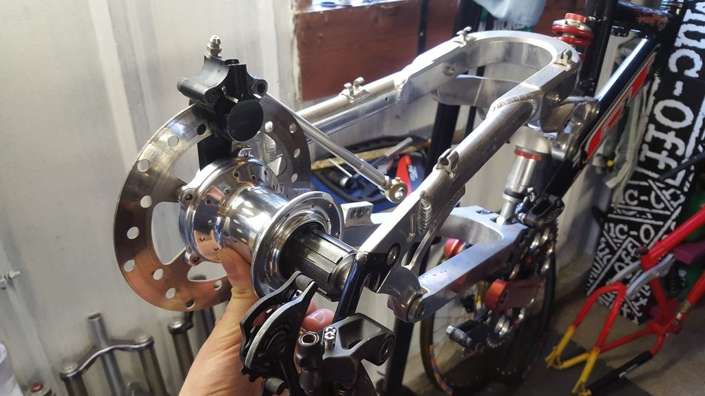

The frame didn't come with rear hub, brake, or torsion bar. So I've sourced a hope no2 axle caliper, which I now know takes a 155mm rotor, not my 165mm :( A hope big un with shortened axle and a hope torsion bar.

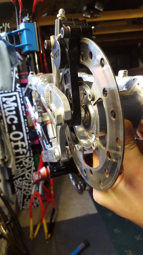

the torsion bar seems to fowl the disc rotor, but i'll know more when I get the correct rotor. Do the proper lobo torsion bars offer more clearance? Do they mount to the GT calipers in the same point where mine mounts to the no2 caliper? I'll get to the bottom of it, but wondered if anyone would like to share their experiences! I understand the no2 caliper wont rotate on the axle, so drilling it out and popping in some bushings will be done at some point.
torsion bar sits to the inside of rotor like this
(custom set up for mine )

Awesome, thanks for the clear pics. My torsion bar came installed on the other side of the caliper, hoping there's thread in the other side then so I can swap it over. Thanks
set up on a 98 sts lobo the cap screw is about 40mm long
