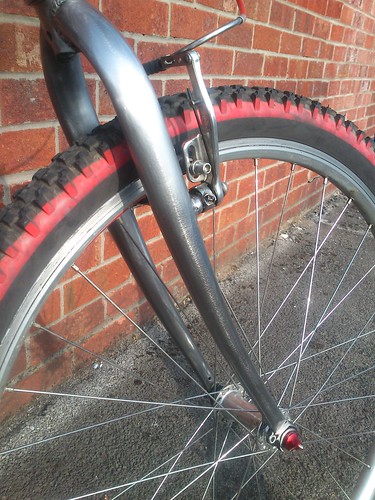

Over the weekend, I attempted to make the fork shiny. I started off by using sandpaper, but it didn't really work.. it remained looking a bit dull, and with bits of dirt and/or powder coat ingrained in the metal. I suspected I'd have to let it rust. :|
On Sunday, I had a brainwave, followed by a root through the shed. I knew I had some weird attachments for my drill that I'd bought for renovating a Mini (a far less successful project), and was pretty sure one of them was a rust/paint remover. I dug out an attachment that looked like this, and had a go at the fork with it while my son was having a nap, not really sure what it would do.
The result was impressive! Gone were all the dull and dark patches; replaced with shiny but quite scored metal. :D
This afternoon, I attempted stage 2; polishing using wet'n'dry sandpaper. I wasn't sure how well it would work, as I'd read that pure metal is hard to make properly shiny, but I went through the grains and ended up with an almost chrome-like finish! It was surprisingly easy, and it makes me a bit tempted to scrub the rust idea and make the whole bike shiny.. I'm not going to, but I might do it if I ever have to get rid of the rust to sell the bike.
I had about 10 minutes left of my lunchbreak, so I decided to put the boiled linseed oil on, in order to preserve it. The oil has an odd smell, which reminds me of going to the beach in my hometown of Southampton. Nostalgic, but not in a good way - the smell was probably being caused by one of the chemical additives, and my memory of the beach in Southampton is one of feeling sick and itching, due to oil pollution caused by the neighbouring Fawley oil refinery. Lovely!

This is where I made a teeeeensy mistake, however.. After applying the oil, I lifted the bike over a rail and into the bike rack by holding the top tube with my rust-preventing linseed oil-soaked hands. :facepalm:
Hopefully I can just sand off the oil, otherwise my bike's going to have two preserved hand prints on the top tube! :P

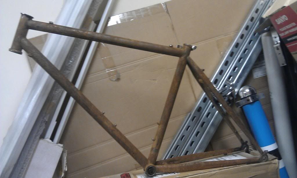

After a few days of saltwater treatment, the bike's starting to rust nicely!
That took 4 days to achieve, applying salt water 3 times a day. It looks almost golden in that photo, but it's proper rust coloured up close. Patchy, too.
Hopefully today's weather will have evened out the rust a bit, though. The bike was in torrential rain for 2 hours, and at one point I had to ford some water that I expected to be a few inches deep, but actually engulfed both wheels! Most fun I've had on a bike in ages. :D
oh, and the linseed oil has failed. The front fork is now starting to look as rusty as the rest of the bike, but I kind've expected that to happen. The smell put me off re-applying it like I should've been doing (once a day for a week, once a week for a month, once a month for a year...), so I'm going to lacquer it this weekend.

I don't know if I should post this photo, as it doesn't look anywhere near as swanky as the previous photo, but I suppose I should show how far the rust got before the bike passed on (to someone else):
It was still a bit patchy, with normal steel peeking out from within the rust, and you can see how the linseed oil failed me on the forks. Another week would probably have gotten full coverage, at which point I would've re-sanded the fork and brazed bits to get their shine back (and used lacquer this time around).

I've taken over the frame and forks with big thanks to Spatuluk. :) I'm not sure what others would do with it but I'm planning to keep it quite industrial or understated or ratesque. I did have one of these mis sold to me last year which made me interested in them so it's great to have a new project, I also think they are a lot like the old Marins which are still on me hit list!

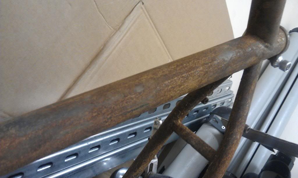

The rust at present has got to that crusty textured sandpaper state now which as an owner of far too many old Fords, I'm not entirely comfortable with it! :D We know its only surface at this stage though, and it's currently in a dry space...
Some interesting patterns caused by nature and use and human element!

The other thing I've noticed in pics and in person is that the right side fork leg is bent back at the top a little. This makes me wonder if the frame got viced to correct forks or something? :facepalm: :D It's (arguably) not quite posh enough to invest in suspension forks and I do have some hardcore steel forks, for it but never say never. anything could happen yet!
Cheers
heh. I never noticed the bend in the fork. I'll have to look at my photos and see if I can spot it, too. :) I guess that might explain why it was always difficult to get the front wheel in..
Some of the sandpaper textures might literally be sand - it got covered in the stuff on Wednesday, while I was commuting on the Trans Pennine trail in the rain. I meant to brush it all off before I handed the bike over, but I was in a bit of a rush on Monday. :roll:
