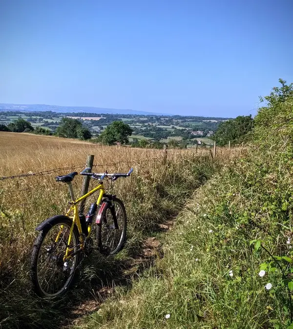

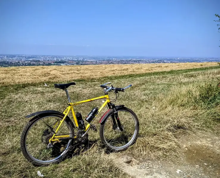

Went out for a more testing loop recently, taking in the toughest bits of local riding available to me.
Started with a pretty brutal climb right from the front door on the back lanes, but was rewarded with some lovely flowy gravel style singletrack along the ridge.

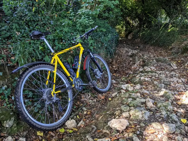

Dropping down off the hill, the trail is often basically a river - this is the only time I've ridden it and found at least the top section to be bone dry. The photo below doesn't really capture it, but there are some really pretty steep sections, with pretty chunky rocks. Riding this descent is the only time I've found the fixed seat post a bit limiting. It's difficult to carry enough speed to blast through the rocks when you can't get low over the bike without the saddle pushing you up and over the bars, so you're left hanging as far off the back as possible, cringing down the steep bits, and having to pick a very careful line to stop from stalling or having the front wheel turn at low speed.
I did end up tripod-ing down one of the steeper sections, but I'm going to count it as a win for getting down without stopping!

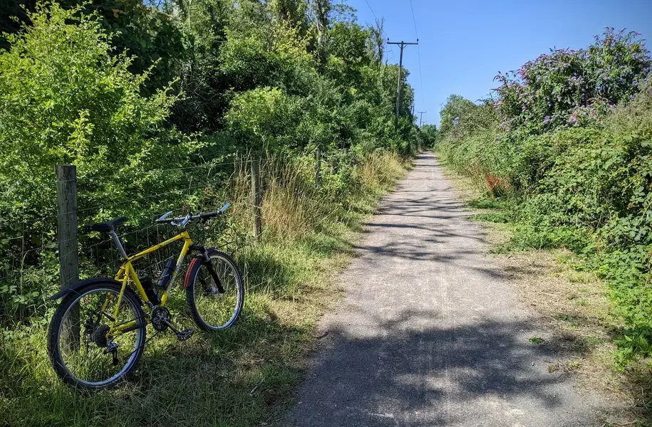

After a road crossing and a really challenging short punchy little off-road climb, it's back into gravelly cruise mode, with some lovely views to enjoy along the way.

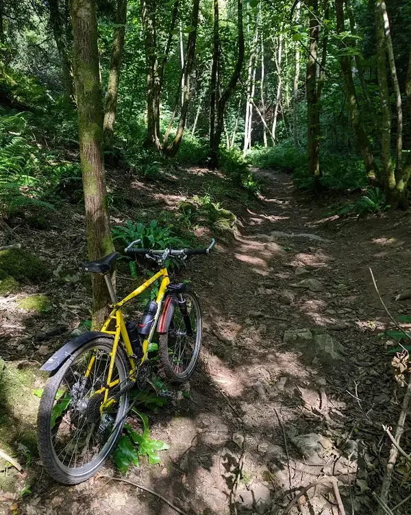

Following the trail eventually leads to one of the local woods, where a number of "proper" MTB trails have been built by the locals.
I didn't ride any of the groomed bermy jumpy sections, but there is a really fun line that runs down the valley bottom - very rooty and rocky, but not particularly steep, so you can keep off the brakes most of the time and use a bit of speed to hop some of the worst bits.
The high seat post was no bother here (it only becomes an issue on really quite steep sections), but the short travel of the fork made it a little harder to keep the speed up through the rougher bits. I'm really enjoying this lowered Tora - it feels closer to riding a rigid fork than a plush 120mm jobby, and really fits this current build, keeping a lot of the original charm and character of the rigid forks... However I'm under no illusions as to the fact that it's still doing a fair bit of work, as I'm 100% sure I'd have been a bit slower and a lot sorer on a rigid fork.

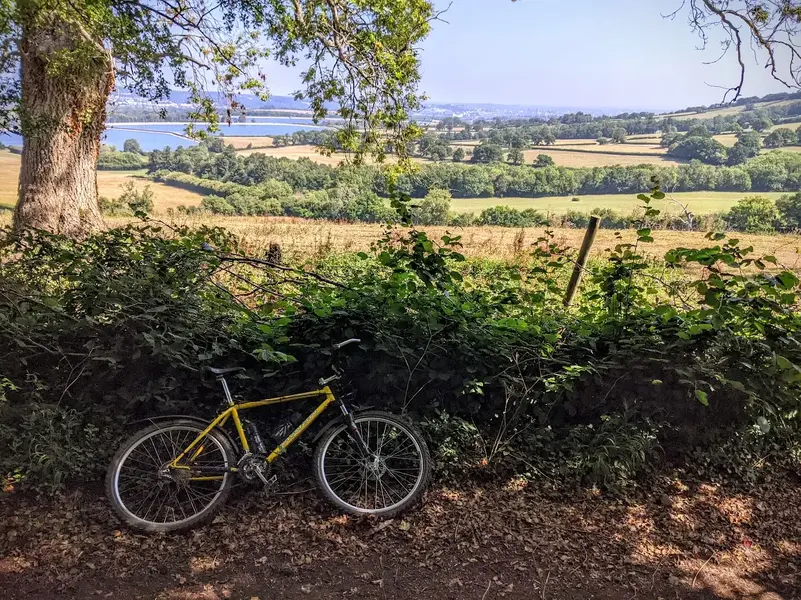

A bridleway climb back up to the top leads onto a track that runs around the edge of a quarry. From here there's a load of tiny back lanes and linking dirt tracks that run around the back of Bristol airport. It's so quiet and pretty that most of the time you completely forget this, until a plane comes blasting in overhead a few hundred metres above your head!
Plenty more steep and rocky bits, both up and down around here. The fixed seat height means I'm not running my saddle quite at full road-bike pedalling height, which I was expecting to be a problem on the tougher climbs around here (there's a couple of max effort sections that have always been hit-and-miss as to whether I can clear them). My feeling was that maybe my knees were slightly less happy than they would have been with the seat 10mm-20mm higher, but I managed to clear all of the tricky sections around here, which doesn't happen that often (probably helped by the fact that it was bone dry).
Heading back to Bristol on the back lanes, another stiff climb got me a good view of the city before bombing back home down the hill.
