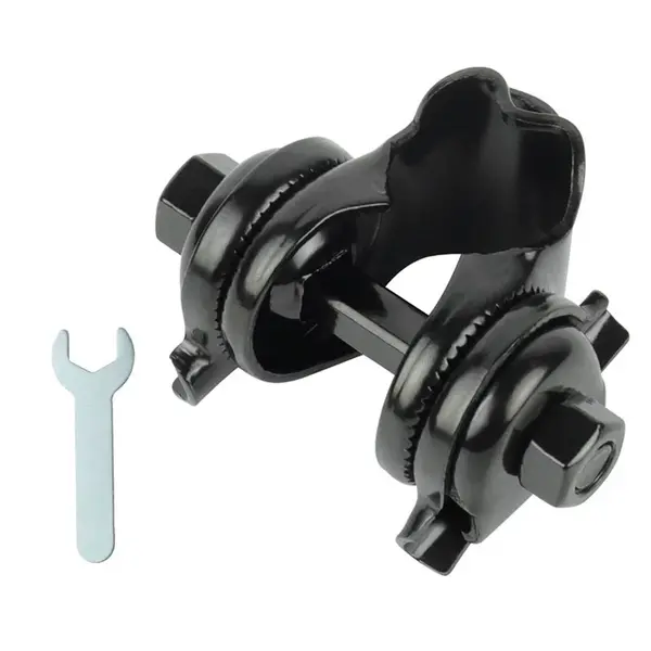

I mean as long as it's not a seat post that connects to the saddle like this.

I like the seat posts with the saddle rail clamps built in.
