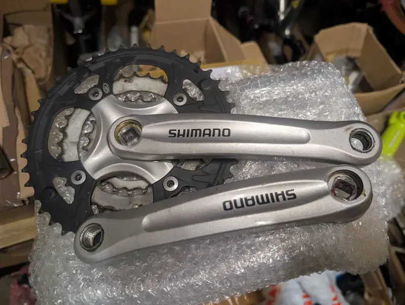

I've got this triple that would bolt straight on to your BB
Great, let's do that then. Thanks! Is it possible to add a chain guard?
