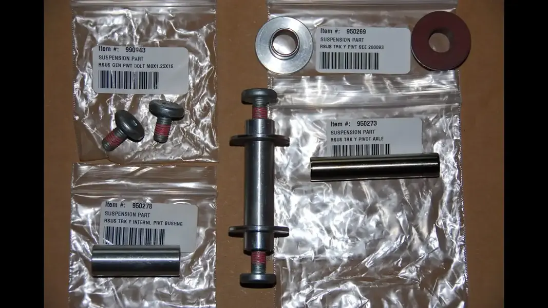

Hi all,
My beloved 1996 Trek Y11 has seen some better days. I’m told by the bike shop that the bushing at the unified rear triangle pivot point that connects to the carbon Y frame is cracked. As such, whenever I pedal hard or force down on the cranks, there are loud cracking sounds that echo through the frame. Fairly disconcerting.
As well, the rear shock recently died on it, and seems to no longer have any pressure. I’ve since resorted to just tightening the coil as much as I can to try to effectively lock it out, but I’d rather replace the shock with something cheap and decent. I’m not sure what a good option may be? Not sure sizing etc. The current shock is a Rockshox Vanilla of some sort. Unsure if it matters but the frame is a large.
I’m hoping someone may have an idea about replacing this bushing or whatever would be causing that cracking sound at the pivot point, and where I may be able to track down the part. I’m coming up empty handed so far.
Thanks for any guidance!

Hey right back!
The most economical solution is to find someone on here willing to send you, for almost no money, an OEM shock from a Y-bike they've got lying around. It happens! So keep posting. :)
Beyond that, having gone through this, I can tell you that you need a shock with a 6.5" eye-to-eye measurement, and, depending on the features you need/want, this might be your best bet and isn't bad at $99:
DNM Damping 3 System Mountain Bike Air Rear Shock Rebound/Lock Out/Air Pressure Adjustable AL 7005 Shark/AL 6061 Shock Body 165mm (6.5") x 35mm 190mm (7.48") x 50mm 200mm (7.87") x 55mm
https://www.amazon.com/DNM-Mountain-Shock-Lockout-190mm/dp/B00FLTZ47O/ref=sr_1_4?crid=176PYV023N41M
This one is even cheaper ($55) and likely closer to the original spec, it has a spring and an air canister:
DNM Damping 2 System Mountain Bike Rear Shock Rebound/Preload Anodized AL 6061 Coil Spring 750 Lbs 165mm (6.5") x 35mm 190mm (7.48") x 50mm 200mm (7.87") x 55mm
https://www.amazon.com/DNM-DV22AR-Mountain-Biycle-Spring/dp/B01BIQN5UG/ref=sr_1_1?crid=1X76S2F6Y21KT
The first is superior in that it is more adjustable, I can explain those settings if you want. The DNM shocks get a bad rap among the hard core enthusiasts out there, I was shamed on a local forum when I suggested getting one for my Y11 (lol) ... and ended up lucking out and finding this super nice Fox Float RP2 that I'm really happy with, for $120 + tax & shipping:
https://www.ebay.com/itm/124947773463
The other thing to keep in mind is the mounting bushings, they can be tricky to get in and out, I was able to re-use the ones from my old shock on the new Fox.
Also note these bushings are different from the swingarm bushings I believe you are also seeking to replace. FWIW, I got this image from someone on Facebook's Y-Bike group (it's called "Project Y"), it lists the original part numbers for what I think are our Y-11s, but I am not sure.
Hope this helps!
-kj-
