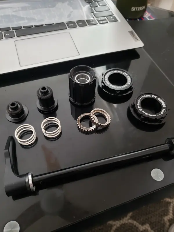

Got my package from China. They sent me the wrong front end caps though. Also I had to get 5mm QR rear caps as they didn't have the 10 x 135mm through axle type. Might try and drill them out or just run a standard QR for now and grab the proper DT 10mm caps later down the line
The 54t drive ring is loud as hell and reminds me of back in the day when we used phone cards to make our bmx sound like a motorbike! :D

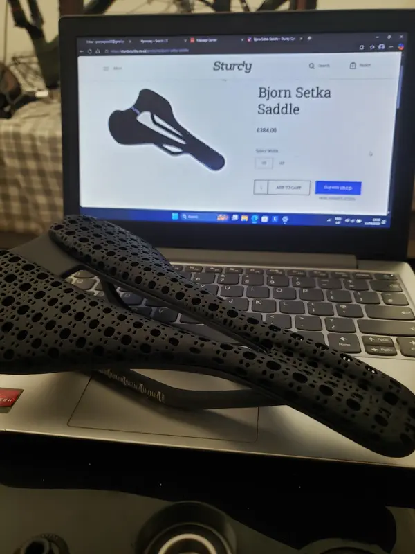

I also got this saddle... Its a copy of a Bjorn Setka which retail for Ā£380! Looks pretty well made and super light. Will see how comfy it is and if it lasts šŸ¤ž
Looks amazing and purposeful! The silver touches finish it off beautifully.
How's the saddle?
Thanks. Definitely feels more responsive with the lighter wheels and the faster freehub engagement. Saddles ok. I didnt even notice it which is good i suppose but I need to do a longer ride to really see how it is. So far so good though šŸ‘

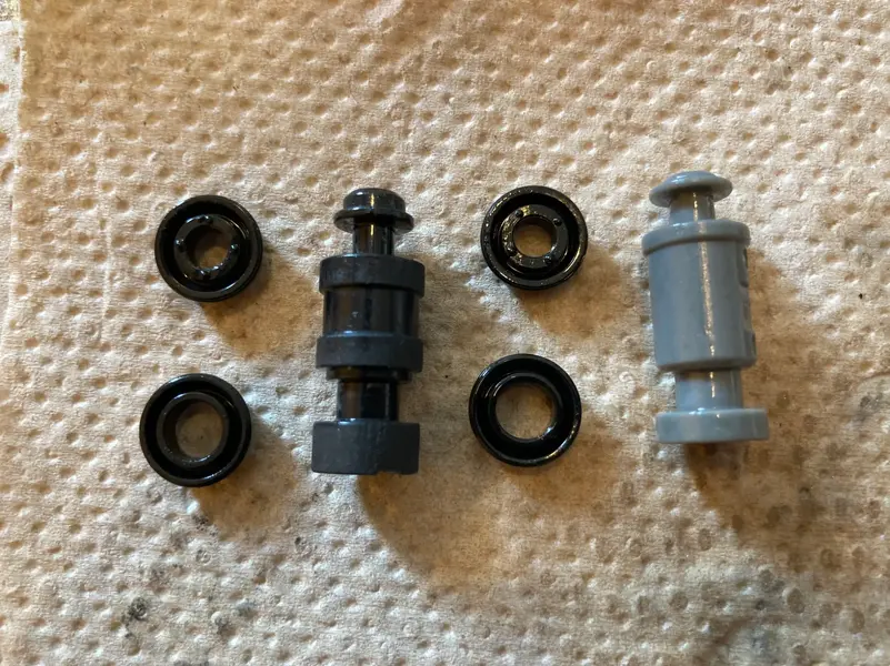

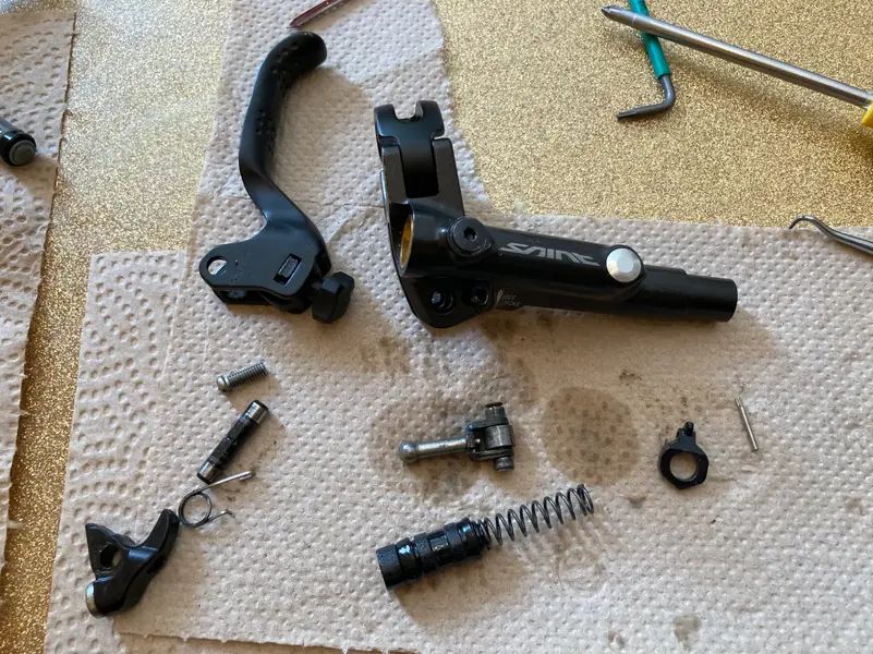

Applying pressure to your lever, does it slowly move to the grip over 10 seconds or so?
If so it is very likely that your master cylinder seals need replacing. I did this myself not too long ago on similar Shimano levers.
Those seals are available seperately on eBay under ā€šRisk Replacement sealā€˜. There are multiple kinds, so you need to pay some attention.
Cheers I hadn't considered that. Mine doesn't pull to the bar but it pulls further before the pads hit the rotor and doesnt feel as firm as the front. My front brake has a earlier bite point and I'd like them both to match but its non adjustable on M985 levers, only reach. There doesn't seem to be any signs of leaks anywhere at the lever or caliper either so Ive no idea really what the problem is šŸ¤·ā€ā™‚ļø
