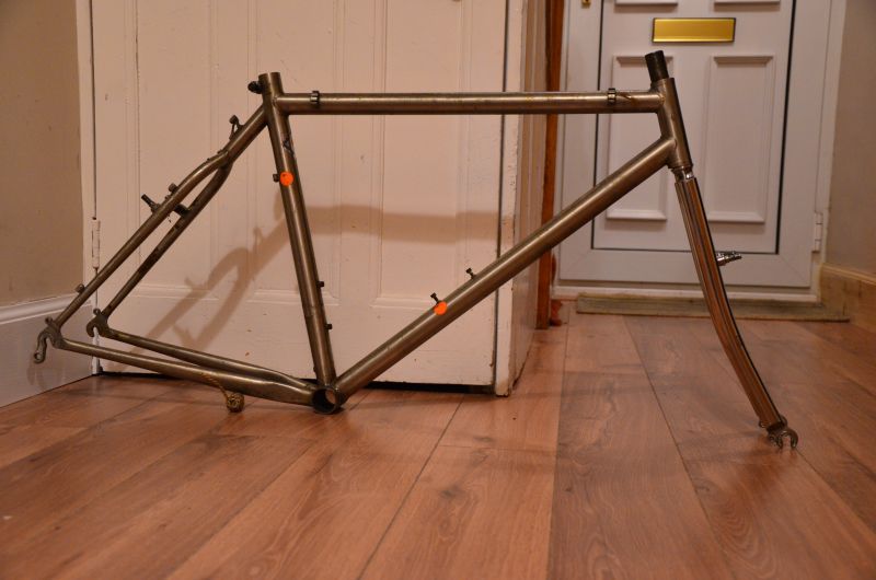

1996 Orange P7 with F7 forks, 19" series 8
stewlewis
Picked up this cheap f&f to practice spray painting on, looks too good for that, yet to decide what to do with it, depends what bits I have in the garage.
Has clamp which looks original, stx headset, forks are threaded I guess 1" as there's a shim on the ahead/quill converter.

This won't be getting any paint, though the finish isn't perfect as it stands. The clear coat is rubbed in places and there are a few rust spots.
I'll take some pics before attacking it with tin foil, removing the lacquer and decals.
I'll be clear coating it afterwards, practice my spraying after all. Just need to research getting clear coat to stick to polished steel/plating.

I measured the ID of the seat tube, ghetto, with a ruler. Just under 30mm. My slot faces forwards, though I am not a girl. There's a shim in place. The bike according to the SN is March '96.
Orange say:
P7 94-98 30mm seatpost 27.2 +shim seat tube 31.8 Slot faces rear
P7 98-05 29.6mm seatpost 27.2 +shim seat tube 31.8 Slot faces front
Hmmm. A 27.2 will go nowhere near, with the shim in place, possible non factory shim?!
A 26.0 fit in with the shim but isn't properly snug. I'll source a 29.6 post to try but guess it'll be tight, or another shim and a more common 27.2mm
