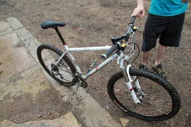

I have a 96 Lava Dome with 80mm forks on it and it rides and handles brilliantly. No issues whatsoever. I think the real reason some oppose putting a modern longer travel fork on an older frame is purely to do with aesthetics and preferring a period look.
On Sunday I kept up with the front of the pack who were all on circa 140mm burly FS bikes even on the downhills.
If you want fast twitchy nervous handling go 'period'. If you want a proper handling bike with modern geometry then put 80mm forks on your old steel Kona. You wont regret it :D 8)
