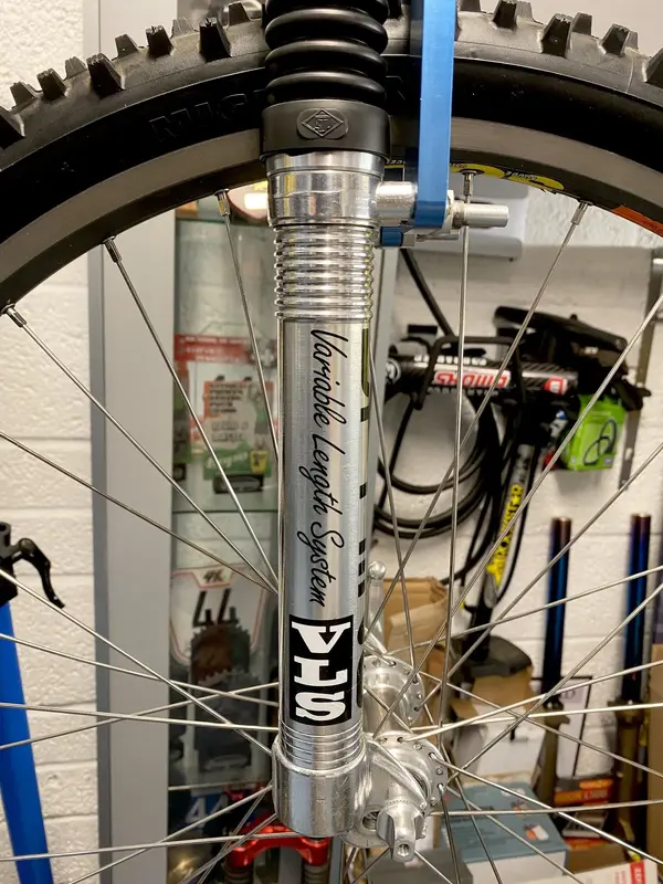

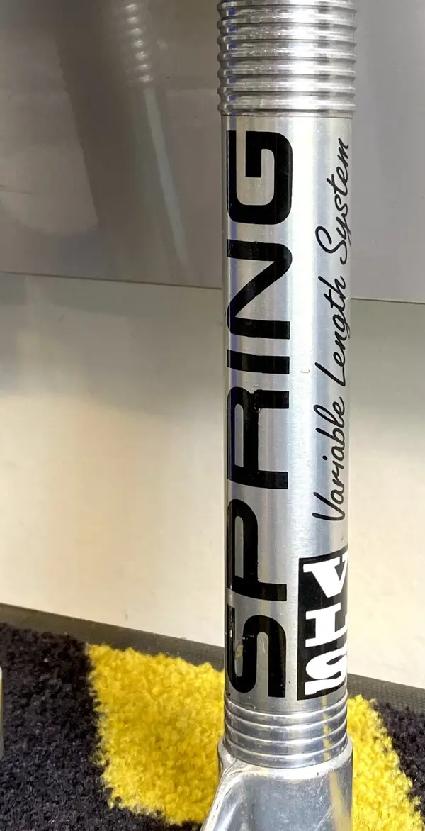

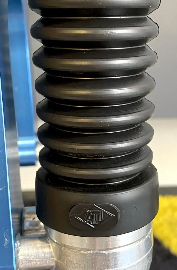

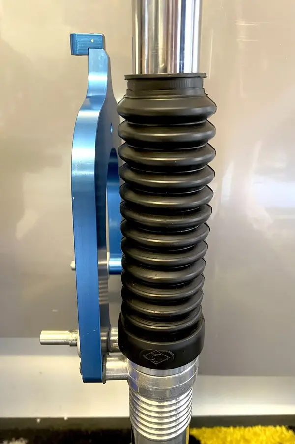

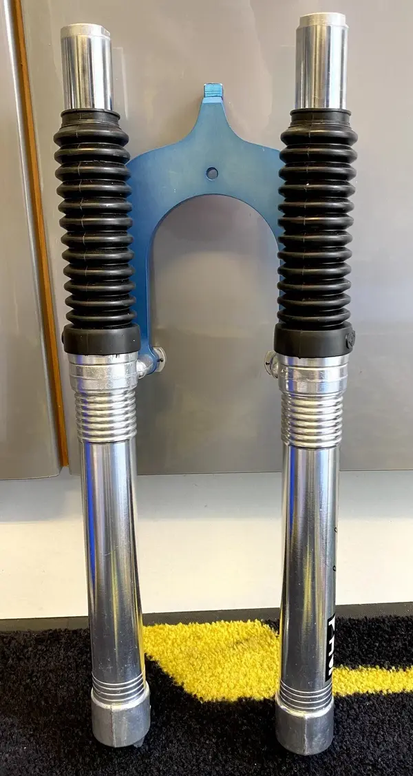

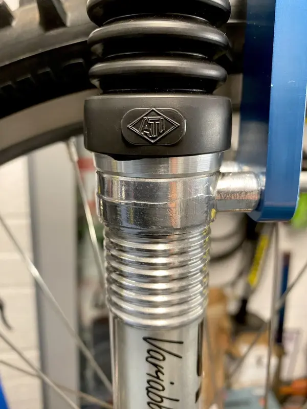

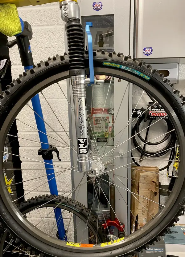

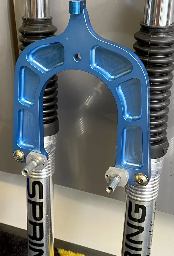

Spring VLS forks cleaned, checked, serviced, refurbished and rebuilt using all of the original fixtures / ATI gators. Will get another clean / polish once fitted back on the bike.
When I first got the bike I thought that the blue anodising on the brake arch was faded, but having heavily researched the forks this is how they were from new and when I had the forks apart they showed absolutely no sign at all of any fading in the slightest that was a touch 👍

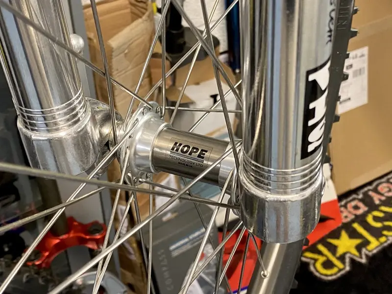

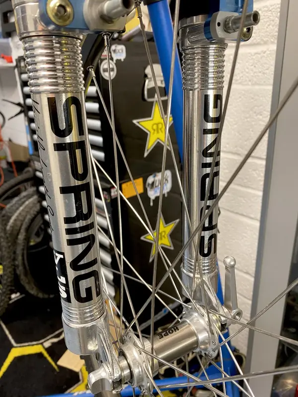

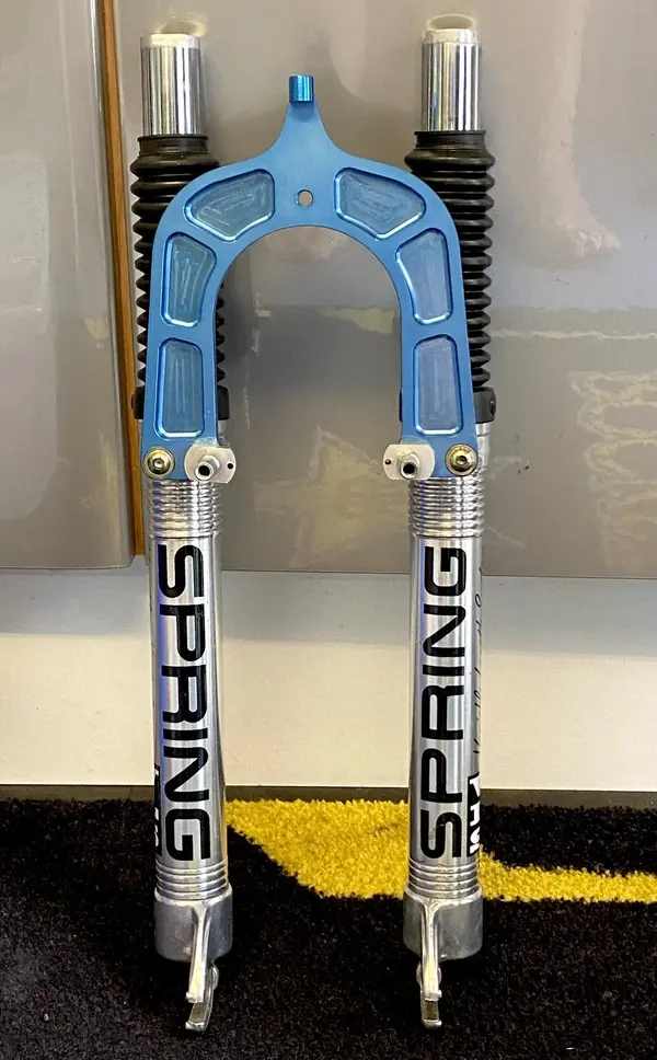

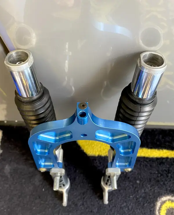

Just reallised that you can set the fork offset on these. What a neat feature!
this was nicely documented already a bit earlier from @44Racing here #5
I think the VLS is the only suspension fork allowing an adjustment, but sure there are some rigid forks with similar stuff, most known are the GT forks.

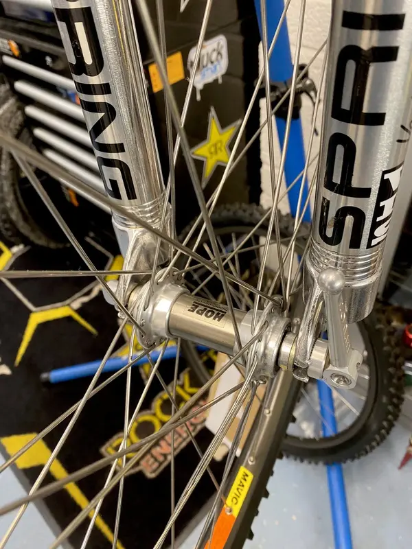

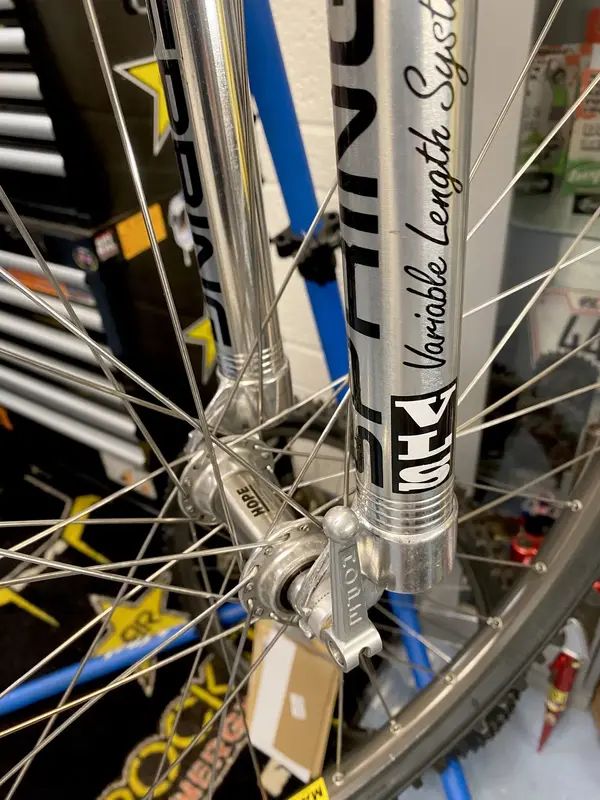

The fork in combination with Hope hub and skewers look great! 🤩

Yes it’s a crazy feature where you can lengthen and shorten the wheelbase for different tracks.
Fork offset became a bit of a thing in the last few years and there now are options.
I tried to get my head around fork offset and I got this far:
- more offset -> less force needed to turn the bars -> easier to ride hands-free -> more cornering with less lean -> less stability at higher speeds -> front wheel easier deflected by obstacles
- less offset -> more force need to turn the bars -> trickier to ride hands-free -> more lean angle needed to make a turn -> steadier steering feel at higher speeds

That’s a great picture. Is interesting to see the subtle differences and evolution of the frame.
I’ve personally never seen a suspension fork with adjustable horizontal dropouts before, especially from this era. Like you say GT did a rigid fork called the 3D that had horizontal dropouts.
Pretty happy with how the fork, hub and QR combo turned out 😎
