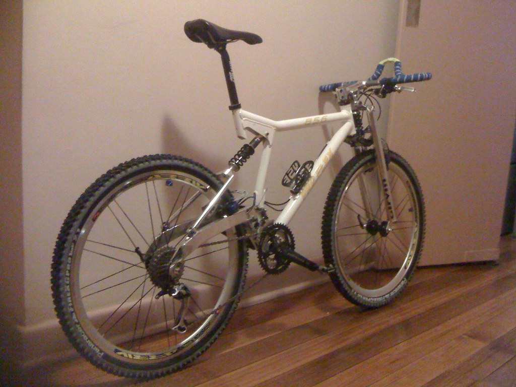

Well the final piece of the puzzle came in today courtesy of CRC, a Wipperman Connex 9SP chain. So, home from work, quick ham and cheese sanga, and then fired up the chain breaker! Now all I have left to do to go for a decent ride out on it is to fit the RK005 seal kit to the Vectors and go for a spin. I couldn't resist after fitting the chain to go for a quick lap of the block, super slick shifting courtesy of, gasp, heresy, M970's and M770 rear mech. Pretty chuffed the way she's come together, even Mrs S thinks its so nice she wants a bike now. Suitable ladies retro recommendation will be taken! Big thanks to Arran, Steve and Paul for helping in this build and everyone else for keeping old metal alive!
As usual, crappy iPhone pics but i'll get some action shots of it out in the wild this weekend!
I keep looking at this build, and I love it.... 8) 8) 8) looks really clean in white, but really aggresive and purposeful with those forks... :twisted:
The AT-4's look good too IMHO... :wink: 8) 8)
