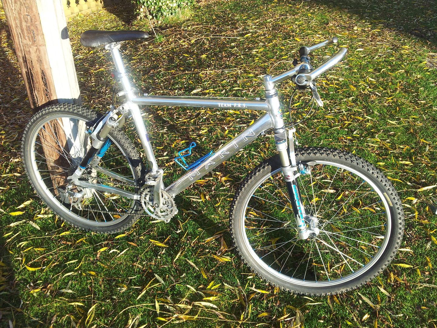

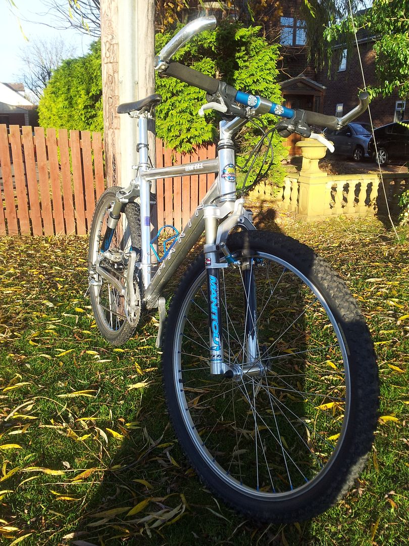

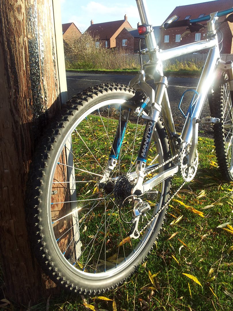

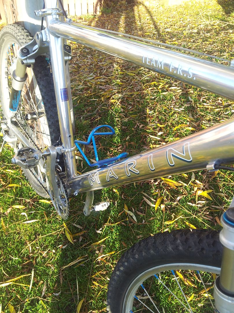

Here we go... decalled up and the correct colour rear legs procured. These were a bit of a pain as the stanchions were shorter in the replacements, so both sets had to be stripped and swopped over...
As ever stunning service from Gil_m on here with the decals - accept no substitute!
Very pleased with final result!
