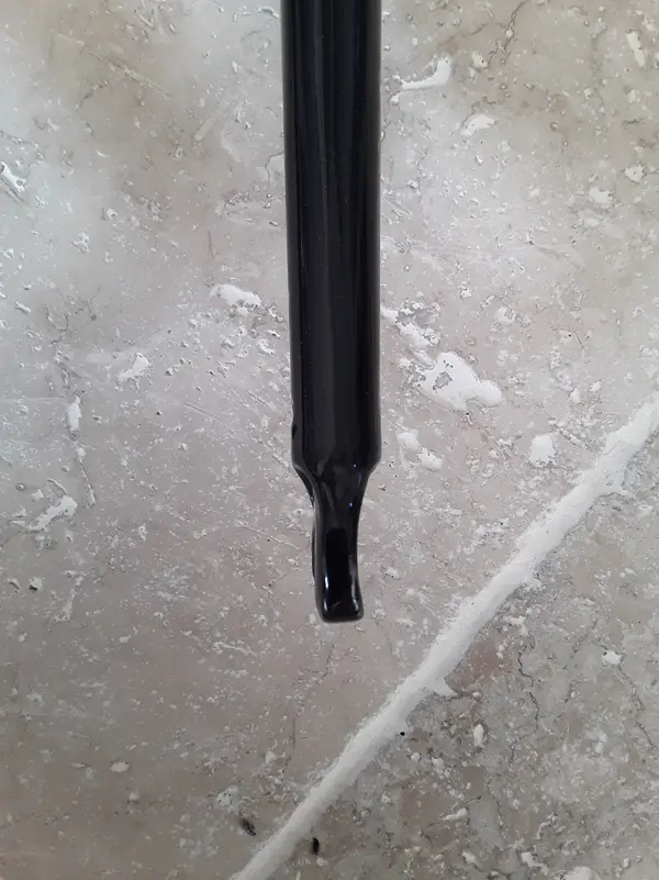

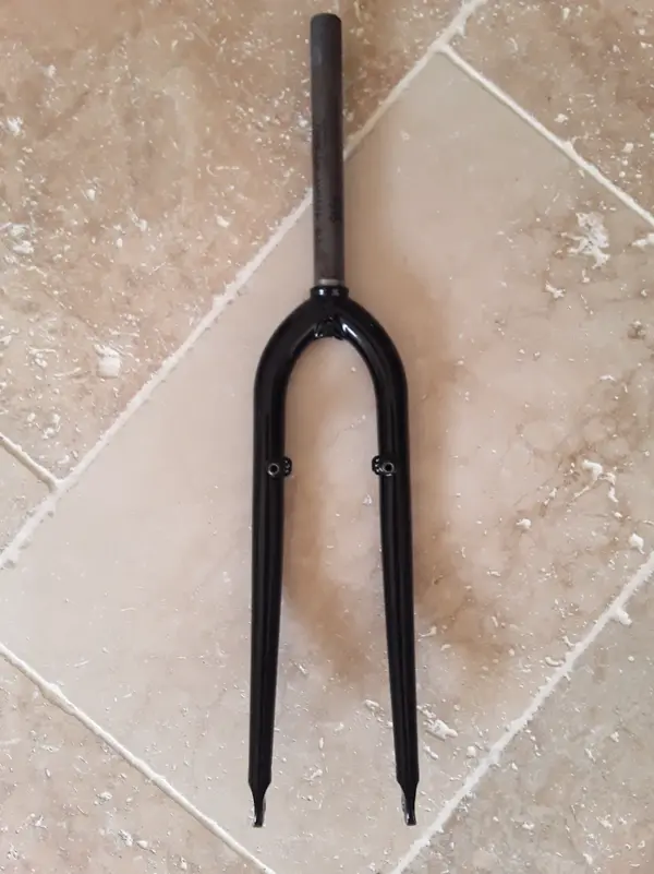

They were pretty light too. These are out of an xl 20.5 team 89 and weigh 865g. Much lighter than later rockstars, which although advertised at 750g, were only that in 15 ". 😂
By the time you got to 20.5 they were over 1kg.
