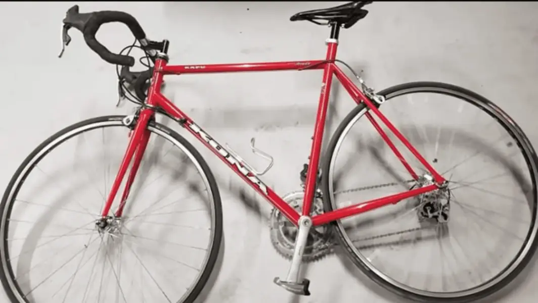

My friend Jason, who is a fellow admin on the Classic 1990s Facebook page, had this bike, but it was too small for him. He listed it for sale to our page, not knowing that I had been looking for a '94-96 Kona road bike for a few years! I had looked at two 94 Haole locally in St. Louis, but they were both too large. A third even popped up on Facebook locally a little bit after this Kapu was in my hands. Of all the cities in the US to find three early Haole, I didn't think it would be here. Must be all the rich doctors and dentists. I prefer the cheap and achievably priced bikes anyway!
Jason originally bought it from the friend of Leo, the original owner, who had it set up as a tri bike. Leo's friend had it for 10 years or so:
Jason cleaned it up, re-greased everything, and replaced almost all the consumables. He installed a shortened stem, and his preferred saddle and post. He removed the "Leo" sticker from the top tube, and mixed up some perfect touch up paint and fixed all the blemishes. This is how Jason had it when he listed it for sale:
Luckily, he still had the original stem, which he sold to me with the bike.
Per usual, I stripped it down first thing out of the box:
It didn't take long to build back up while I waited for some consumables. All I needed was bar tape from his stubby stem removal, and new cables, as unfortunately the original script logo Campy housings were shot. I had some Kool Stop pads, holders, and hardware lying around that ended up working perfectly:
Once I sorted out the brake pads, cables, bar tape, and those nasty Bontrager logos on the tires, it ended up looking something like this:
I tried to sprinkle in some of my favorite mountain bike parts, like ControlTech seatpost and skewers. I even fitted an Avid Rollamajig!
I absolutely love this bike and how it rides, but lately I've been having the urge to do something different. I have hardly ridden this bike since COVID started (the Campy Omicron rims aren't helping 😂 ), and I want to change it up so I have an excuse to ride it more. This might result in a rebuild soon, so stay tuned!

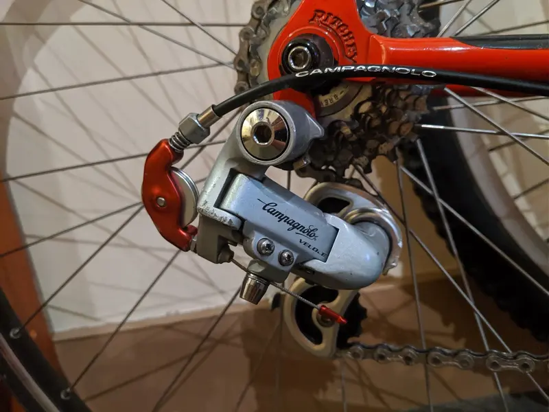

Whats this rollamajig thing do?
The Avid Rollamajig reduces the rear cable housing bend to the rear derailleur to avoid snags, and improves shift feel. I have them on all my bikes.
More info:
http://www.bikepro.com/products/rear_derailleurs/avid_rolla.shtml
http://backboneracing.blogspot.com/2007/09/avid-rollamajig-death-of-classic.html

Well, it's been a while since I updated this build thread. I haven't touched the bike since the last update, and barely rode it 10 miles. That ends soon.
I have recently acquired these Campy Veloce 8x2 downtube shifters, and they will allow me to turn this bike into the flat bar bike I've wanted. I have been searching high and low for some Campy Euclid levers, but they are kind of expensive, and I'm not quite sure the color will match, so I'm going with a pair of Kona Race Light High Command in polished silver.
Well, that was quick! I didn't anticipate sitting here and building out this bike this evening, or riding it just after midnight to work out the kinks. This bike rips! It is exactly as nimble and comfortable as I expected it to be. I don't know why I didn't do this sooner. I'll take lots of more pics once I go on a long ride in the sunlight.
