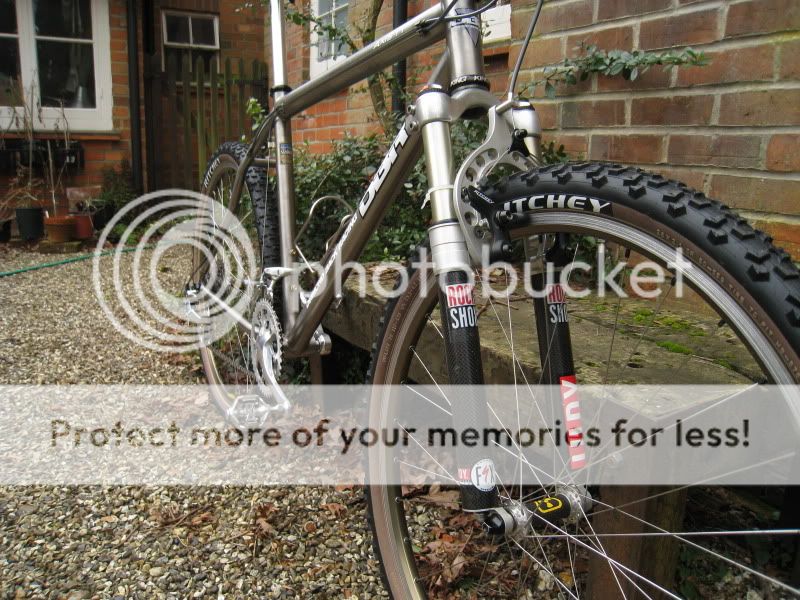

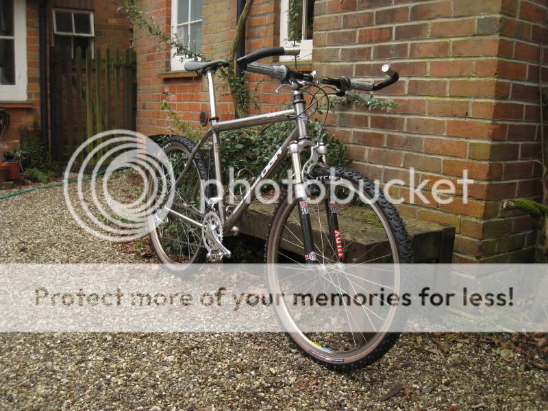

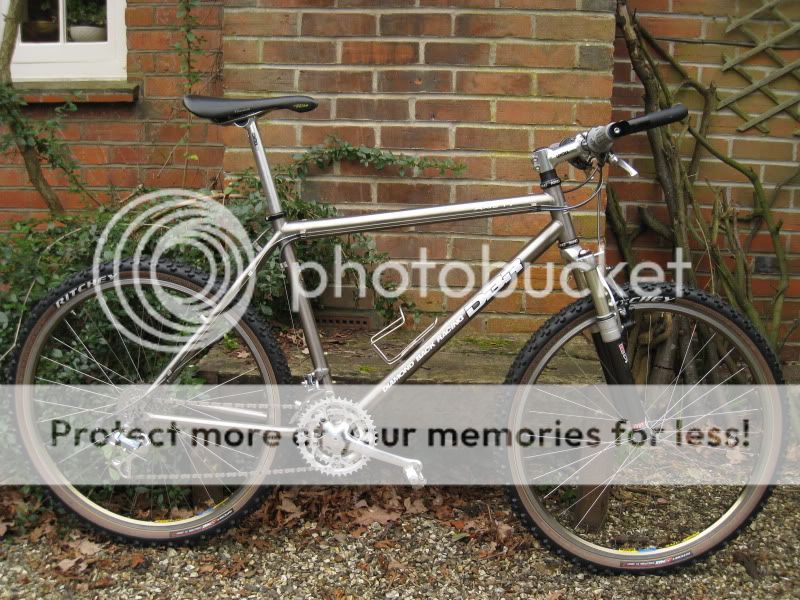

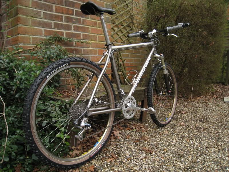

Up-date 25th Feb '11
A bit of progress today :)
Judy FSX fork fitted - courtesy of jango :) Thought I'd see how the black RL cantis look. Couldn't fit the rear as no more brake inner :oops: :roll:
Now, also with chain and functioning mechs ;) :lol: ....
It's a bit of a cliche, but the pic don't really do it justice :lol: I am very pleased with the overall look :D And bar trying a set of Ritchey Logic cantis in silver and fitting a Ti Ritchey BB instead of the M900 it's about there I reckon ;)
Spec:
Frame: 18" DBR Axis Team Titanium 1521g
Fork: Judy FSX
Headset: King No-threadset
Stem: Control Tech with ti bolts
Handlebar: Answer Hyperlite
Grips: Answer
Brakes: Ritchey Logic
Brake Pads:
Brake Cables: xtr
Brake Levers: Ritchey Logic
Shifters: Gripshift X-ray with Answer grips
Front Derailleur: M900
Rear Derailleur: M910
Derailleur Cables: xtr
Cassette: M950
Chain: 8 spd
Cranks: Cook Bros 'E'
Crank Bolts: Steel - ti on the way ;)
Chainrings: Shimano 42,32,22
Chainring bolts:
Bottom Bracket: UN-91 will be Ritchey titanium
Pedals: Onza HO Ti
Hub Skewers: Ringle Twisters
Rims: Mavic 217
Hubs: Nukeproof - carbon
Nipples: Alloy
Spokes: DB Stainless
Tyres: Ritchey 2.1 Z-Max Evo (re-issue)
Tubes: Yes
Saddle: Flite Ti
Seatpost: Control Tech
Seatpost Binder: DBR Alloy
Bottle cage: Titanium
Weight: Approx. 22lb
Cheers
it looks superb! that is a really nice top shelf build that does the fram justice. whats inside the forks spring and cartridge wise? have you taken it for a ride yet, it must ride well i would imagine.
Understated and purposeful :D ..though I don't like the stem and post, too clumsy looking.
