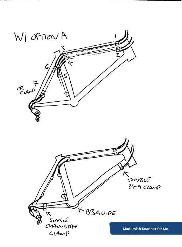

I’m thinking both front & rear loops utilise the brazed stops on the top tube, seat tube and seat stay as normal, but then return old school style via a BB mounted plastic guide and a clamp on pair of stops at the top of the down tube..
Any thoughts?

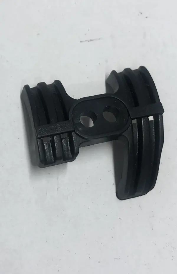

I wonder if anyone might want to do a swap? ;) IMG_6121.webp IMG_6122.webp s-l500 (1).webp

Anyway... having looked over your drawing I can see your issue. Will the Spooler work if the cable is routed down and around the wheel and then up the down tube? In all the configurations I've seen the loop is quite tight i.e. it goes back along the same path it took to get there (I think that makes sense!)? I guess if it does then your idea will work but I think you'll need a solution for the chainstay.

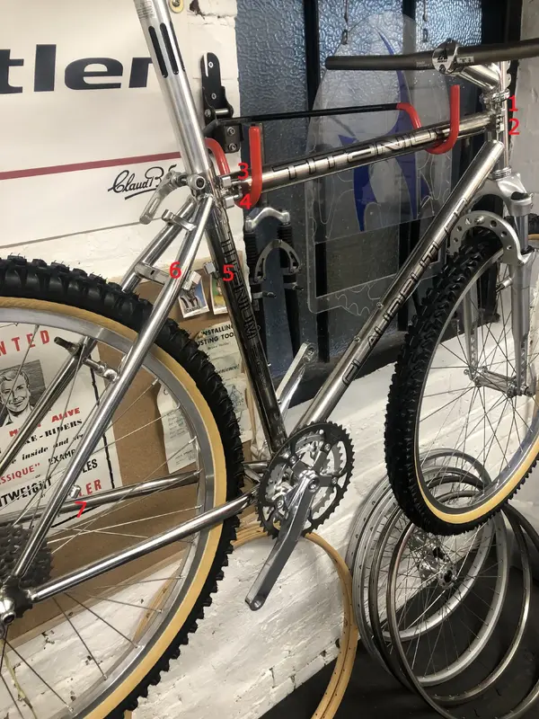

This frame, like Adi75’s has seven gear cable outer stops, 4 on the top, 1 on the seat tube for the FD & 2 on the drive side seat stay...pretty standard stuff. But that’s 7 mounting points and the LMDS kit I have only came with 6 of the double adapters.
So, options are;
1. Find or have made another adapter

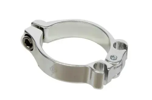

2. Add a clamp on Shimano seat stay cable stop beside the brazed on one (I’ve seen “dura ace” ones on eBay)
3. Use a single chain stay clamp on stop with the BB guide and a double down tube clamp using none of the WI double adapters.

Anyway... having looked over your drawing I can see your issue. Will the Spooler work if the cable is routed down and around the wheel and then up the down tube? In all the configurations I've seen the loop is quite tight i.e. it goes back along the same path it took to get there (I think that makes sense!)? I guess if it does then your idea will work but I think you'll need a solutions for the chainstay.
Morning Swede...
I think I need to check if the FD cable drum will work this way as you quite rightly pointed out, the cable needs to wrap at least 180 around the drum to work.. I’m not sure if wrapping it all they way around is possible.
Although I fancy the tidy (IMO) none use of the WI adapters, it might just be easier to add the seat stay clamp stop and use option A
