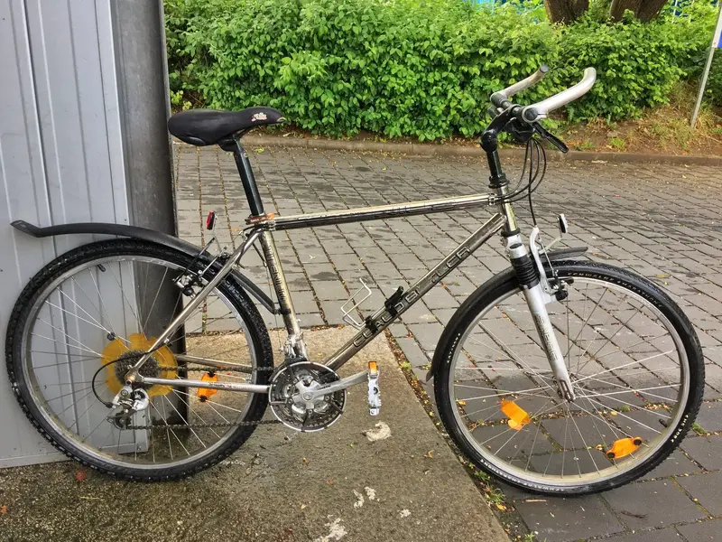

Actually, I've been meaning to do this for some time now, ever since @IHateRain donated most of the correct running gear from his Titanius over in Germany to the cause.
So, my German Titanius F41 00557 (which had a short life as a gravel bike, see here; ) is going to get dressed up in all the STX kit from (I'm assuming scrapped?) F41 00648
It's not just for the sake of it though, oh no, it's going to spend it's days in my basement strapped to my turbo trainer, destined to see thousands (maybe hundreds) of digital miles on Zwift!

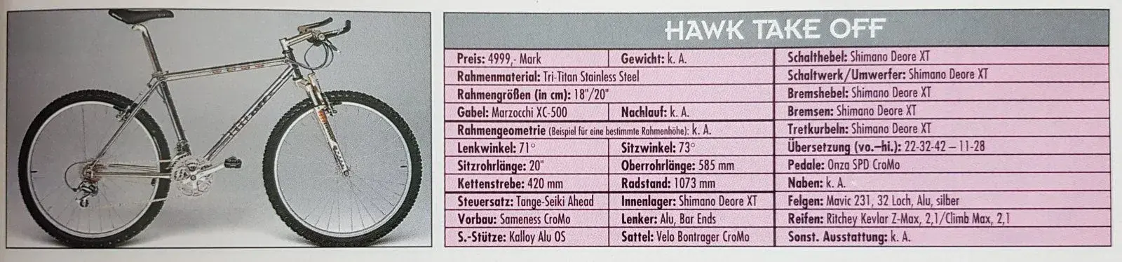

Bit more digging (by I Hate rain) made the discovery that in 1994 a German company called Hawk were advertising a Titanium range of bikes, one of which (the Take off) has a frame with almost exactly the same details as the Titanius except the connection between the stainless-steel lugs and the Ti tubes was beefed up, one could easily make the assumption that they (Hawk) were the actual manufacturer of the collapsible bargain bucket Clauds...

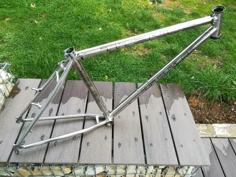

Ok, so here are some before shots, first the frame I'm going to build on used to look like this before it started to fall apart;

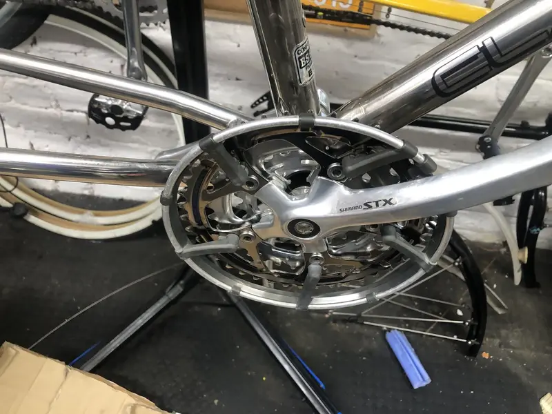

And its donor F41 00648

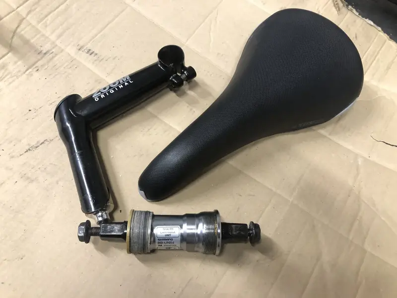

Looking through the parts I have, the only stuff missing is the BB, the Vuelta saddle and the Zoom stem, but I'm pretty sure I have those knocking around somewhere. just need to have a dig around in the loft!
Oh and a few spokes are missing. 18CBE758-ECA2-4E2E-9763-FC95D15A37A7.jpeg E43F9D9A-EA56-41CD-949D-6776CA60CE75.jpeg
Dancer! They took all of five minutes to find!
A Zoom from 1993, a Selle Bassano Vuelta “Cotton” saddle and a UN54 will do just fine. And I know I've got some black Tioga Pyschos hanging up.

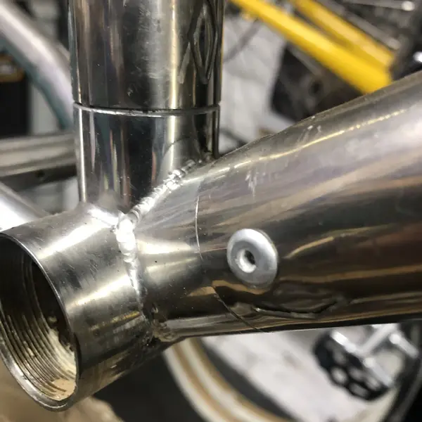

Quick note about this frame, after it started to ease apart on the Cinder track riding South out of Whitby I decided not to ride it again unless I could come up with a suitable repair. Unfortunately as these lugs are Stainless and the tubes Titanium that didn’t give me many options!
What I did do in the end was glue and rivet the tubes & lugs together, not a fix that I’d want to ride on, but I think I’ll be safe enough bolting this to the turbo trainer!

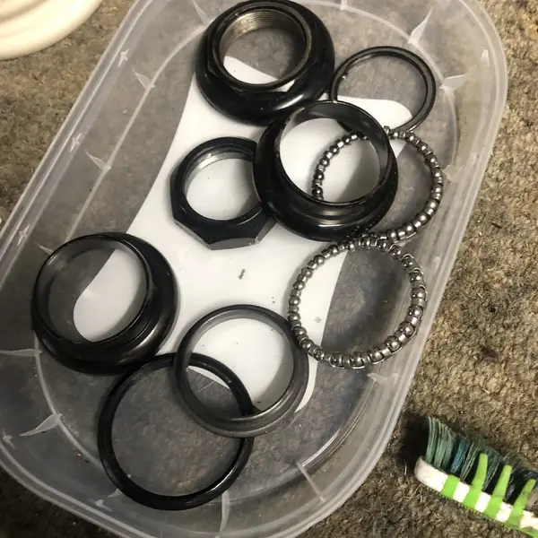

I may not be pulling out all the Peachyfication stops on this one, but there’s still no excuse to not clean and re-grease properly.
9245F0C2-D025-47AD-B21D-FE85EC5BEF25.jpeg D8890FB5-19B7-48C2-B61A-188EB15146E3.jpeg

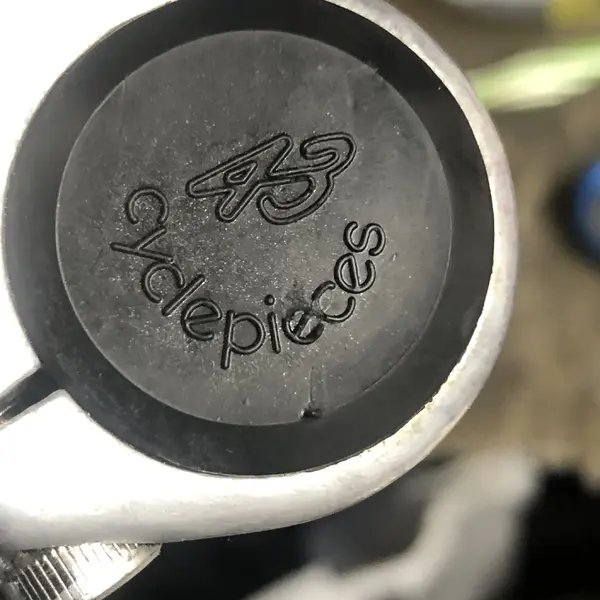

These shocks are bit on the basic side, but just about perfect for a turbo trainer 🤣
Anyone heard of them before? The Sabre graphic is in the same font as the Claud artwork so possibly a CB name rather than the mfr. it also has “43 cyclepieces” embossed in the dust caps. Still a proper clean up, although I’ll pass on re-doing the graphics I think. 5EEF51A5-5A05-4E07-96DF-C62F4581FD9A.jpeg F0AEA3D9-79CF-4366-A5F4-3C6023EFBAA7.jpeg
