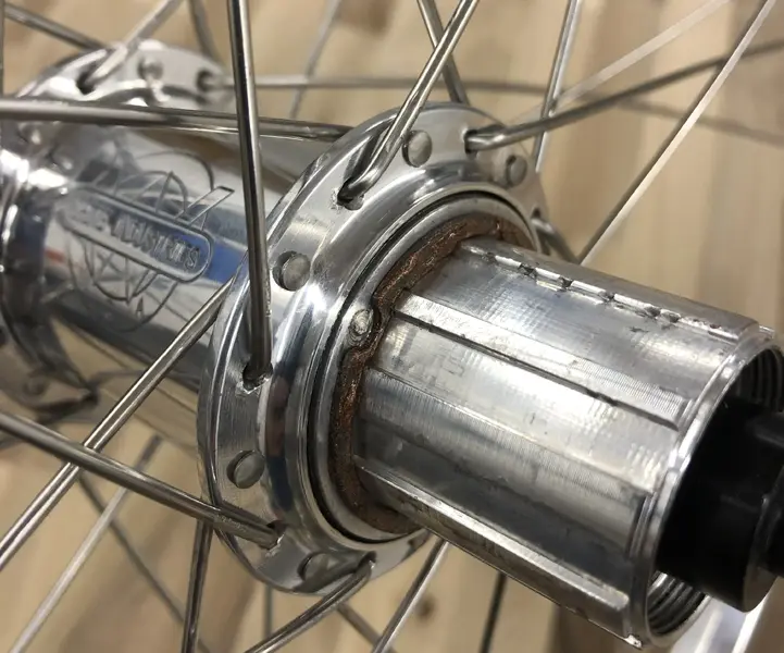

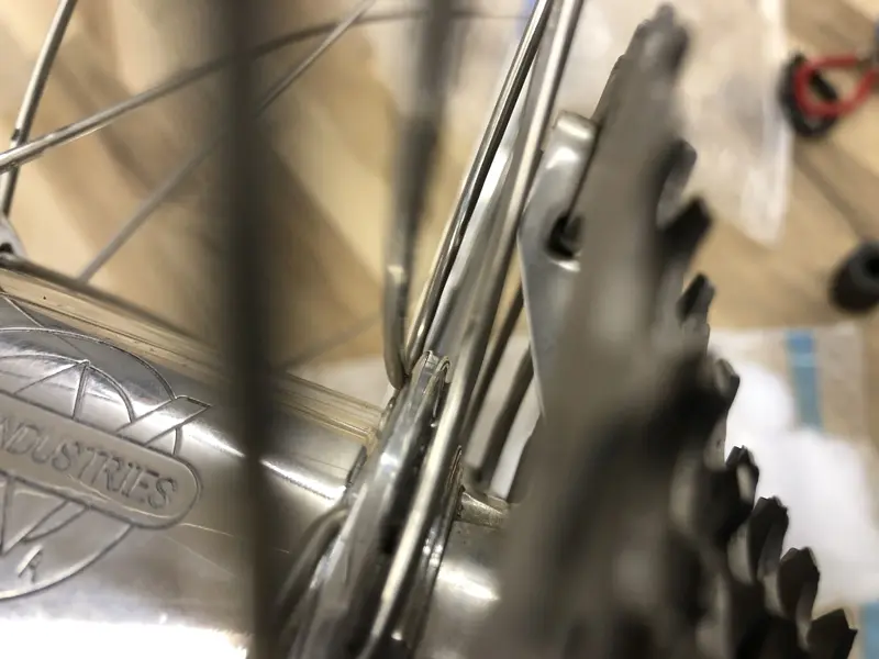

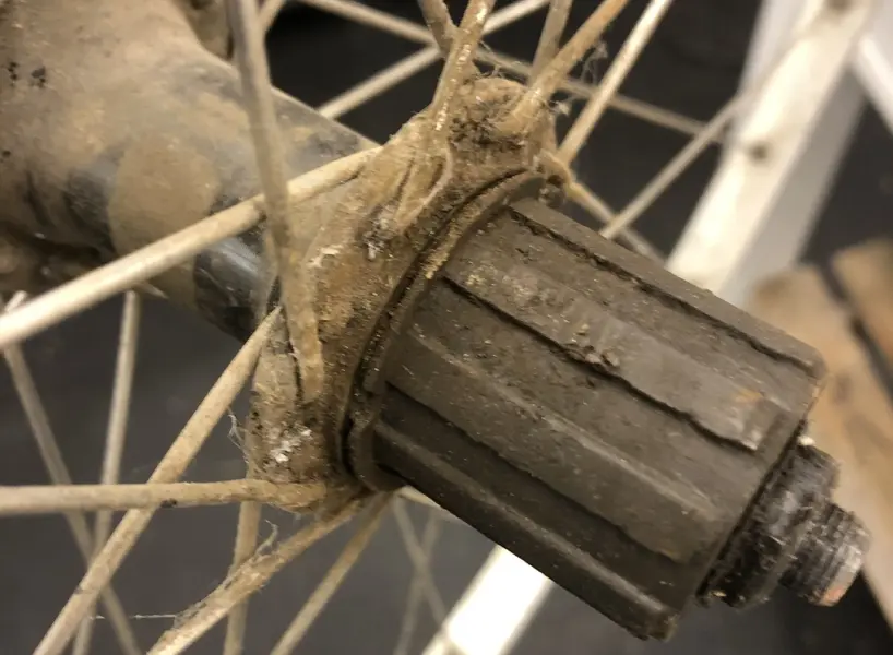

Anyway, back to the build… so, whilst spending a pleasant evening calmly lacing up the Weinmanns, I mused upon the three round scuff marks on the flange of the free hub body… I concluded these must be from the three bolts or rivets that held whatever cassette was once on there..but for why? Maybe someone had attempted to fit a 9 speed on this 8 speed hub and removed the little spacing ring.. now without it, I wasn’t sure if my M900 spider would fit without clashing with the spokes. A dry run (admittedly without the spokes being tensioned) proved I had a problem… :?
So where do you go to get a spacer ring at 9pm? The dirty box of course.. :D :D :D
Not sure what material this is, so a layer of copper grease was carefully applied.
C’est Voila! :cool:

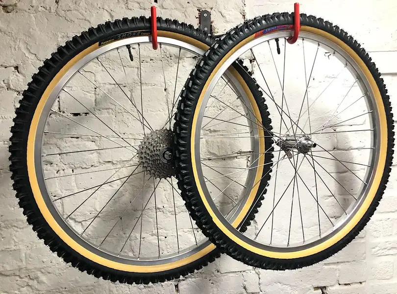

Mrs Peachy & the offspring went out for a walk... time to get busy in the kitchen....
Ingredients for today’s bake....
Fresh out of the oven....
Wall art for a day or two...
That’s 1949g for the rear & 1453g for the front in total....(inc skewers)

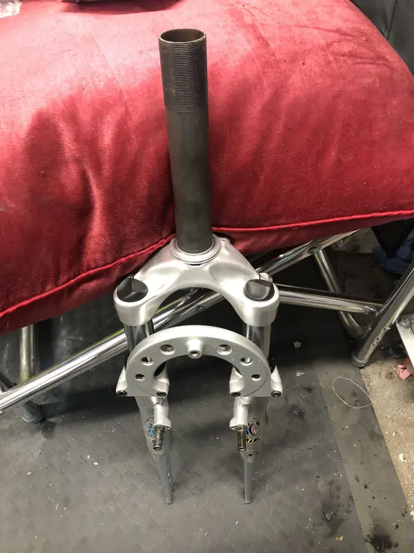

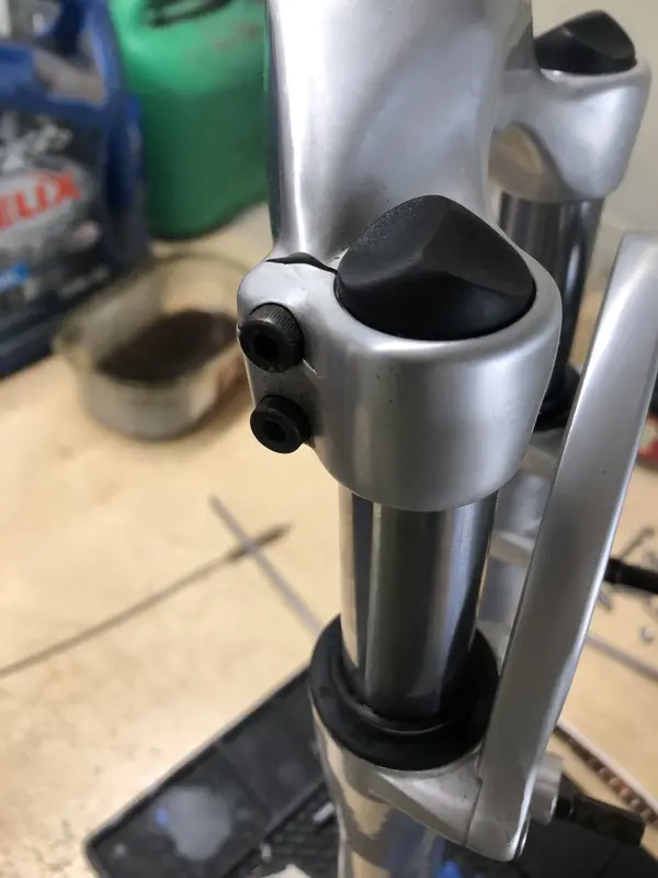

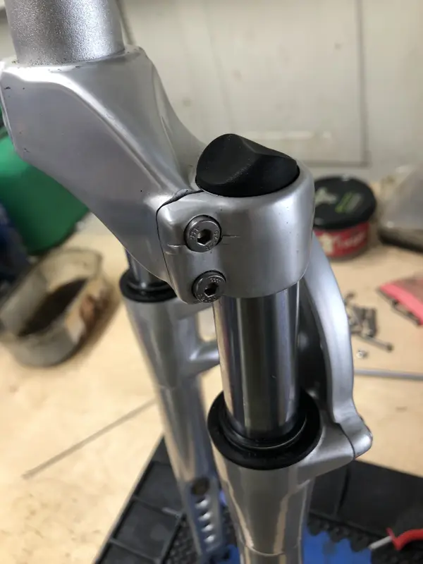

Good day today… the new aluminium steerer tube arrived! :D
These Marzocchi XC600’s from 1994 got a full service a while back, but still needed a detailed tidy up, so after I swapped the old steel threaded tube out for the aluminium thread-less I got on with what I enjoy most.. ;)
The old graphics were shot and although I’ve had a chat with Gill about reproducing them in just black, now I’ve cleaned them off I think I might just leave them bare… swapped some rusty fat headed, self-coloured mild steel bolts for some low profile stainless steel versions, much better… :cool: IMG_6049.webp IMG_6047.webp IMG_6045.webp IMG_6035.webp

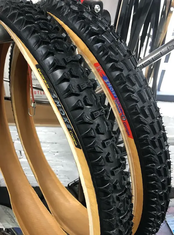

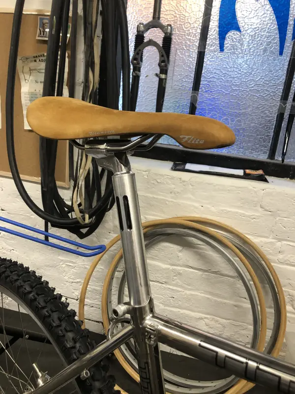

Now I’ve got both wheels on I thought I’d have a muck about with some options…
First to go was the chrome Tioga monolith.. :| nice idea, but just didn’t seem quite stylish enough, so that got swapped out for an aluminium Kalin, slightly newer but with the black flutes and swept back micro adjust, to me it feels like a nod back to an older style.
I first tried this with a Flite Evolution, but the carbon was not the way to go however light it may be… I’m much happier with the tan suede version. :) IMG_6054.webp

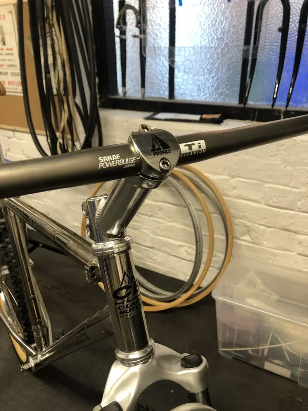

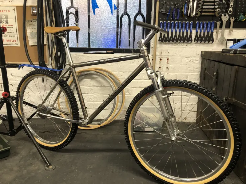

Now then…stem..I just can’t make my mind up..
The Bar was easy, an early 90’s Sakae Power Bulge TI, but then do I go for the welded Aluminium tube ’96 Profile with its extreme rise (this certainly feels more comfortable for me) or the racier looking slightly lower angled hollow cast aluminium from System Components…… TBH, I’m not sure about either… 🤦 IMG_6056.webp IMG_6053.webp IMG_6055.webp

Come together nicely - not sure on the stem with such a steep rise, it then again it’s probably far nice to ride with and kinder on the back

Cheers Spud... any thoughts on a stem?
