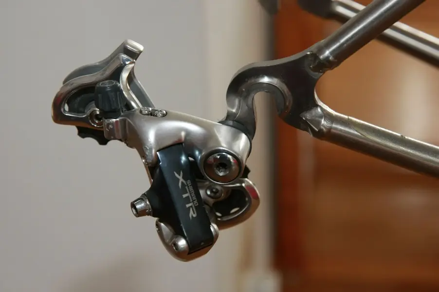

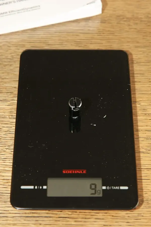

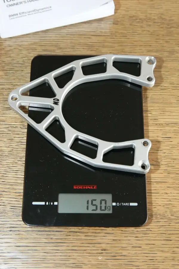

Preparing for some titanium and aluminum hardware to arrive. The non-drive side bolt on the fork was stripped so I needed to use an extractor to back it out. In the picture it doesn't look like much but m5 was too big and m4 slopped around and spun freely. Once that was off I weighed the fork brace / brake booster. I noticed the booster used to be anodized blue/turquoise, so I may need to fix that back to colored in the near future, maybe blue maybe purple. Also found an M5 aluminum screw that fits perfectly to hold on the brake cable stopper.
I pulled off the blue pulley wheel from the rear derailleur, replaced with the original then pulled the rear derailleur off to make room for something different which is arriving soon. Goodbye m900, have fun on the Klein Attitude.
...and I bought a new scale that will read out 0.1g increments because the one I have been using is wandering even after replacing the battery so I am certain my measurements are off. I can put on a given bolt for example, with an arbitrary weight of 5 grams and over the course of two minutes watch the weight increase almost 80 %.
