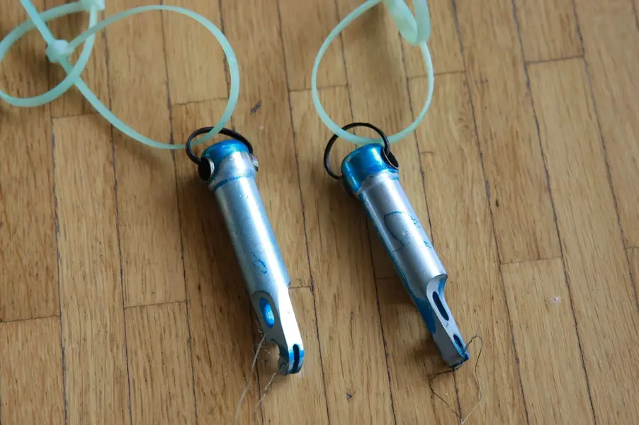

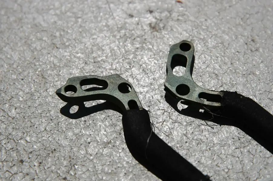

I think at this point in time with my fourth attempt of anodizing the brake lever parts (a blue this time). As you (all) can see in the photo here, the blue is very muted, very dull. Me thinks the anodization time needs to be reduced OR the anodization bath is too contaminated to move forward OR I am pushing too many volts through the parts. Does the blue look "dull" or "opaque" to you (or anyone else)? Ahhh! Or, this finish is considered "patchy" which may be due to fluctuating voltage during the anodization bath. Man...titanium is so much easier...
Edit: I am also thinking too with all my anodizing lately that the chemicals in the foam from these Rachas have leached out and mixed with my solution compounding the unstable and problematic state if the anodization adhering to the metal surface. Thinking out loud primarily here too. I need to add this to my thread to maybe help out the next guy who tries to do similar stuff in his kitchen :LOL: . At any rate, I want to cut off these foams but not unless I have some kind of replacement!
Anywho, do you happen to know where to find similar foam grips to these old Kooka's? I am tempted to cut them off completely and put on something similar and new if possible.

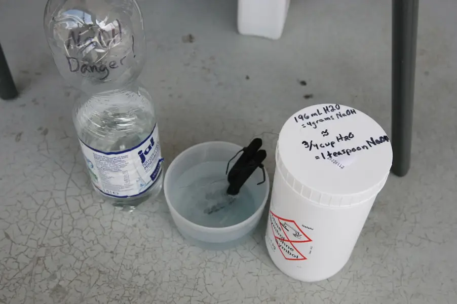

This morning I got a hold of a kg of Sodium Hydroxide (NaOH) to use as an alternative etch for aluminum ONLY. I must say that after an initial etch without surface preparation or degreasing, the coloring of the etch looks promising. Hard to tell in the photos but there is a slightly yellowing hue to the surface of the aluminum, which is consistent with manuals and online resources of what one should expect when etching.
Furthermore, I can save the more aggressive acids for titanium anodization specifically.
As said, these pictures are a trial run of the NaOH solution. As you can see in the close up there is some spottiness to the aluminum surface. To circumvent this I will do a series of steel wool and scotch brite pads to prep the surface, before degreasing then the etch again. Not going to happen though for a few days as its the weekend and family time!

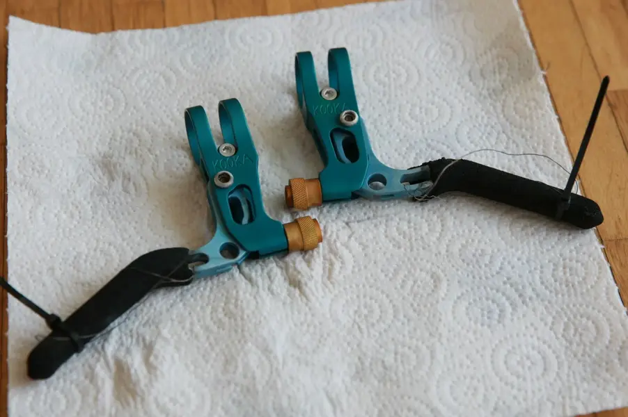

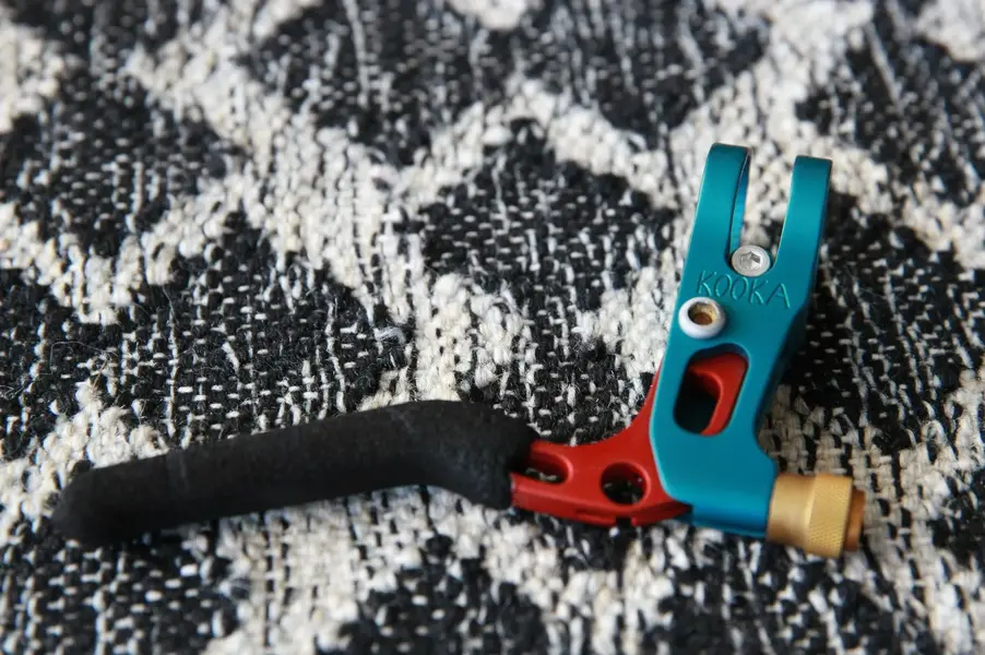

These brake levers just about drove me nuts. Just to get the red color took about 15 hours. Based off of a few posts above I have concluded that the anodization solution was too tainted to move forward. I had to replace that this afternoon AFTER another failed attempt I tried this morning. Another issue was the voltage. I was setting the voltage a bit too high. Dialed down to 8V rather than 12V. Increased the amperage to 3 and let the digital display tell me when PAR was reached (about an hour in the anodization solution @ 0.137A ).
The big tell is when the part is placed in the dye. Either the dye uptakes immediately or not. Slow simmer on the stove for about 15 minutes, distill water pre-rinse then into a water pot of boiling water for 15 minutes.
The color isn't as vibrant as I want, but is consistent with the vibrancy of the gold and the green. All in all the coloring is pretty uniform and I am happy with the results. To do list: either make the bushings that dissolved in the acid or order them online from the company recommended above by @Dr Dremel . Lastly, I need to replace the grips as one is pretty chewed up and now they are impregnated with red dye and @Star12 is being kind enough to help me locate some! There are these too, but seems rather expensive for a little bit of foam: https://www.ebay.com/itm/175656352766

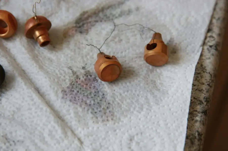

This morning I 'tried' to anodize brake parts to the SRP's. All was well up until the anodization bath where the amps were looking ace, but then shot up from 0.4 to 1.6. Something was wrong, but I let the process continue in an attempt to save whatever happened to anodize. After stopping the process, two pieces looked to have lost or intermittently had voltage. You can see this in the photos.
All in all, these parts will need to be redone! They look like hell. Another thing too is that I am seeing the gold dye deposit to the bottom of my pot during the color application process rather than suspend in the water, so I'll have to see what's going on there too. Maybe the pot sucks, my processes are sucking for sure, and maybe I have a so-so batch of gold dye (but the Kooka parts anodized awesome).

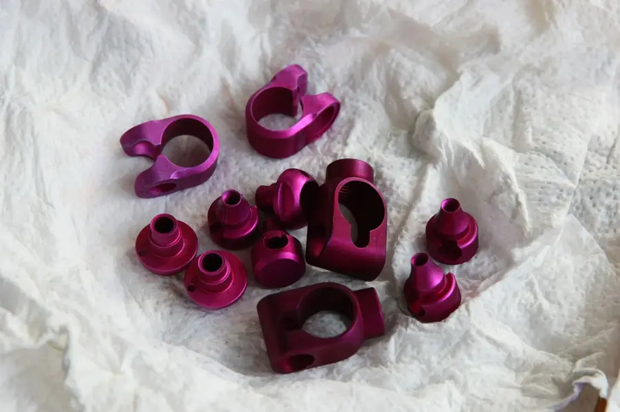

SRP brake parts 2.0, 2.1 & 2.2 (trying gold again, problems then purple)
After attempting gold again, and a few physical reaction happening, I determined the mixture of gold is off. I went for a last try and noticed that while the gold dye solution as heated, the water was stratifying and the dye particles where bonding then sinking to the bottom of the pot. I wanted to do Turquoise and Gold for the brakes, but that's not going to pan out at this juncture.
Rather, I went with 3DV for the auxiliary brake hardware shown here. Yet, there is one of those pieces giving me the run around. It just will not anodize no matter what I try. If I cannot get it purple today in one more try, I'm just going to color it in with a sharpie :LOL: .

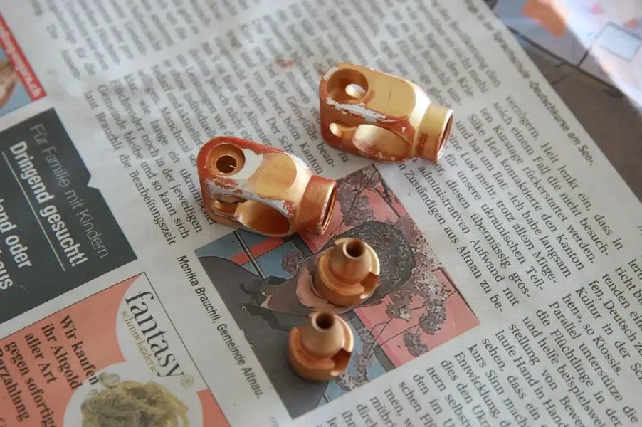

Prep work: 320 grit wet sand and coarse scotch brite
Patchy gold adhesion
