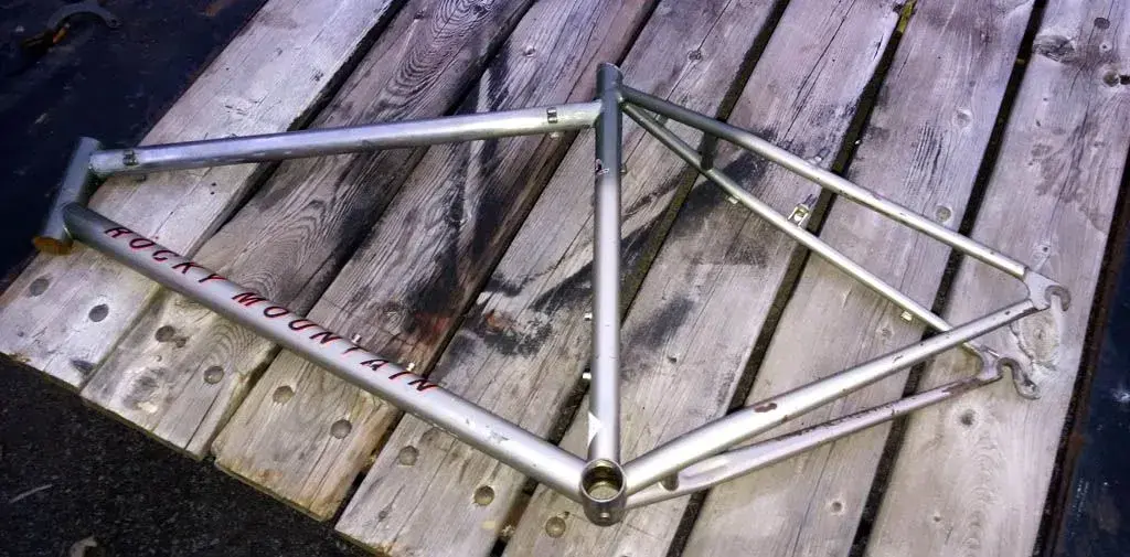

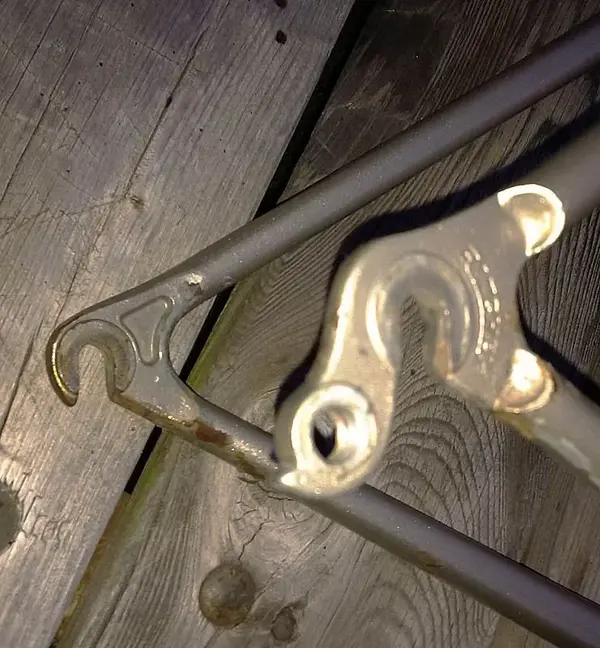

I picked up a 1994 Altitude frame from another Canadian member here on the site and I'm embarking on a kinda/sorta restoration. It's a little rough around the edges and I'm not going to do anything irreversible so I don't feel too guilty ;).
Plan is for a full cosmetic restoration of the frame with a retro-ish SS build.
I have a few questions regarding the restoration, some of you are already helping me in another headset bearing thread, but it makes sense to compile all my silly questions into one thread :)
Cheers, Ted

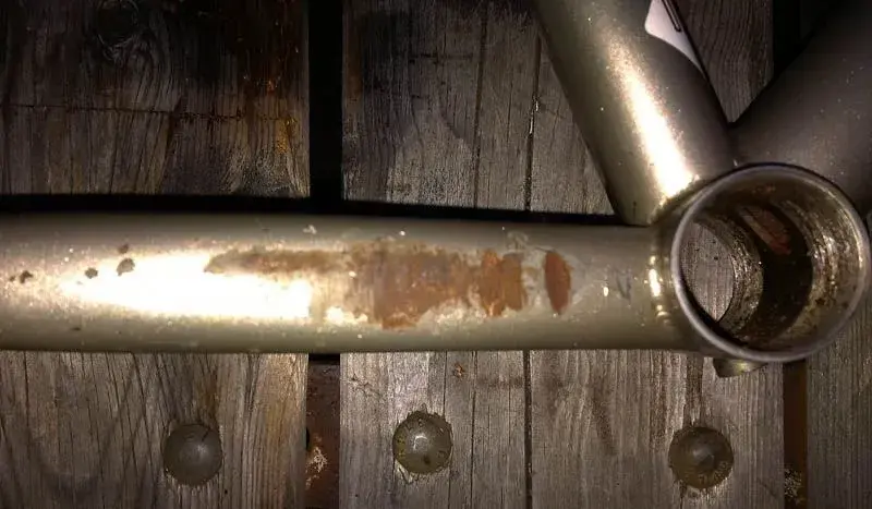

The top tube has a bunch of rust flakes rattling around in it.
Is it advisable to drill a hole through the inside of the head tube to allow treatment with some phosphoric acid based rust converter and a good soaking with Boeshield or Framesaver?
Cheers, Ted
is there not a hole inside the headtube for both the top and down tube? from the frame i've owned that i've noticed, they've always had holes.
Re: Re:
There didn't appear to be one at first glance, I'll look a little closer in the morning, BB shell has holes for the seat and downtube.

I was mistaken, there is a tiny (1/8"?) hole in the headtube going into the toptube.
Should I attempt to enlarge it to get the rust flakes out? Or should I just snake a little tube through and blast it with some Boeshield?
