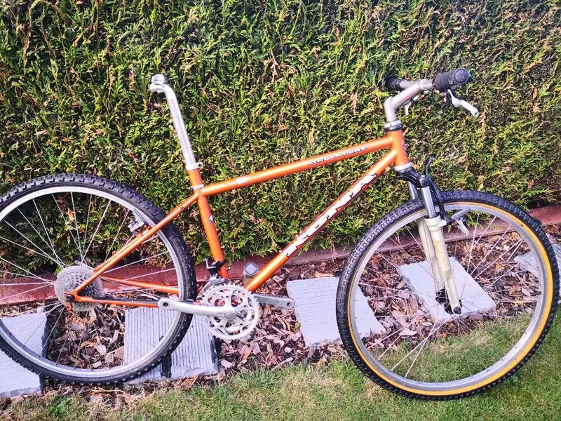

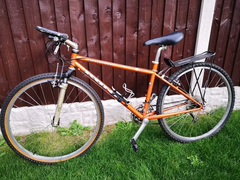

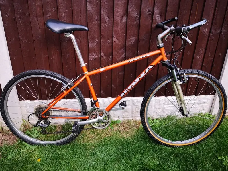

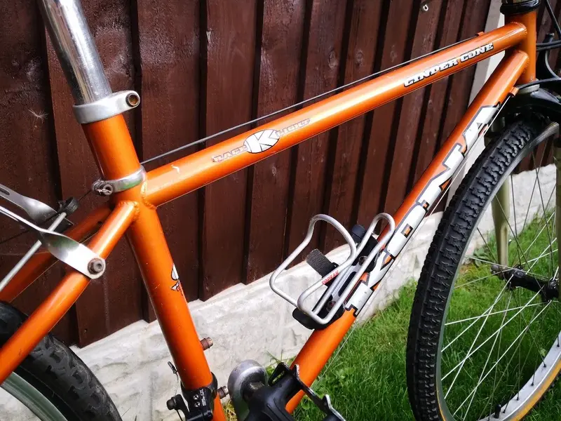

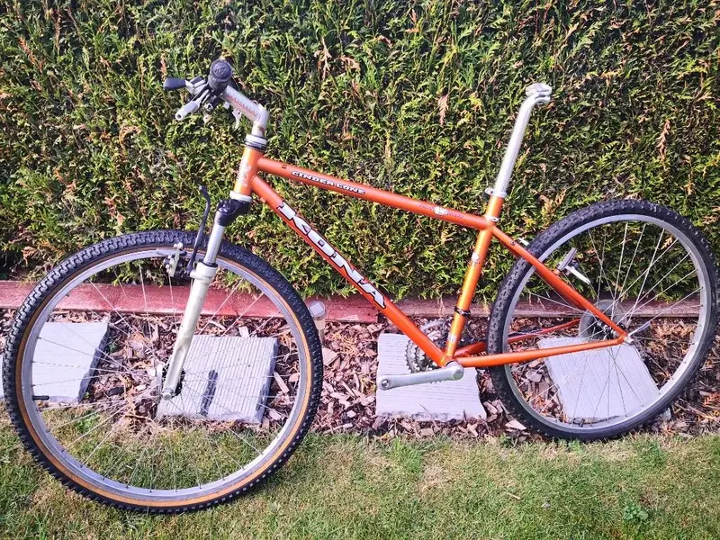

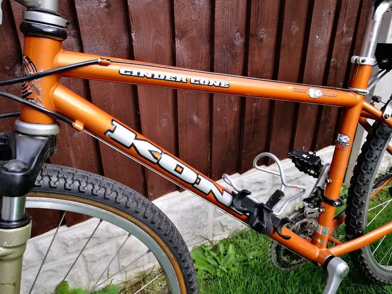

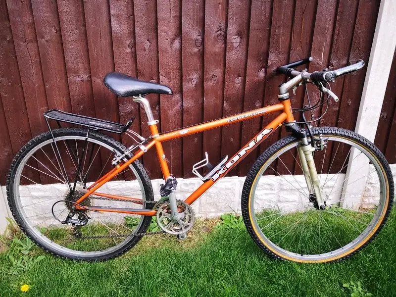

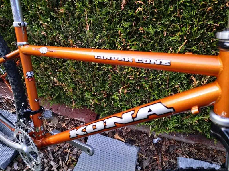

A few pictures last is with shock pumped to 50 psi and crap taken off and tinkered with needs a full clean degrease and cable's. Thinking this might be too small as I have 18/19 inch Kona's with me being 5ft 10 inch.

davo77":1operzr7 said:
.....Thinking this might be too small as I have 18/19 inch Kona's with me being 5ft 10 inch.
Your Cinder Cone frame is a size 16", which is a little small for someone your height. It is a lovely example though.

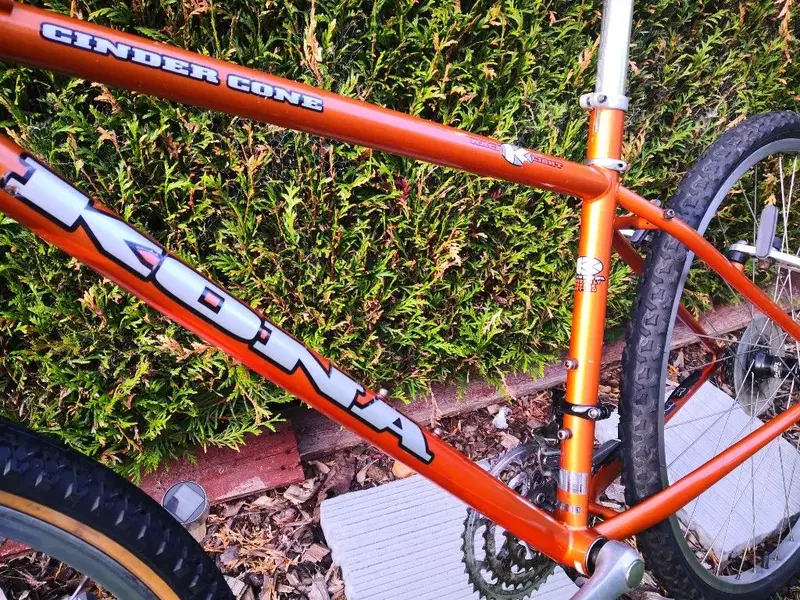

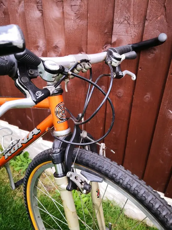

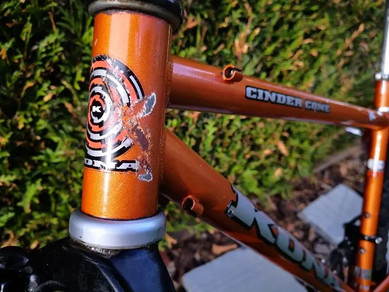

A little update fork's are holding pressure at 50psi which is good and she's had an initial clean and have started taking parts off. The worst damage is on head tube due to cable rub.
