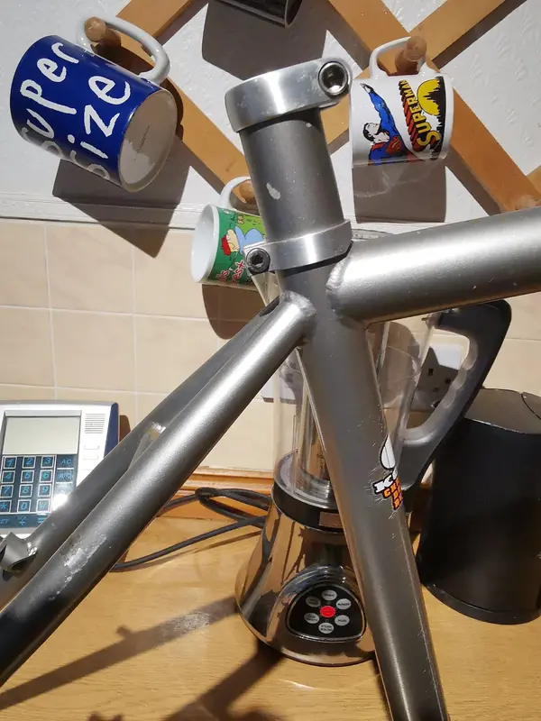

I was on my daily hunt for a Kona for the sanctuary and this nice looking Kona popped up and saying it was a Kona i bought it lol
It was advertised as a Cindercone with a limited description basically saying, Cindercone,97 ish and something what caught my attention "it makes a lovely ting when you flick the tubes" 🤔
Another thing what caught my eye was it had no pannier bosses on the seatstays not very Cindercone really but i don't really know alot about 97 bikes so maybe they didn't have them.
Now it's arrived and i've had a good look at it i'm thinking is it really a Cindercone and could it be something else, something alot better 🤔
Firstly it's clearly been resprayed and those decals i think are 94/95.

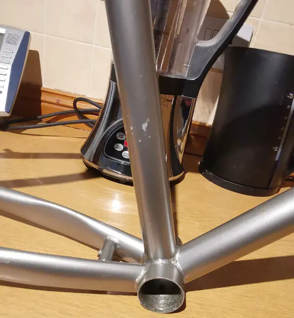

Seatube where it attaches to the bb,there's no flare or bulge like standard Kona tubes and Tange Prestige,looks almost straight. I'm going to get the micrometers on the tubes though for measurements.

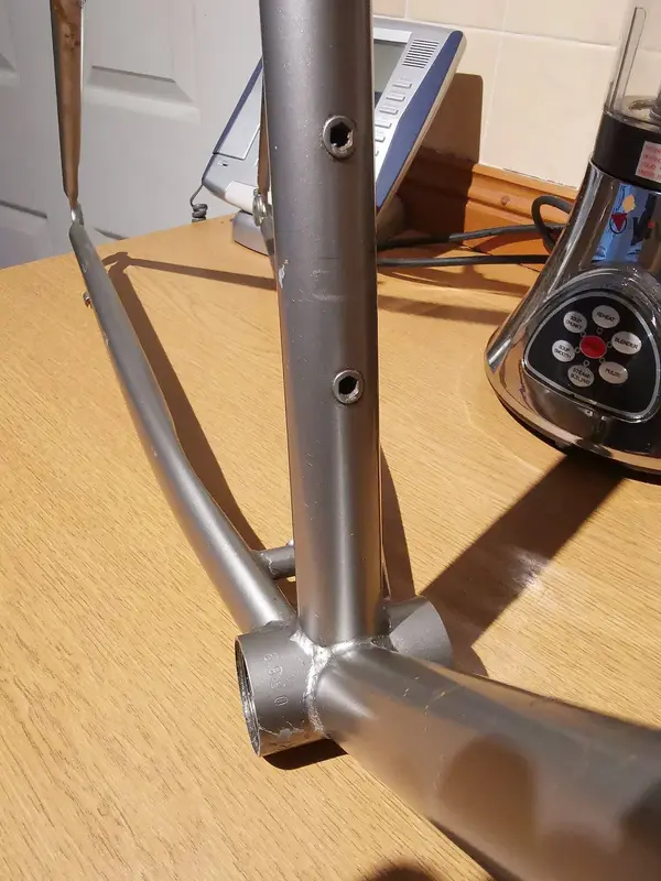

Back to those seatstays, there's no bosses and it doesnt look like they've been ground off and the hole filled, also why would you go to those lengths on a Cindercone🤷‍♂️

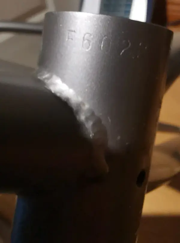

Next serial number or should i say numbers because there's another one on the top of the bb aswell as underneath where they normally are.
The one on the top reads KBI0569🤷‍♂️ and the normal serial number is F6022965.
I've never been any good at deciphering those things so any help from you Kona experts out there will be a great help, does the 6 mean 96?

Hi, the S/N indicates that it was made in Taiwan in Feb '96 (F for Fairly which was one of the two Taiwanese factories Kona used at the time, 6 for 96 and 02 for Feb), putting it in the middle of production for the '96 model year. It can't be an Explosif, because they were used Columbus tubes that were very clearly ovalized which your frame does not have. It's not a Hot because they were US made with a very different S/N format. The best it could be is a Kilauea, but I'm not sure why it would then be stickered up as a lesser frame. Most likely is a 96 Cinder Cone which had the rack mounts removed when it was repainted. Of course, with old Konas there always seem to be bikes that don't seem to fit in, and that second S/N is a mystery. The weight may give the best indication, the catalog gives a frame weight of 4.5 pounds for the Cinder Cone but it would be more for a larger frame like that.

Yeah definitely not a 96 Explosif with that having Max tubing, done some sleuthing and found this old post of a resto on a 96 Kilauea,the seatube at the bb looks similar,i'm trying to find a photo of the seatube on the 96 Cindercone to compare and see if that's flared or straight like this.

Tube quality sounds like Cindy or better, but why would you misbadge to a lower quality, so its probably a Cindercone.
I think they forgot to do the top rack mount holes - fitter popped out for a fag.
Friday afternoon.
Quality Control dude gone home early.
Frame's gone to the paint shop...
We've all been there.
Just looked at my 96 Kilauea and 96 Cinder Cone. Both have rack mounts and the dropouts look identical (to each other and your pic above). Both bikes have 27mm seatposts too. Seat posts seem straight on both frames. To be honest if it wasn’t for the colour/name on the frame, I’d have a hard job telling what ones what just from looking.

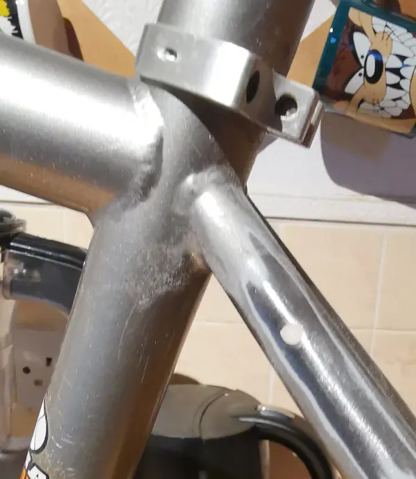

I did a bit of sanding on the seatstays and it turns out it did have rack mounts, which makes me wonder why you would go to that trouble and cost on a Cindercone 🤷‍♂️ i could understand if it was an Explosif or Kilauea that's just my opinion though.
