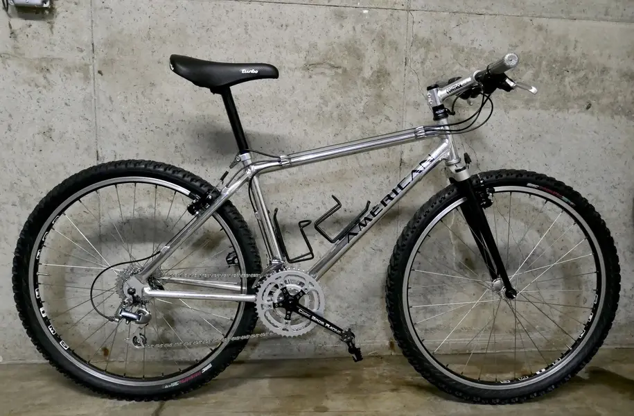

Finished mine last week too! Just need Panos to complete the Trio of Americans!!
I was working on mine yesterday but I am still far from seeing the end of it.
