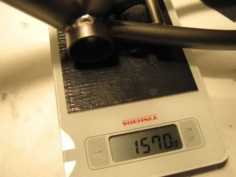

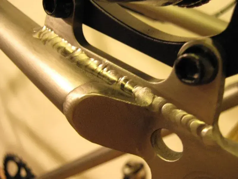

Frame
Naked finished frame after the disk tab comes in at 1570 grams. It's a 19" for reference.
The welding job is solid and satisfactory; not your small tidy welds from Lynsky but neither a botched job. It's all straight and true.

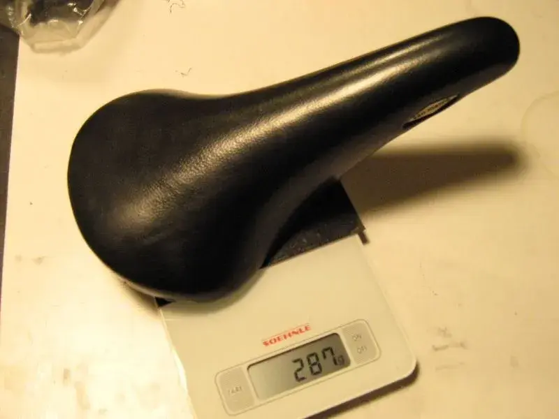

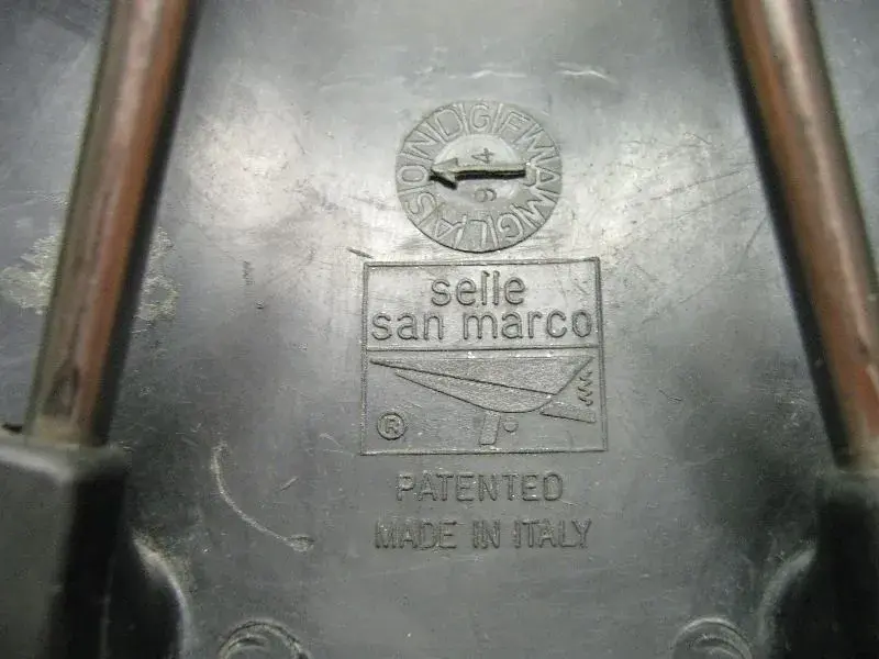

Saddle
Icing on the cake is a very retro 1994 San Marco Rolls Titanio. It's gone through it's seasonal refurbishment with a black marker pen, black shoe polish and a few coatings of horse saddle oil to protect the leather.
287 grams.

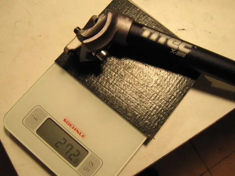

Seatpost
Titec X-Wing 27.2mm 330mm. Very solid and a good off-set for the Rolls. 272 grams.

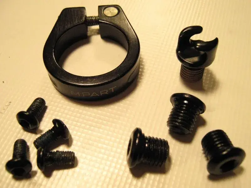

Small Bits / Finishing Kit
New sets of brake cables and gear cable. Total weight is 113 + 47 = 160 grams.
Frame blanking bolts, cable guide, bottle cage screws and seat-post clamp. Since the picture, I changed my mind about the seat-post clamp and used a beefier simpler one. Total weight is 36 grams.

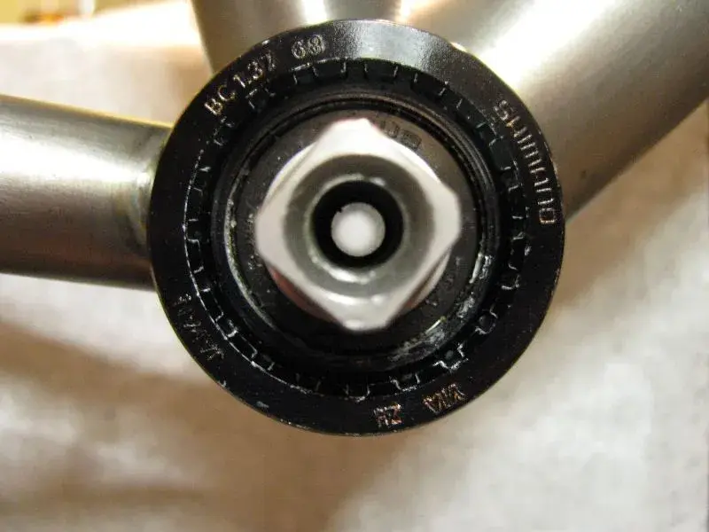

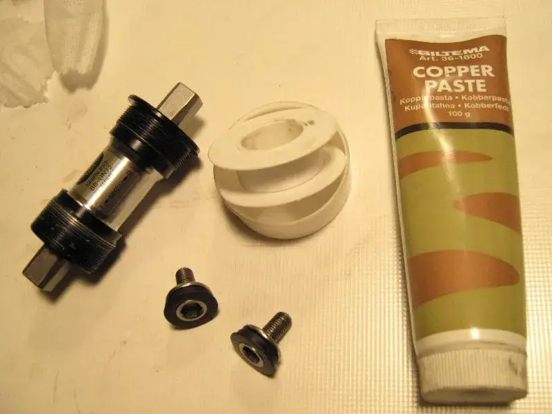

Bottom Bracket
Lightly used UN72 68/107mm. A few lashings of Teflon tape and heaps of Copper Paste keeps it firm and weather proof. I routinely drill off the stupid useless pressed on washer on the drive side axle. BTW: I don't grease the tapers a few squirts of WD40 only. 239 grams.

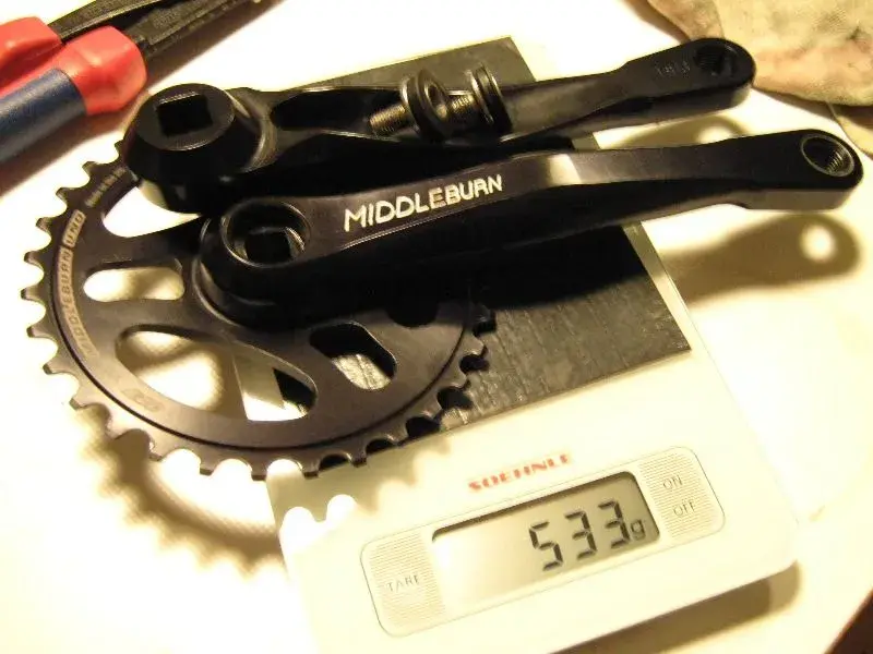

Cranks
Mandatory Middleburns. RS7 with Uno 3/3" 32 tooth ring. Shimano bog standard BB bolts. Total is 533 grams.
