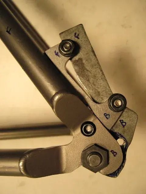

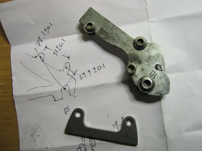

Just finished the disk tab jig.
(I hear distant sounds of some RBers preparing the gallows at this very moment).
Anyhow, the jig is made out of an old headset / multi-tool spanner. I know it doesn't look much, but it was an utter sod to make; the steel was so hard I've damaged 4 drill bits and blunted a hacksaw blade to buggery. Luckily I've got a couple of new hacksaw blades spare and a nice new set of quality files from Bahco to start work on the disk tab "hand machining".

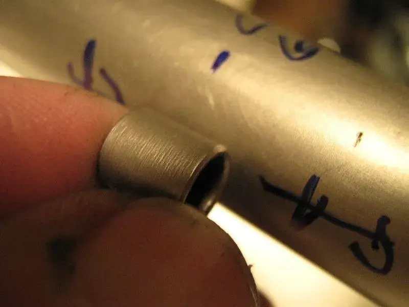

Disk tab finished, cable guide off and frame marked up ready for a chap who is rather usefull with a bunsen burner.
