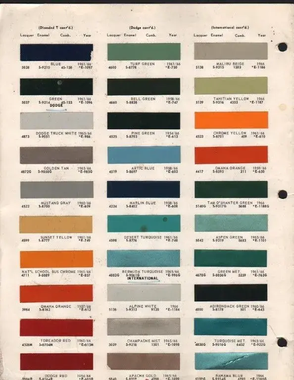

During my search for colour codes I came across this gem (below) from way back when, which has the colour swatch on it for Desert Turquoise (RAL code 5018) and universally accepted as the being the colour that John Parker used on the team bikes, http://yetifan.com/YETI_PAST/yeti_past.html

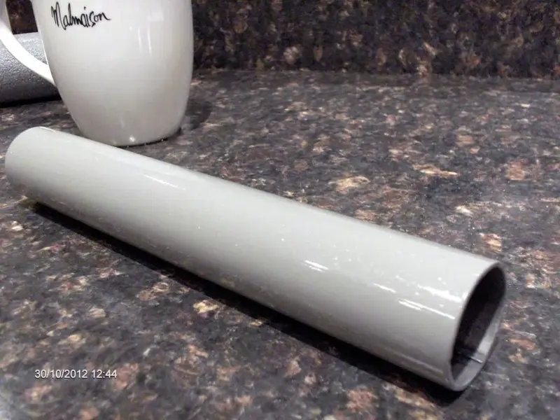

To be honest I don't know the answer to that one ^^ I suspect they didn't, they were after all just a tool to do a job with, and not intended to court punters into opening their wallets.
Having seen the grey on a sample tube the shop sprayed up I was (if I'm honest) more than a little underwhelmed with what looked like "Battleship Grey" and seriously considered going down the road of Yellow and Turquoise.
The Garry in the paint shop (Argos in Bristol) talked me round by convincing me into having a very subtle metallic flake on top, which they'd apply at the clear coat stage, I obviously was totally won over as they told me to wait a week and they'd do me a sample (as seen below)
The clear coat flake was only applied to the Grey areas and no where else prior to the graphics being applied which is cool as I didn't want to change the shade of the black darts or Turquoise by lifting them with a silver flake, and then the whole frame was clear coated with a proper clear (clear) coat.

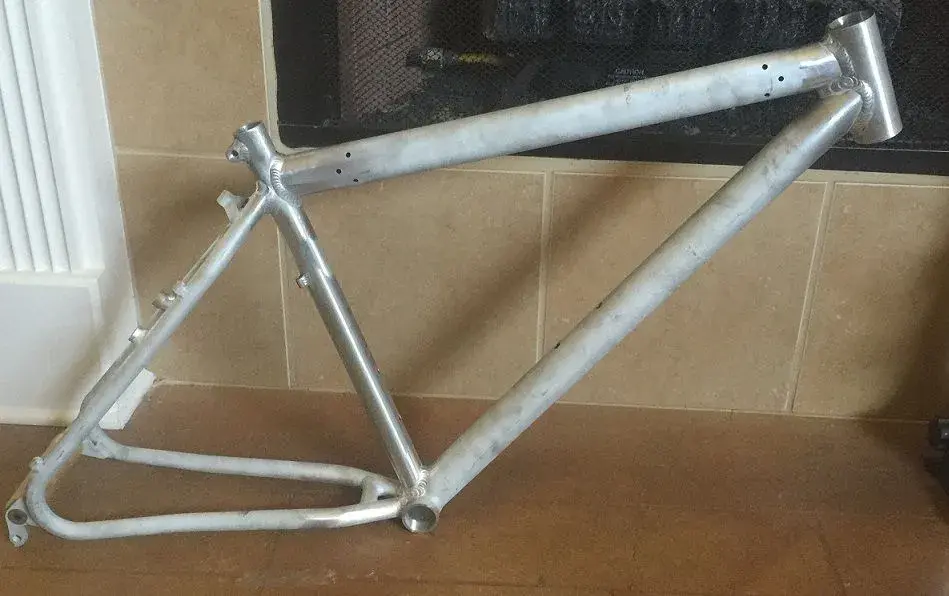

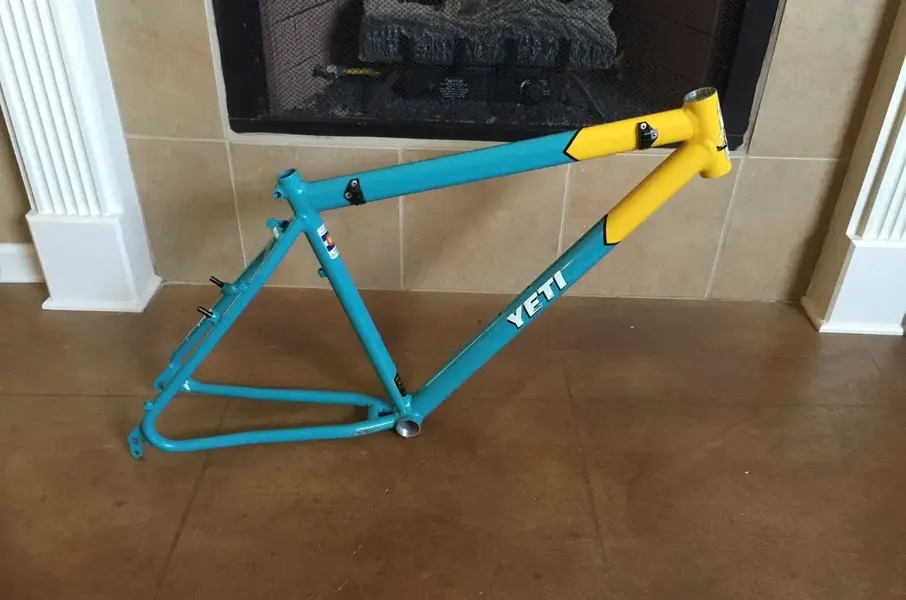

Thanks Spud, but not my frame. It was a pic I found of a grey from an original frame. My frame is more of a mid/late 90's and had some cracks. I finally got it fix by 'the Man' (FTW) and now looking to get it re-done.

The Yeti ARC "grey" isn't paint or powder. It's the raw material that's been beadblasted and then clearcoated. The "flake" that you're referring to is the metal coming through. Too hard of a beadblast = too much flake = too sparkly. The Pro FROs that were grey were powder coated, although I'm not sure what color.
