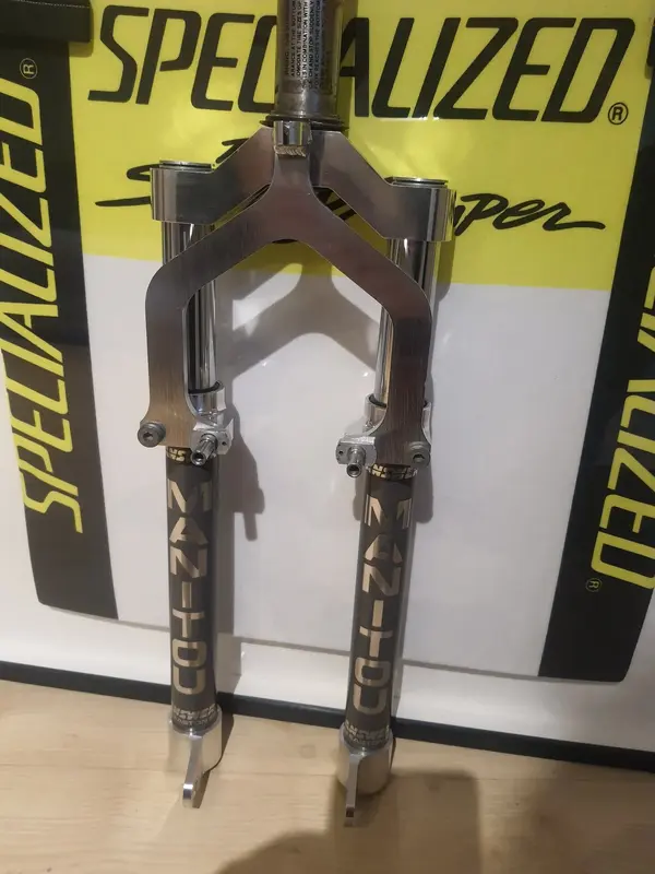

I mentioned before the Manitous are hopefully just a temporary measure as I would eventually like Accutrax. Still the elastomers were shot so the forks needed a bit of attention. New elastomers from @johndeverill duly fitted. They do need to come apart again as the wipers also need replacing. Whilst they were apart I gave them a clean up. They have quite a lot of nice machining marks on them so as not to remove those I have litterrally just hand polished rather than starting with the wet and dry like I normally would. It's been probably 30 years since I've had a brand new pair in my hands but I seem to recall they were not super super shiny when new so I may have gone too far already. I certainly recall you could see the metal grain in the brace. Still for now I'm pretty happy with how they turned out. In the long run I will probably swap these over for the ones on my CR7 to save rebuilding those as well.

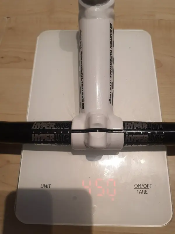

Small update the stem is back from the powder coaters. Not that impressed with the finish to be honest but I suppose it was fairly cheap to have done. Some new decals from Gil are now fitted and it looks OK as the decals hide quite a bit. Hopefully one day I will get a proper Yeti stem and forks from FTW anyway. I forgot to order a ti bolt for the handlebar clamp so will get that done and fit the ti expander bolt as well. Every little helps as they say.

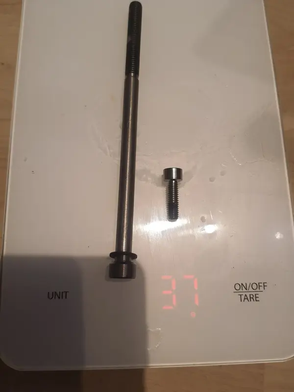

It's all about the marginal gains. Not so sure about that but for anyone interested swapping the steel expander bolt and handlebar clamp for Ti on the Atac stem have saved a whopping 18 grams, yes that is a tongue in cheek comment. Still this being a dream bike of mine back in the day I want to make it as close as possible as to how I would have had it. Being young and living at home in the early 90s, plus getting parts at trade prices helped, meant I wouldn't have thought twice about spending money on all sorts of ELS.
Weight for the stem and uncut Hyperlites is now bang on 450 grams. Sure I could get a lighter combo but aside from a Yeti/FTW stem I don't think there is anything much more fitting for an Ultimate than a Atac and Hyper/Taperlites.

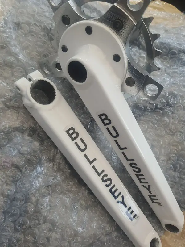

I've done a deal with another member for a Bullseye BB and some more Ti bling so next up to get the cranks powder coated whilst I wait for those to arrive. Then we can start getting this built up properly.

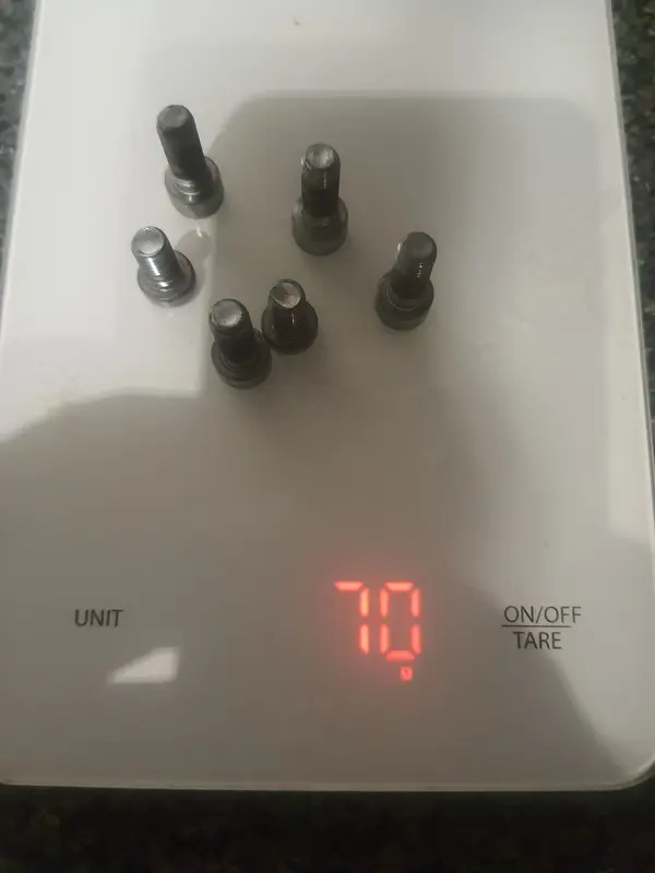

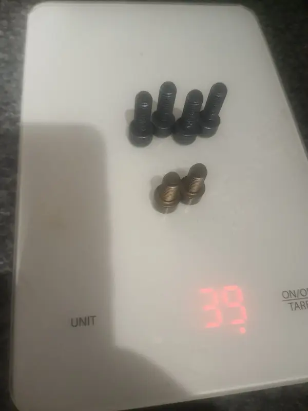

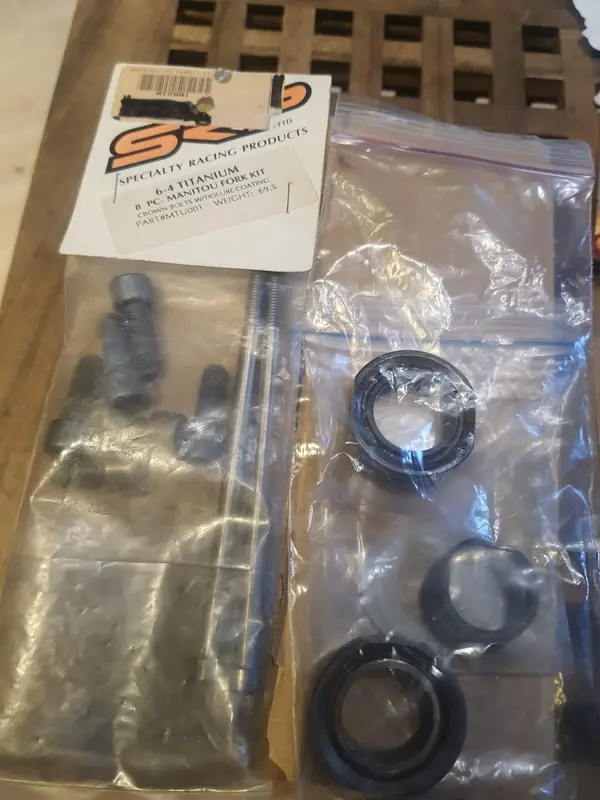

Some more bits have arrived. Thanks to @Tomato for sorting me out with a nos Bullseye BB and SRP Mani 1 bolt kit, much appreciated.
I couldn't face stripping the forks this evening to fit the bolts that go through the elastomer stack, I may as well wait until I fit some new seals anyway. However a quick swap of the crown and brace bolts gives a 31 gram saving but hey its SRP which is super cool so that's the main thing right 😎. Comparison pics in thumbnails for anyone interested.
I am now tempted to see if I can get a ti steerer.There is a seller on ebay but unfortunately they dont seem to have any 1" 1/4 left. Still I may enquire as that could save a chunk of weight out the forks.
Now I've sorted a BB I can get the cranks mounted and see what I need spacer wise. Those are the remaining parts I need before I have a complete crankset ready to fit.

The cranks have been back from the powder coaters for a while, again not overly impressed with the finish like the stem. I have silver rings currently but I'm thinking black may look better so will have a look what I have spare.

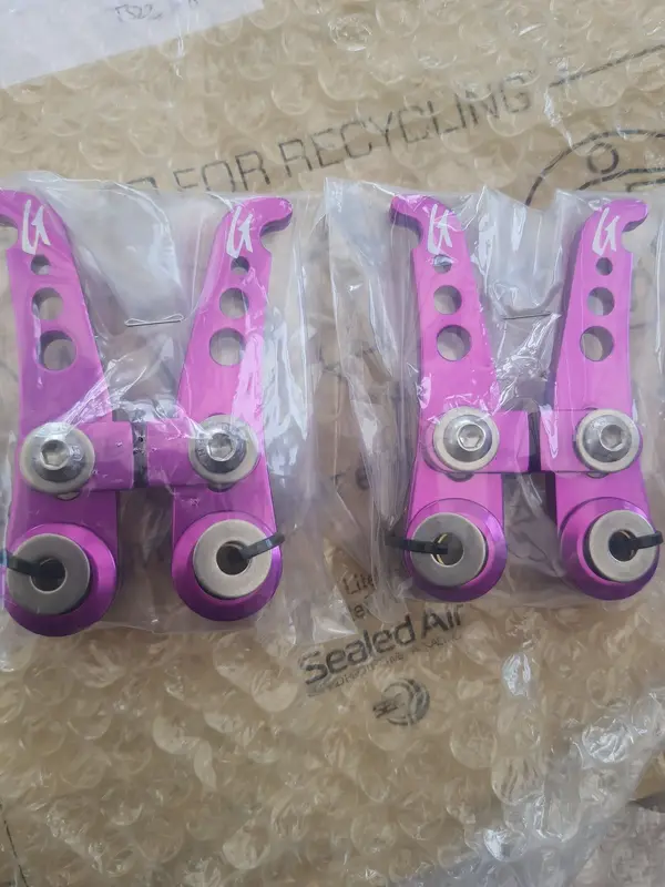

The original plan had been to fit some Critical Racing cantis as I already had those. However on reflection, to me at least, they were possibly a bit new for an Ultimate so that left one choice. A few emails to John Grafton later and these turned up super quick.
