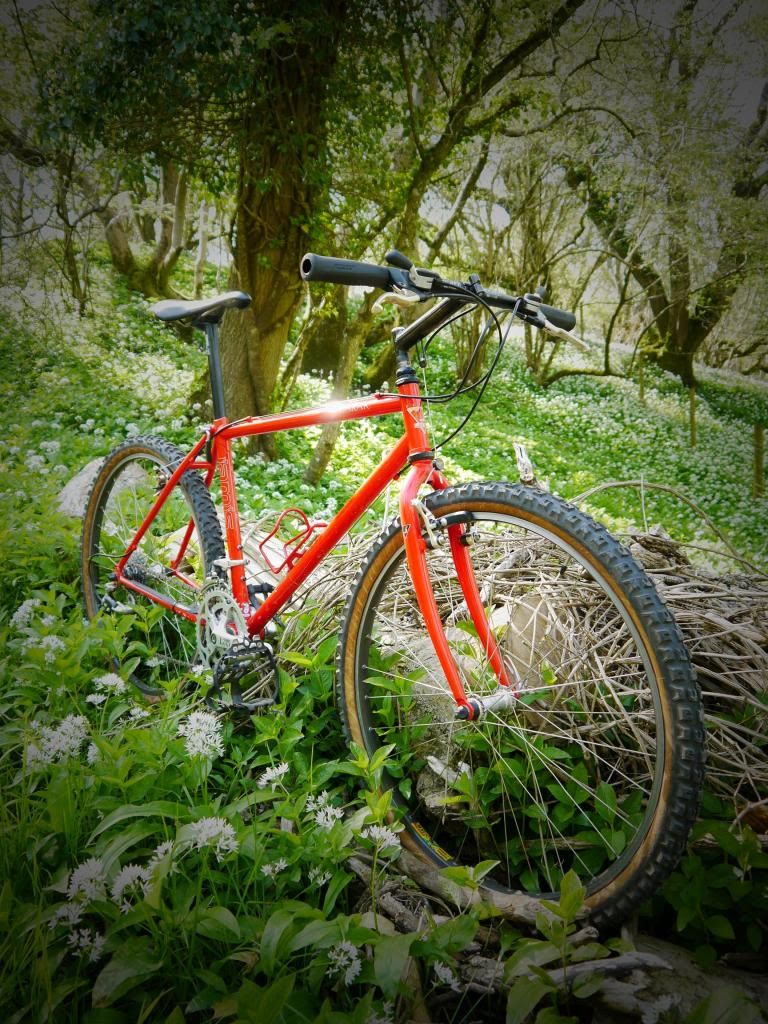

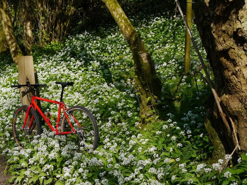

This is now completely finished, and I've been on a couple of good shake-down rides on it.
I'm really pleased with how it rides. It doesn't feel too small for me at all (maybe the 150mm stem helps!).
I had to take it steady as it's still less than 10 weeks since I badly bust my wrist, but I'm looking forward to riding it harder as my fitness returns.
Some pics from its first outing....
The finished spec is as follows...
Frame: Jamis Dakar. Ritchey Logic tubing, built for Jamis by Serotta
Fork: Ritchey Logic
Headset: Ritchey Logic 1" threaded
Stem: Ritchey
Handlebar: Ritchey
Grips: Ritchey
Brakes: XT M737
Brake Pads: XT
Brake Cables: Shimano
Cantilever cable hangers: Onza
Brake Levers: Ritchey Logic
Shifters: XT thumbies
Front Derailleur: M738
Rear Derailleur: M737
Derailleur Cables: Shimano
Cassette: M737
Chain: SRAM
Cranks: Ritchey Logic
Crank Bolts:
Chainrings: Ritchey
Chainring bolts: Yes
Bottom Bracket: Shimano
Pedals: Tioga Surefoot
Rims: Mavic M231CD
Hubs: M737
Nipples: Yes please!
Spokes: Yep
Tyres: Conti Cross Country
Tubes: Conti
Saddle: Flight Titanium
Seatpost: XT M730
Seatpost Binder: Cheap :roll:
Weight: 20.5lbs, on my luggage scales :D
