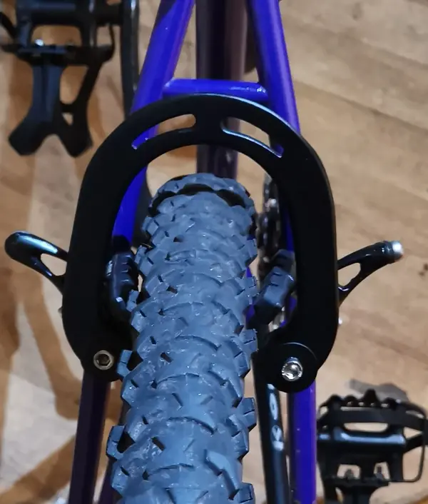

Quite a bit of progress done today with a minor disaster along the way, stupid plastic shimano bottom bracket what a stupid design lol

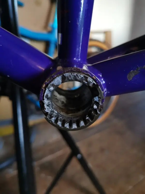

So the horseshoe has been resprayed and is looking good again. Bottom bracket was fitted then tightening the non driveside plastic cup disaster, with no warning the teeth sheered off 🤬 So half an hour of faffing around and it came back out with no damage to the threads phew lol This time i used the metal version and in it went no problem, note to self never use plastic ones because they're crap.

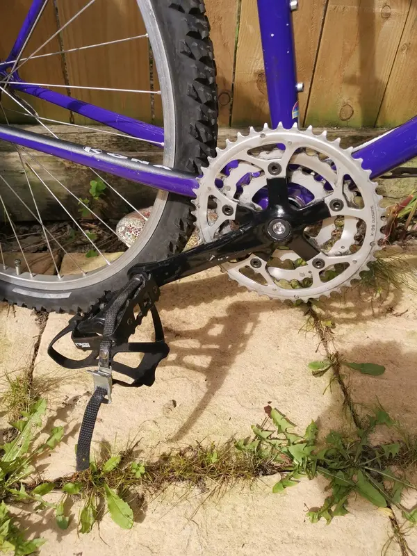

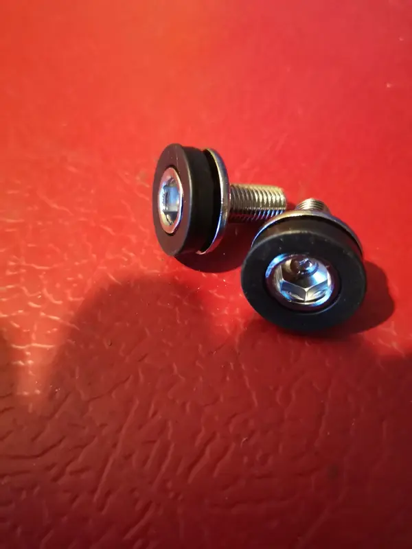

On went the chainset with new crank bolts, gonna put some polish on the arms to see if i can get a nice shine on them.

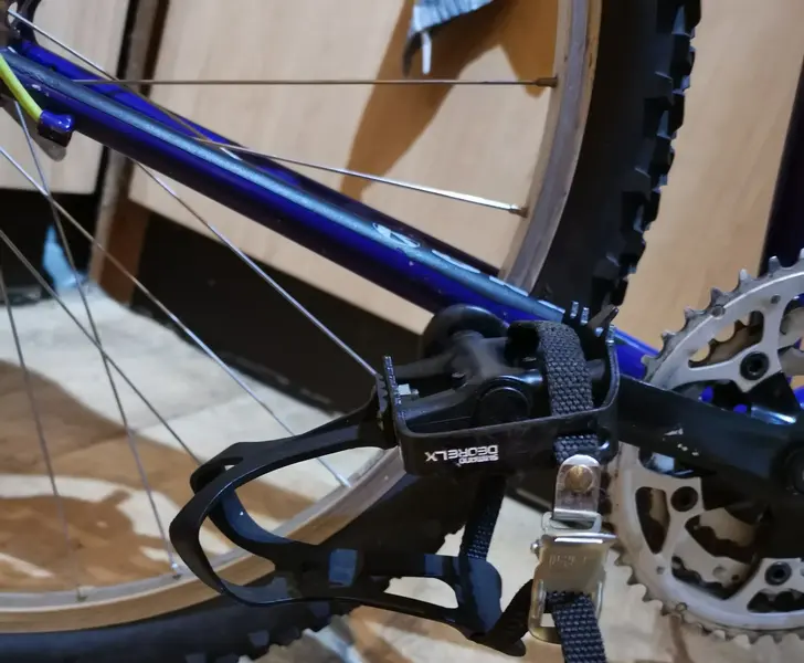

My 93 Firemountain had some Deore LX pedals so i nicked them and they go nicely with the other Deore LX parts.

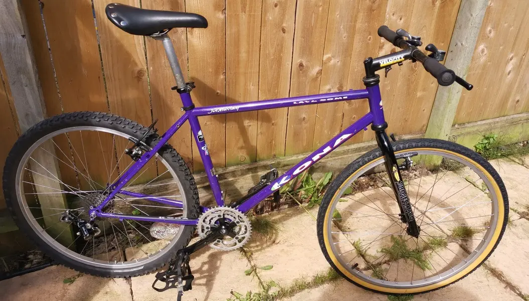

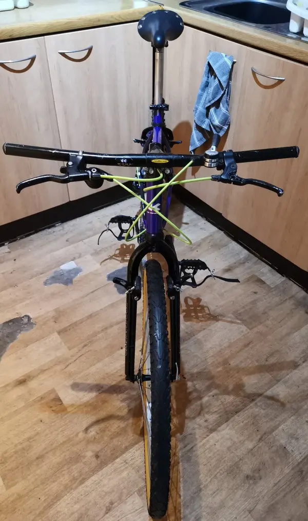

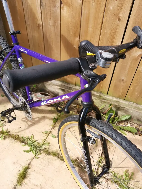

With being off work had some time to sort the brake levers and give them a few coats of paint to tidy them up and put my favourite grips on and that's the cockpit area sorted out.
Gave the crank arms a polish and they look better even done the rear mech lol

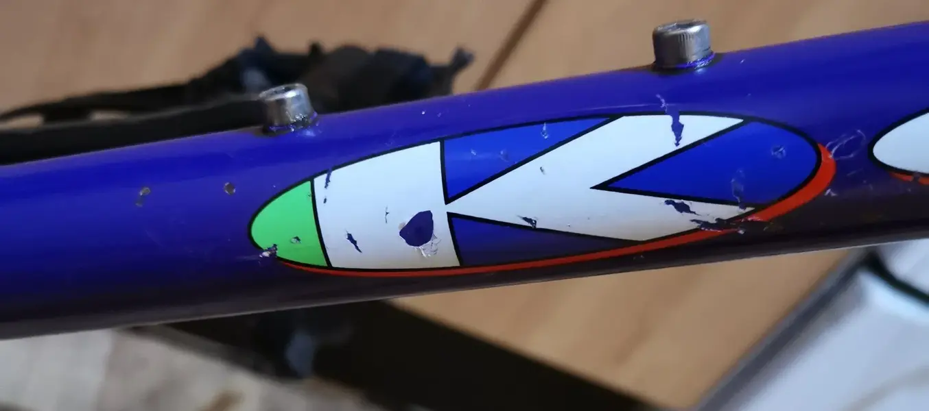

Looks good. Those thumbshifters look shiny aswell.
What paint do you use on the levers?
Yeah there nice and shiny, i've worked out a way to get them like that by using three different scotch cloths each one finer and then i use autosol. Takes a bit of time but always comes up nice and shiny. Paint, i've been using Halfords matt black then a couple of coats of Halfords clear lacquer.
