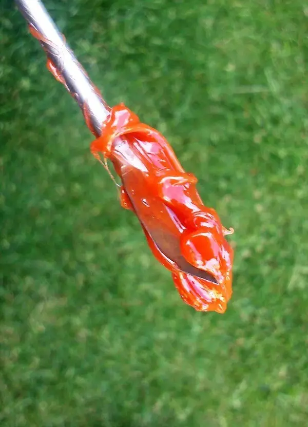

LeeDevelopment":1912msi5 said:
May I ask what you used to clean the melted elastomers off with please?
It was not that hard/sticky. Most of it behaved like candle wax and I used a blade with care. For the sticky parts I just used alcohol.

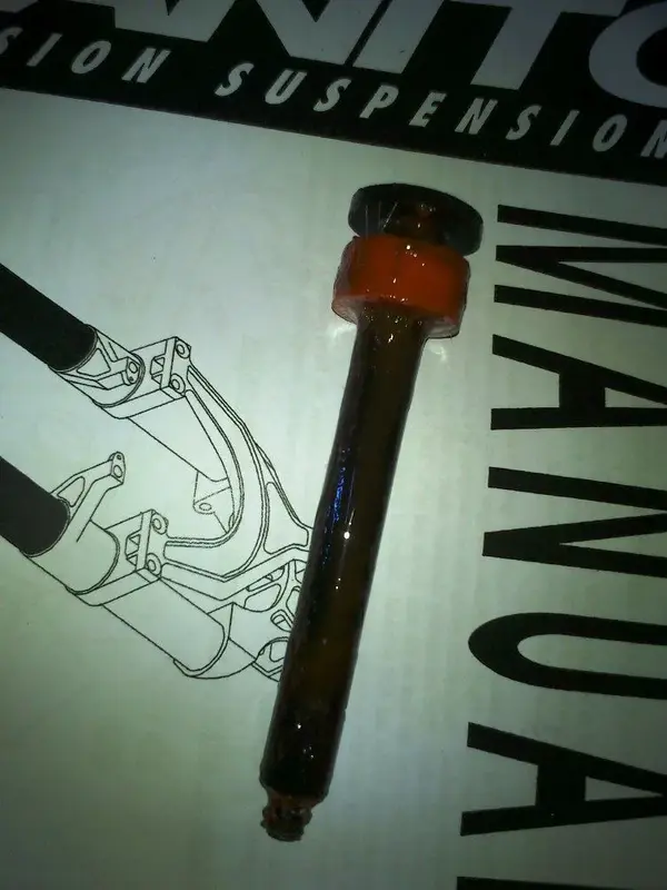

Davichin":3e2di9sp said:
You escaped a bullet there then Dave ^^^ the bottom out elastomer on mine had turned to the stickiest mess possible and was a nightmare to remove
Had to soak with white spirit and make myself a tool of a tooth brush on a piece of wooden doweling in order to agitate it off/out
ooh and you'll need to be wearing old clothes cuz if your looks like this then your in for an afternoon of fun :shock:
and yes thats a melted goop of elastomer and not red grease
