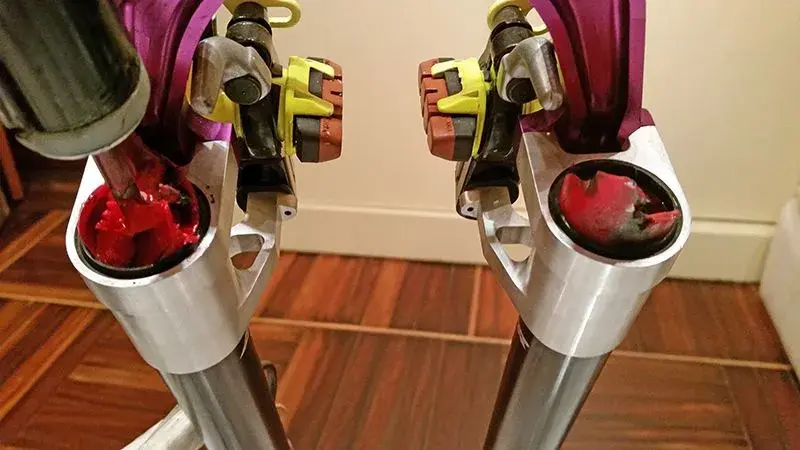

Today I arrived at Santander and started to work on the forks... Tasty:
New elastomers are in order as expected... I also need the long allen wrench to fully dismount the elastomer rod.
And I also had to use the force to take out the stuck headset adaptar that the previous owner fit:

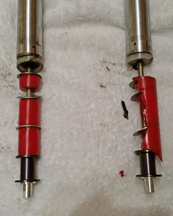

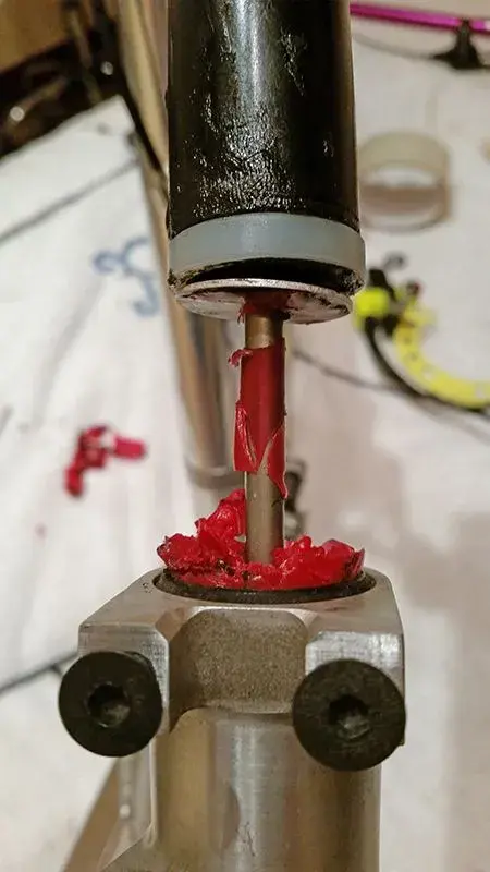

Allen wrench found, fork disassembled, rear susp also disassembled with totally mushy elastomers that took some work to clean...
Rear gum:
I already ordered both elastomer replacement kits (they seem expensive for what they are IMHO, specially compared to what retro forks go these days :roll: )...

Doing well with progress so far mate.
You are right about the replacement elastimers being expensive, I have home grown spring kits in a couple of my manitou forks, work well :-)
What size is that steerer adaptor?

Thank you! I thought about springs too but I preferred elastomers for this one :)
Steerer adapter is 28.6mm x 135mm straight gauge (so it came with an extra pipe section for the Manitou 1-1/4 stem to fit)
