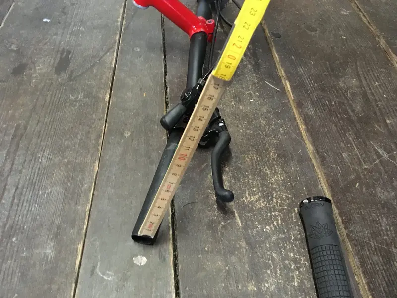

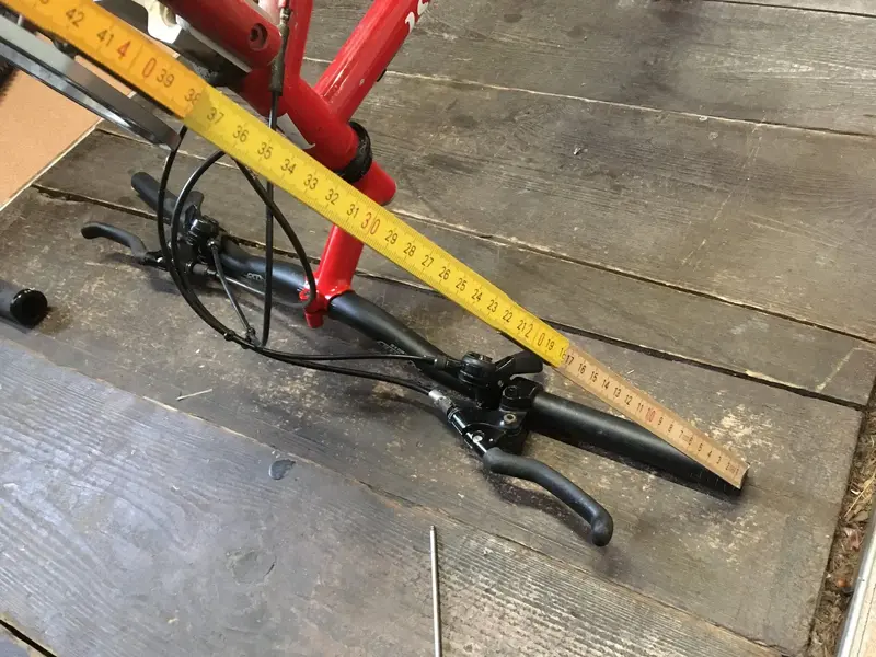

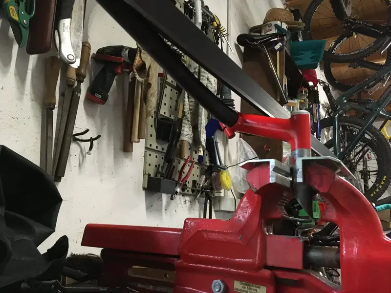

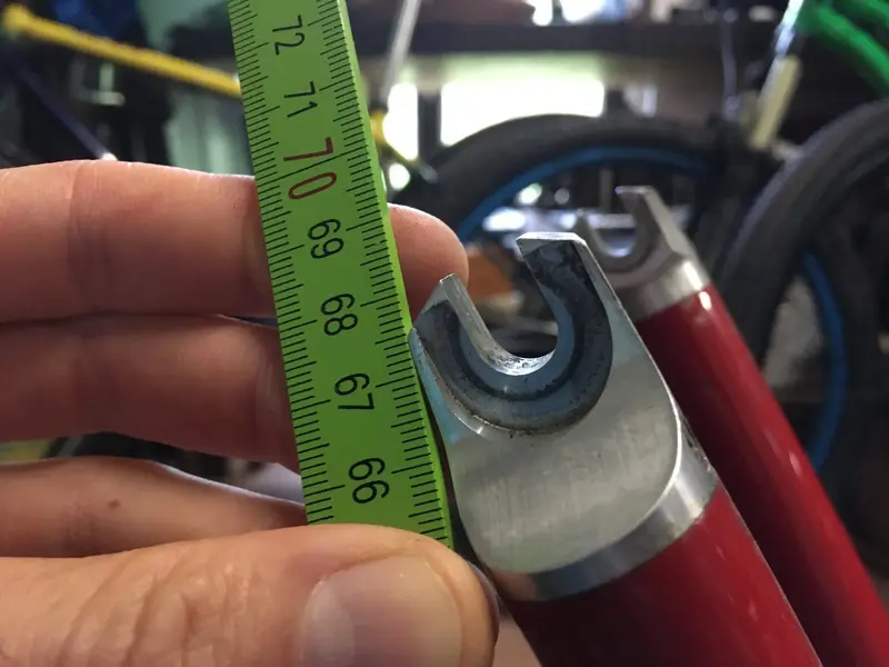

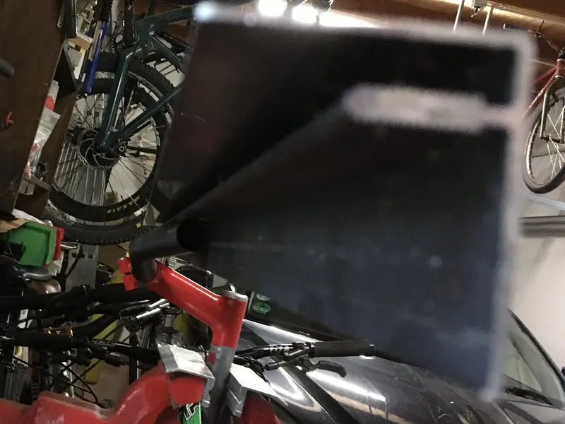

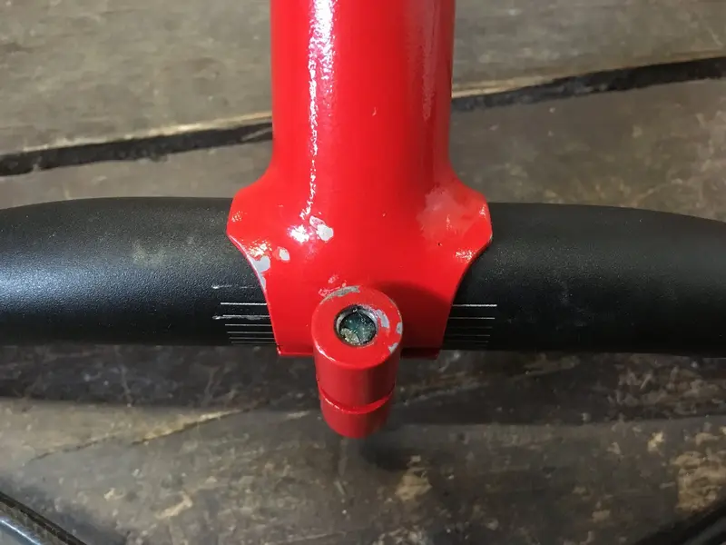

Well, I checked again. And came to the same conclusion.
I also checked my arms and they are way worse.
Right now I'm thinking of keeping it, so I can eventually sell it as the only misaligned Brodie bicycle part in history :)
It's not easy to see that it's misaligned from the side. For information's sake can we see a "gratuitous full frontal" shot? That way we could compare it to the fork crown and see how far out it really is.
Please excuse the paint damage on the underside of the stem…

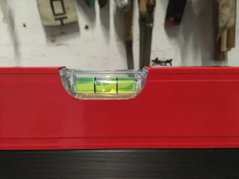

did you put the Wasserwaage (i dont know what its called in eng) on the clamp too? without the bar?
It‘s called spirit level.
I did not. I saw the misalignment by eye.
Putting it on the clamp itself would be less accurate. So no need to do so.
