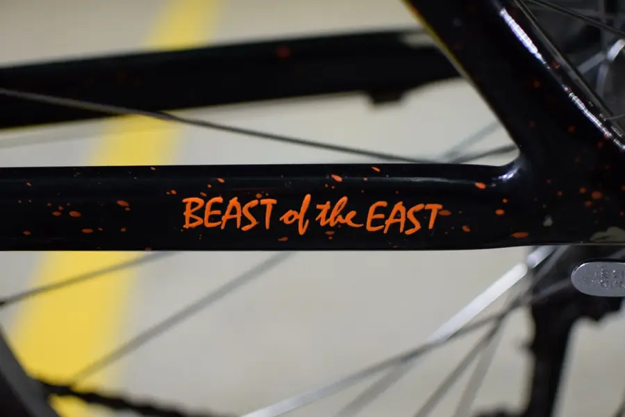

1991 Cannondale SM800 Beast Of The East
This weekend, I'm cleaning up the wheels!

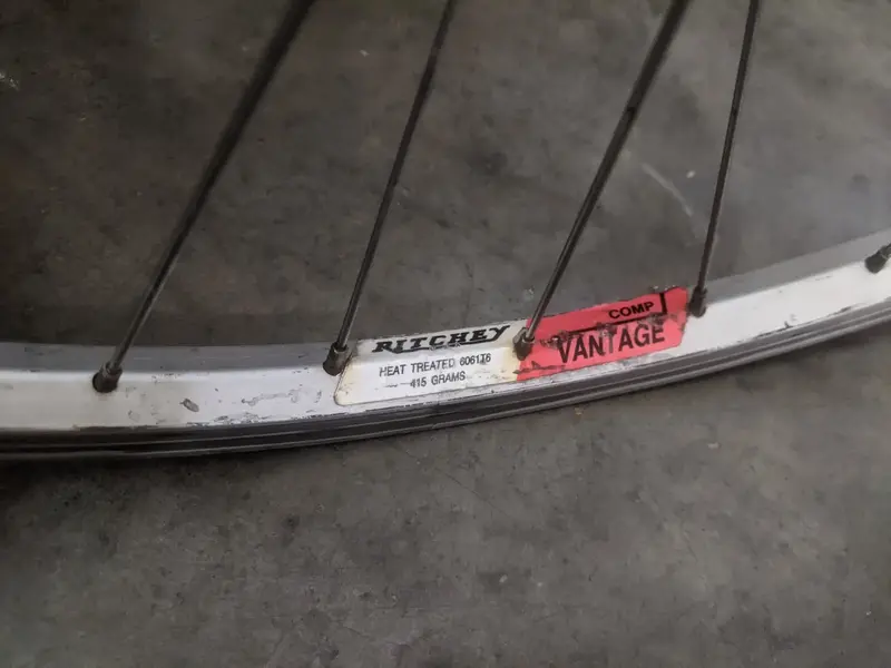

Before:

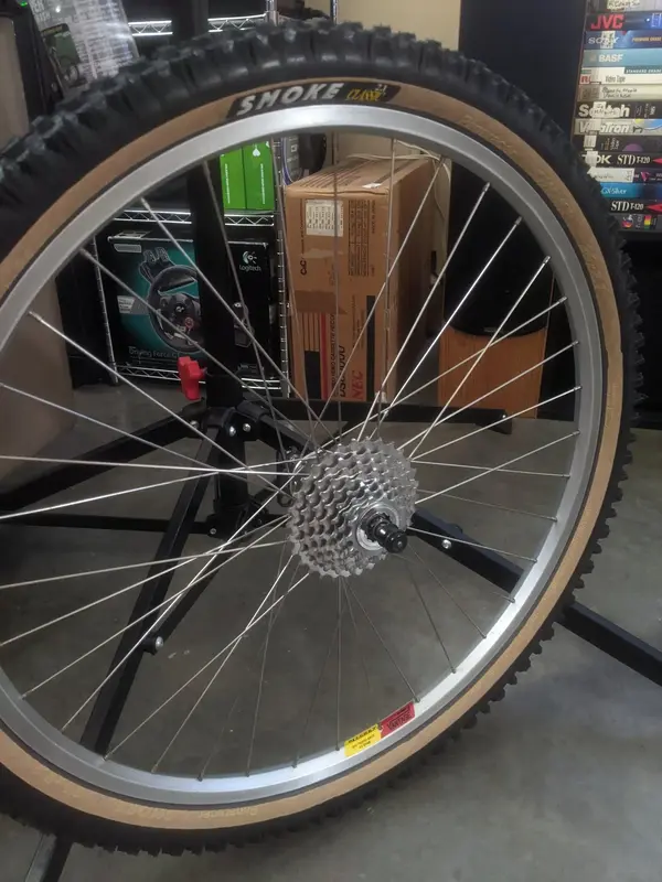

After:

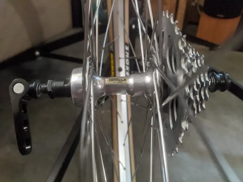

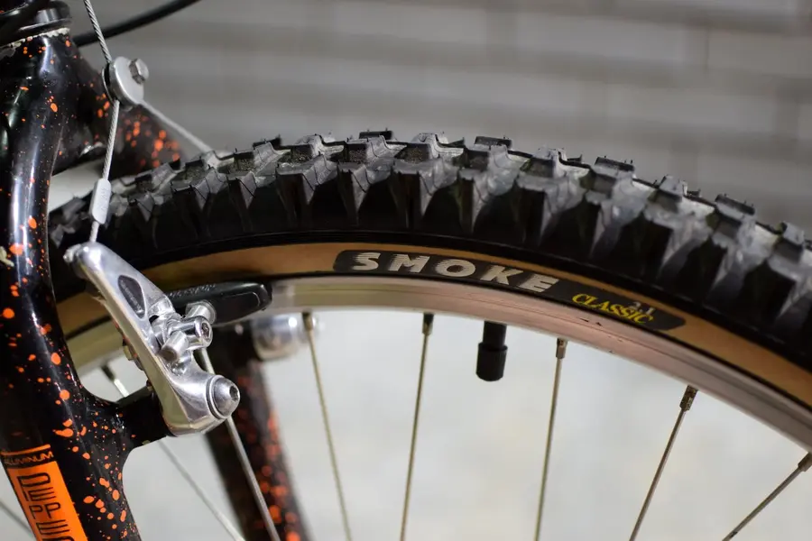

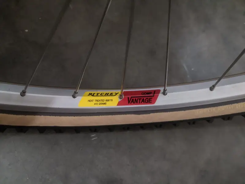

These are LX M550 laced to Ritchey Vantage Comp rims, and they came with steel Ringle Cam Twists in black. This is one of the reasons I was so excited to buy this bike. I knew the wheels were sweet, bomb proof, 36 spoke, yet still pretty light weight. I'm surprised at how well they clean up! I was also able to snag the last pair of decals that @oldefortran had for sale. Thanks Peer!

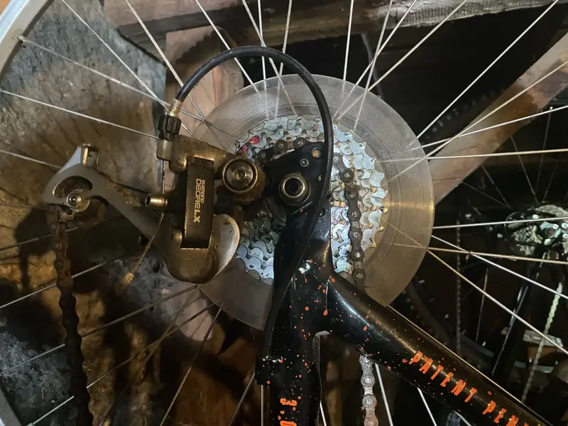

The rear wheel was already missing it's decal, so I had that one cleaned up most of the way already. I rebuilt the hub and freehub during the week, and today I finished off with a 0000 steel wool polish on the spokes, and some Scotch Brite 7447 on the braking surfaces. I'm also fitting a pair of tan wall Smoke Classics, per the original catalog specs.

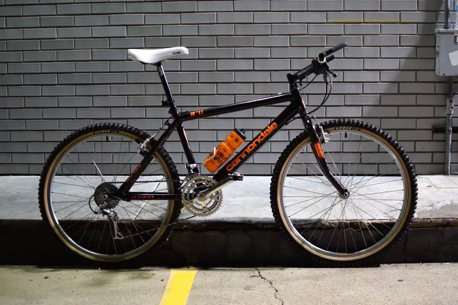

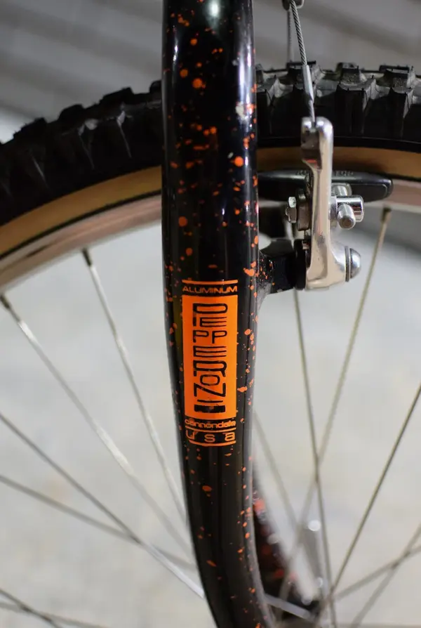

Frame: 1991 Cannondale SM800 "Beast of the East" in Black w/ Hunter Orange splatter
Fork: Cannondale Pepperoni
Headset: Tange 1" in black

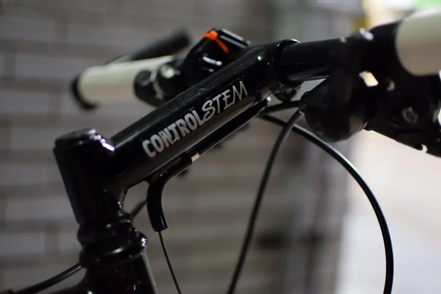

Stem: ControlStem with noodle in black
Handlebar: Cannondale Competition TaperLite
Grips: ESI Chunky in white
Bar Ends: ControlStix in black
Brakes: Shimano Deore DX BR-M650
Brake Pads: Kool Stop Eagle II
Brake Levers/Shifters: Shimano Deore DX MT-071
Front Derailleur: Shimano Deore LX FD-M550
Rear Derailleur: Shimano Deore LX RD-M550
Cassette: Shimano Deore LX 13-30t
Chain: Sachs Sedis
Cranks: Shimano Deore XT FC-M730
Chainrings: Shimano SG-X 46/36/24
Bottom Bracket: Shimano
Pedals: Shimano Deore DX PD-MT60
Hub Skewers: Shimano LX
Rims: Ritchey Vantage Compe
Hubs: Shimano LX HB-M550 36h
Tires: Panaracer Smoke 2.1 in tanwall
Saddle: Selle Italia Turbo in white
Seatpost: ControlTech 27.2 in black
Bottle Cage: Cannondale Aluminum in white

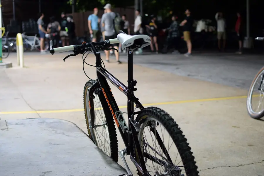

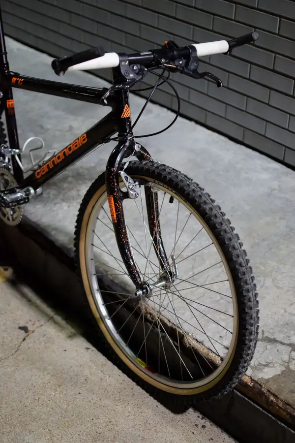

I finally put this bike back together. Per usual, project creep and budget constrains reduced the scope of the build. However, I know I'm going to be selling this bike soon, so I didn't feel bad about skipping the frame restoration. I was tired of moving around an incomplete frame and a box of shiny parts. I am so glad I get to ride this bike now! It's quite responsive, and has an interesting turning center of balance. I can tell this would be great downhill. It is also very light, probably the lightest bike I currently own.
