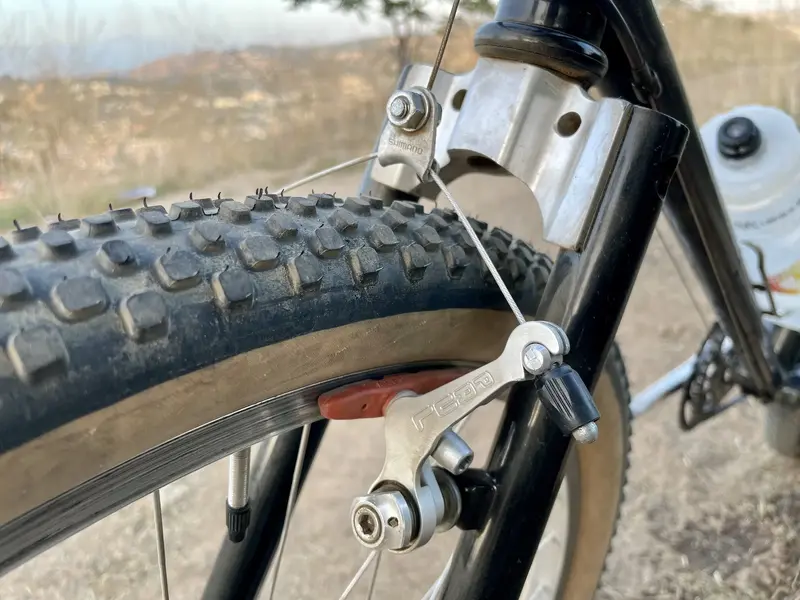

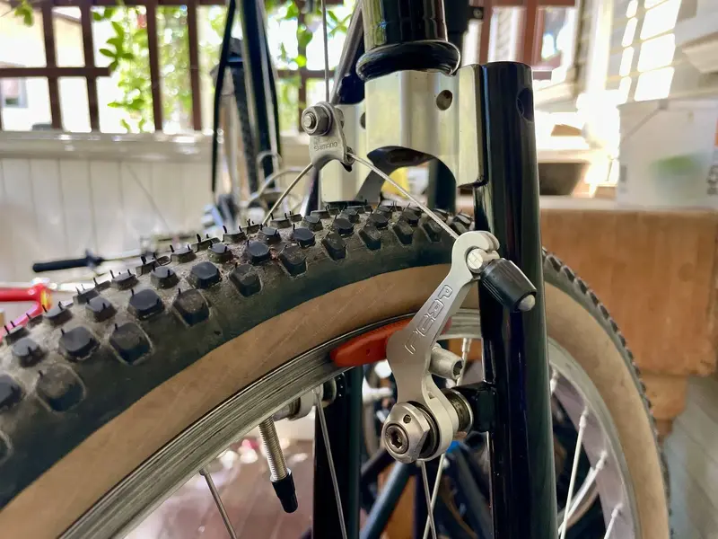

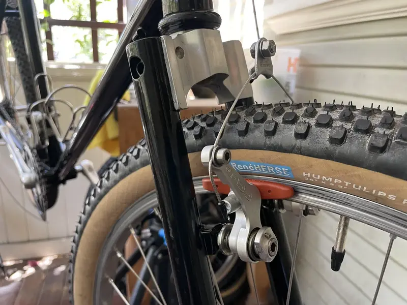

The front brake.
There was nothing overly wrong with the Dia-Compe it came with. That said, I did want to source something a little more special for the front to go along with the few other upgrades I planned to make.
One option is on its way shortly from Italy, so in the meantime I decided to try out a Paul Touring Cantilever I had in the parts box.
I bought this for a retromod build I'm currently working on with a friend of mine over on the East Coast, as it's a nice way to include a modern component on an older bike without having something that looks totally out of place.
(V-brakes leave me feeling cold and dead inside. And don't even get me started on the levers you have to pair them with!)
Anyway, I figured this was a good opportunity to test out the brake while I waited for my preferred solution to arrive.

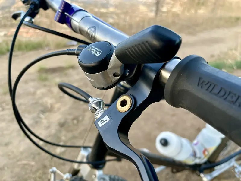

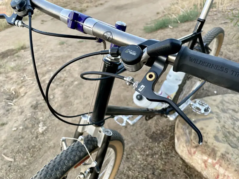

I decided at the same time to switch out the Ritchey Logic's for the Paul Love Levers I had on the Marin (those were in turn replaced with some Suntour XC Pro's, to go along with the rest of the group that's on the Team Issue). I like the Ritchey levers the bike came with a lot, and right now plan to put them back on when the new/old brake arrives, but I figured if a Paul brake was going on I may was well try it out with a Paul lever!
(I may try to source some of the Ritchey Logic levers in better condition, or in the silver and black style. So if anyone has any, please do let me know. I know this particular lever has a fair few fans on here!)
Anyway, the front brake:
I know the sight of a random modern component might freak some of you out (especially paired with those disgusting modern tires ;)), but bear with me a second...
A few notes on my choices:

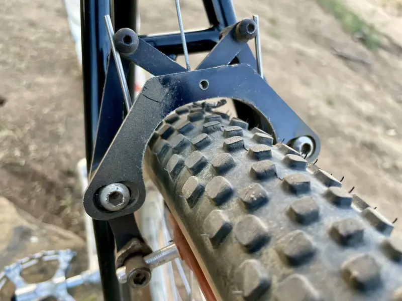

- I'm actually surprised I don't see the Paul Touring Canti on more builds posted on these forums. They really suit a retro bike, for obvious reasons. Especially if you're not bothered about being fully period correct. I know most of us are, but at least they're Paul, so from a company that was active back during the golden era (or part thereof) we all revere so highly! They're a doddle to set up, really well designed, with a lovely profile, and, after a fair few rides now, I can confirm they work exceptional well.
Also, don't try to tell me they don't look particularly lovely set against that amazing Gatorblade fork crown!

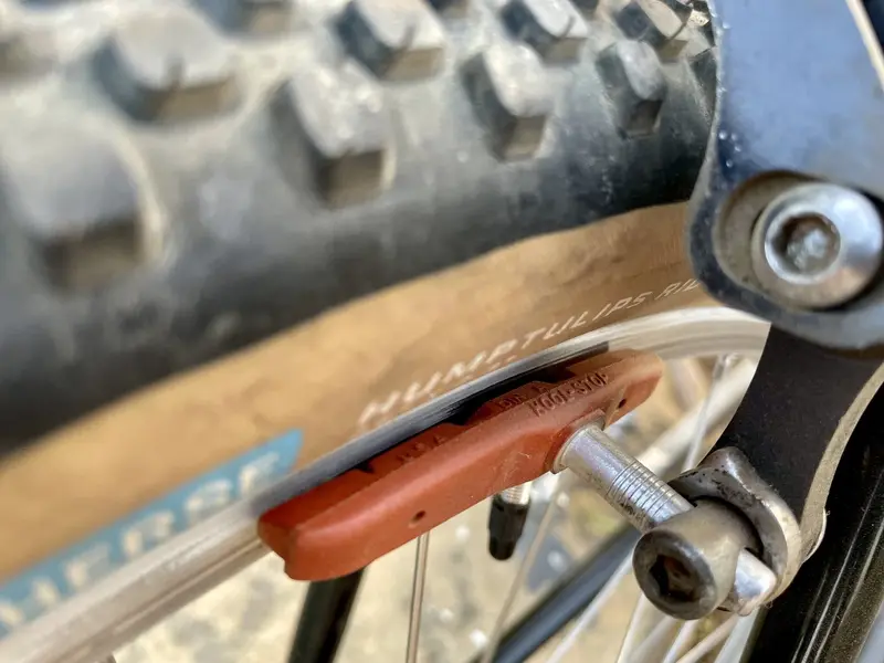

- This is my first time using the KoolStop Thinlines. They come highly recommended by a few people, not least Mike Varley at Black Mountain Cycles, and I like them so much I purchased the threadless version for the rear brake, too. Of course, this means having to set the pads pretty far along the post to get them close-enough to the rim, but I agree with Mike on the fact they reduce that squishy feeling older, fatter style pads tend to give you. Even if it does mean replacing them more frequently. I can see myself using these frequently on other bikes/builds.
- That little "H" branded barrel adjuster. That's a Hunter Cycles Nug. A silly expense, maybe. But I really like Rick Hunter's whole deal (I've spoken on him elsewhere) and probably won't ever be able to find or afford anything else he's made! These are a great little addition to these brakes, as they allow you to finesse pad placement and straddle tension just-so. I can't imagine they wouldn't offer the same benefits to other types of cantilever, too. It might not be strictly necessary, but for those of you that enjoy dialing in your cantilevers exactly right, these come highly, if expensively, recommended. You use a cutdown road brake cable for the straddle, FYI.
I think that's just about all the initial changes covered. So I'll share a few photos of how they look all together on the bike in my next post. Before discussing the plans I have for it in the longer-term.

One minor snipe though is the Paul Cantilever; nothing wrong w/ being new but that´s a rear brake. I have never used those Paul cantis but i know the rear is supposd to be less powerfull than the front.

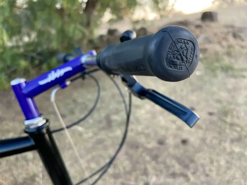

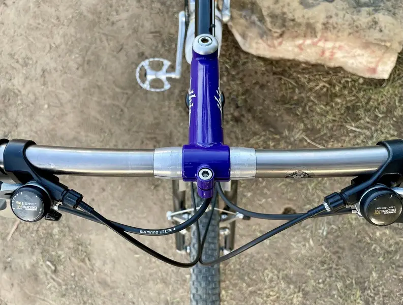

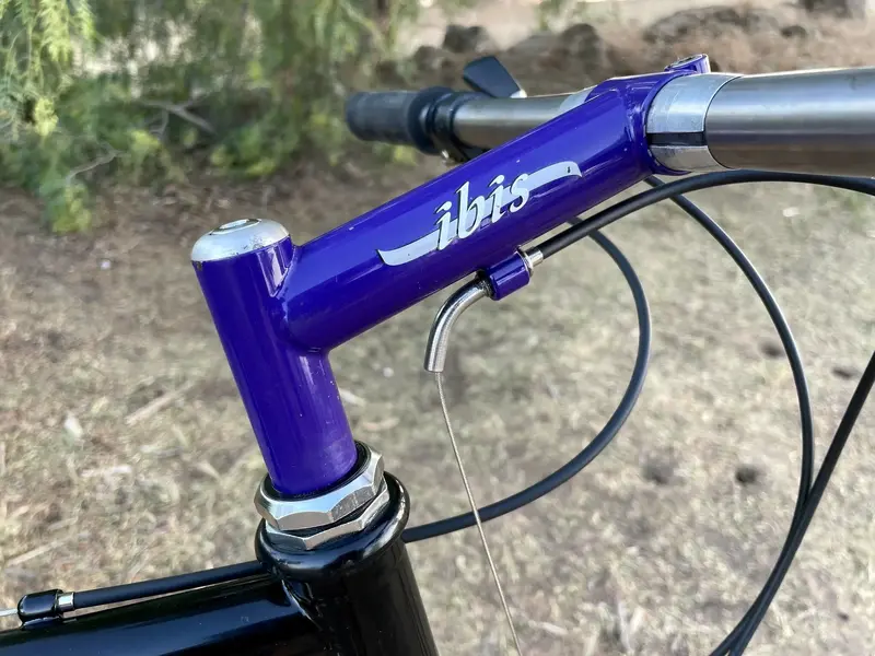

1. Stem
When I emailed Paul to confirm the date of the bike, I also asked whether he would consider building a custom stem for me. Well, his reply was that he was too busy with his YouTube channel these days! Luckily, however, a few weeks later, ohe emailed out of the blue to say he'd reconsidered. I suppose he's now working on one last batch of ICR stems, as I know a couple others here have recently put their orders in for one. You can all thank me for lighting, or at least stoking, that particular fire! ;)

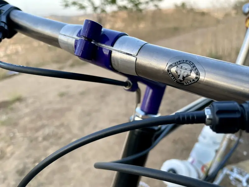

I've been trying to figure out the exact length and rise I'd like, which has me concocting all sorts of silliness at home when I'm bored, to try and get that right:
Anyway, having been out on the bike a lot, I've pretty much settled on what I'd like, and I'm excited to have Paul make something really special as a finishing touch.
(Sidenote: I really love that Ibis stem, and will be sad to see it go! Oh well, time to find something new in 1 1/8" so I can base a whole new build around it!)

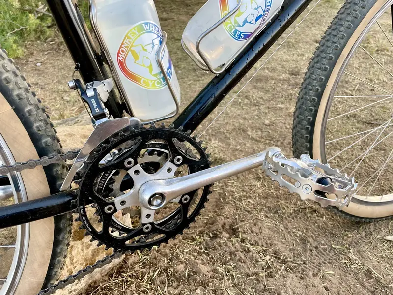

5. Chainset
I definitely plan to replace the chainrings to match the rest of the drivetrain. Ideally for an XT SG set in silver (if anyone has anything suitable, please let me know), although I could also keep the black theme going. I actually like the Topline cranks to ride, but am still on the fence about keeping those due to all the horror stories you hear about them cracking. I also have a nicely beat-up set of Cooks here (silver, with black spider), that could do with a polish-up and home! Which means sourcing a new bottom bracket potentially, too.

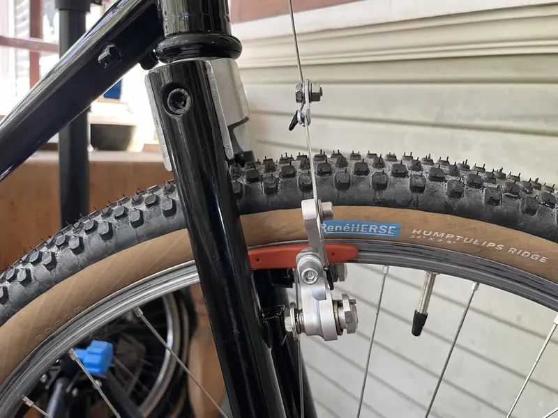

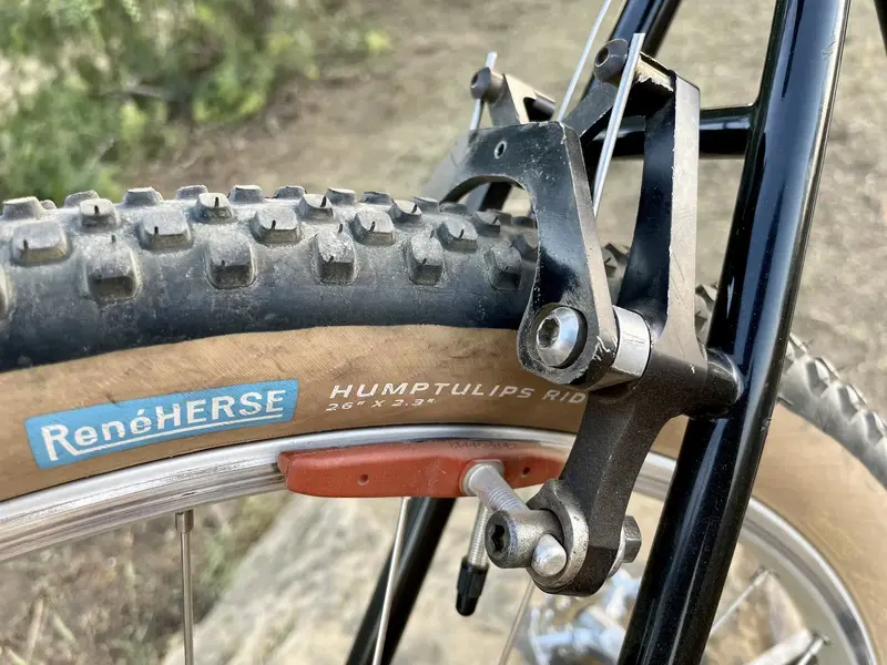

Oh, and that front brake...
Really? I wasn't aware this model came in front and rear specific versions?
The Paul site doesn't say anything to indicate that:

The front is called Neo Retro and looks like Mafacs (althought there must be a mafac just like the rear) we know. Mind you, i have not used those Pauls and i am talking out of press release info.
