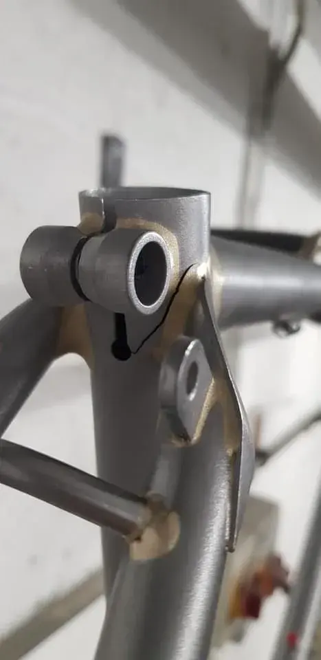

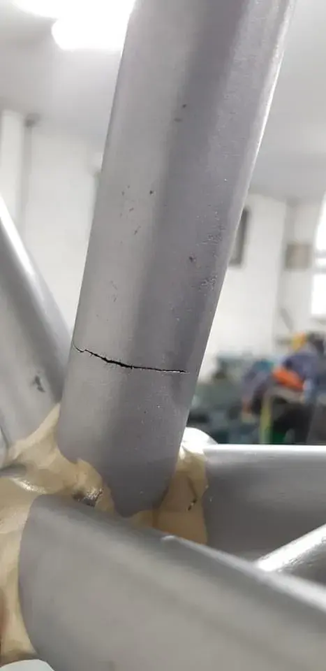

Hi, sorry if you've already told us and I missed it but what's happening to the crack above the bb? I have an almost identical looking crack in a PARIS frame...

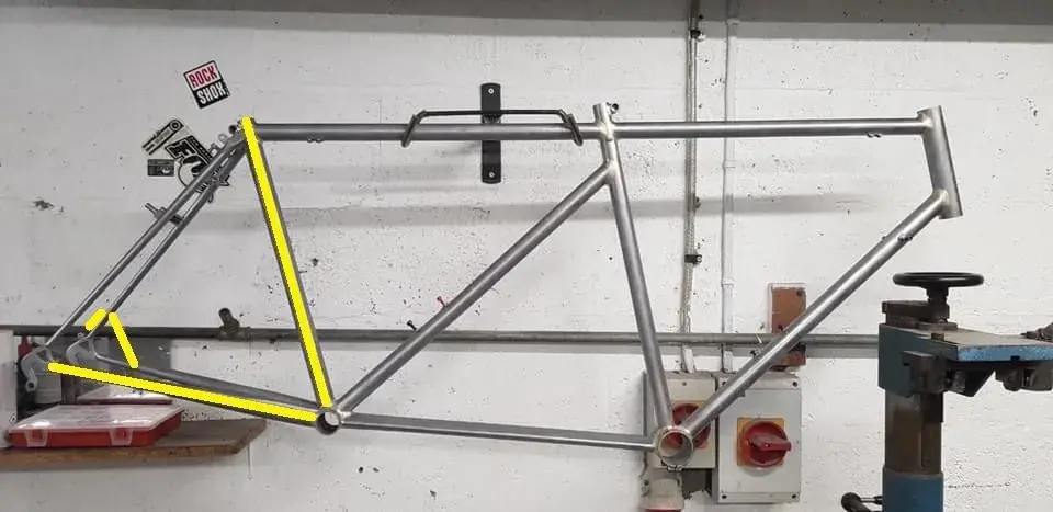

It's all in the thread above (somewhere) but to re-cap;
All the redundant fixings have been removed (pump pegs, drag/drum brake cable hangers etc)
Driven in and stuck front seat post has been dissolved using caustic soda
Rear seat cracked seat tube to be completely replaced
Damaged drive side/chain stay to be completely replaced
Brace & mount for disc drag brake to be fitted
