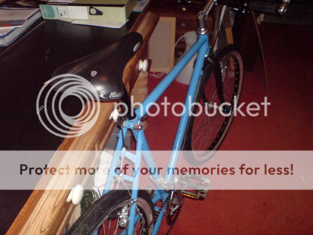

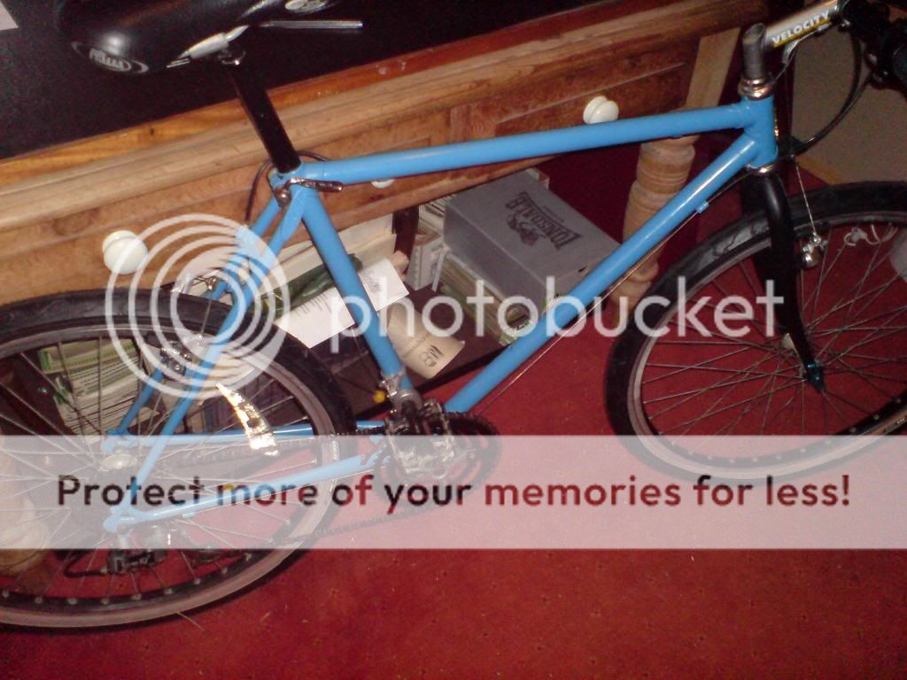

1989 Raleigh Montage
Those Alesa rims with Sachs-Haillard hubs are superb by the way - so rigid rims for the year of the technology - the rims are up on par for what I think compared to Mavic and Ritchey's - fantastico :)
Here's a few dodgy phone-camera pics..
More to come...
Hi raleighmontage,
Looking great, love the black forks with the blue, the blue you haved used is more of a baby blue colour - sweet as - I like :-)
How does the old cant brakes do - okies ?
I still have the orig set of cants and was thinking of putting them back on ...
Have a good 1st ride on that thing :-)
Cheers,
Stephan.
First ride was a moderate success with about 20 miles covered...
Absolutely flies on those tyres, gearing needs some adjustment but i'm damn pleased to get it back.
Riding position is even better than normal with the velocity stem too:)
Paint finish is dissappointing as it's unlacquered, i'm going to touch it in and lacquer it up with some Plasti-coat.
Cantis are doing a good job of slowing the old beast down but I don't think those pads are up to much. I'll give them a while to wear in but I think it needs softer ones.
Going to take it for another blast tomorrow morning, bright and early. Cant get enough of it...
